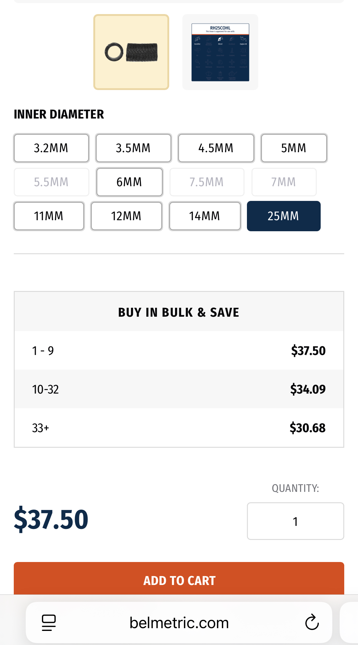

What size are you looking at specifically
Here’s 25mm
Might also check other places - Aircraft Spruce, Summit, etc.
Large ID line is not cheap regardless of where you source it. Attached Image.

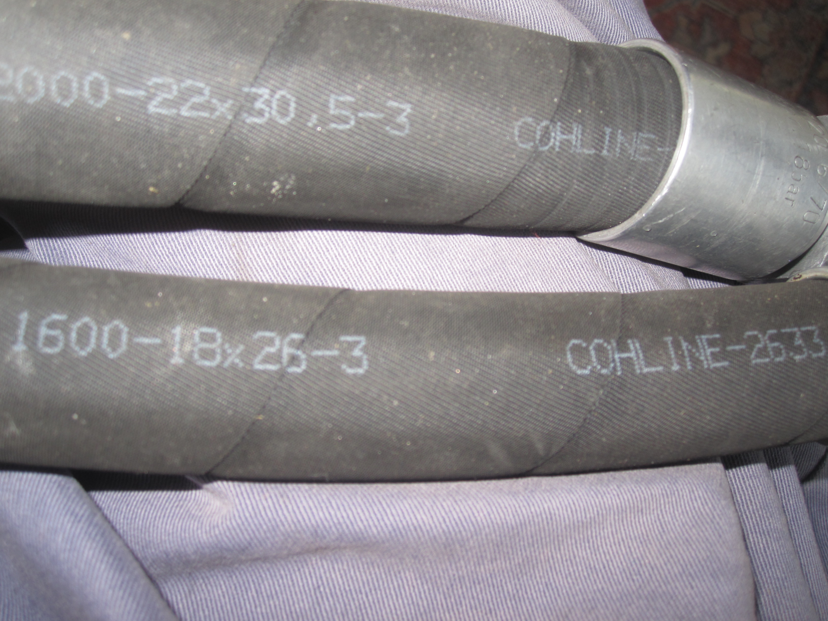

I think you want the series 2633 it's slightly cheaper too:
https://belmetric.com/cohline-series-2633-w...u=RH25HPWRAPPED
It in Tyngsboro right off route 3 - order ahead for will-call pick up they hate drop ins or have it shipped

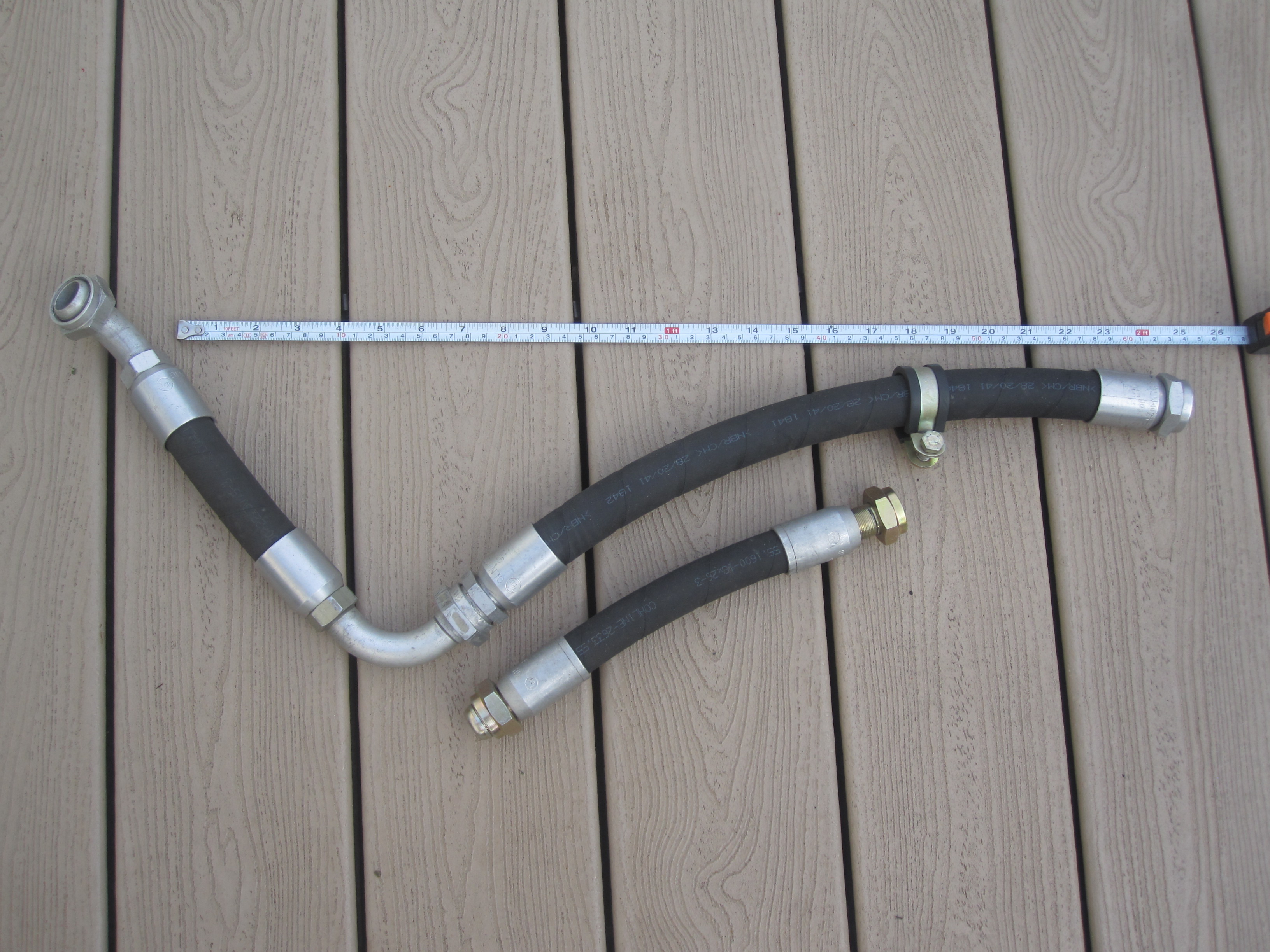

If you are replacing the hose on original fittings you need 2' for the two between
tank and the cooler.
The one in front of the engine (smaller diameter) is less than one foot.
You have all the fittings ?
Lucky dog, keep it original. (IMG:style_emoticons/default/smile.gif)

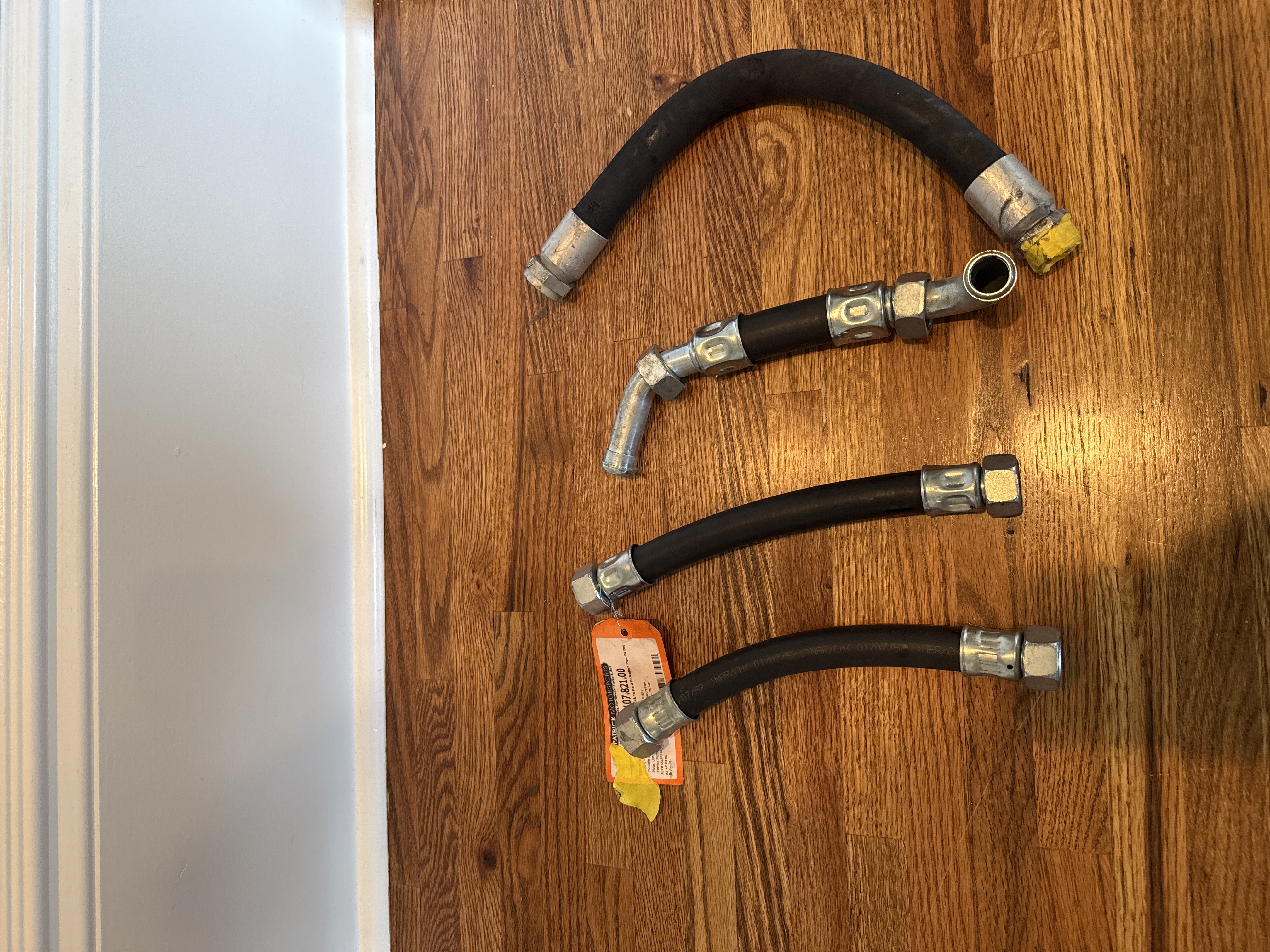

Here are my hoses
I was/am most concerned with the two top ones

Little bit of confusion here. Those are 'breather lines', not 'oil lines'.
There is little/no pressure in them. Not really sure why they are cloth braided on the outside, doesn't need the strength. Pretty much any kind of oil resistant hose will work, although I understand the desire for originality. Keep looking, yea $50+ per foot is ludicrous unless you are going for concours. Your old ones don't look that bad

Had you been more exact and said breather hose, we would have been on the right track...nevermind, Stoddard have 24mm breather/vent braided hose so check them out .
