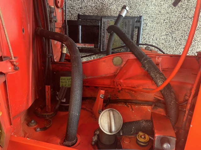

ctc911ctc
Here are my hoses
I was/am most concerned with the two top ones
Click to view attachment
AFAIK Pegasus has steel braided hose and fittings
fixer34
Little bit of confusion here. Those are 'breather lines', not 'oil lines'.
There is little/no pressure in them. Not really sure why they are cloth braided on the outside, doesn't need the strength. Pretty much any kind of oil resistant hose will work, although I understand the desire for originality. Keep looking, yea $50+ per foot is ludicrous unless you are going for concours. Your old ones don't look that bad
QUOTE(fixer34 @ Jul 9 2025, 08:27 PM) *
agree.gif we get those lines for something like $5 a foot from SSF. They are cloth braided but not under pressure.
I just checked. Continental cloth braided hose. part # N2037115, 19mm, $15 a meter + ship (whatever shipping cost me). Let me know if that works for you and I'll order it up.

Had you been more exact and said breather hose, we would have been on the right track...nevermind, Stoddard have 24mm breather/vent braided hose so check them out .
