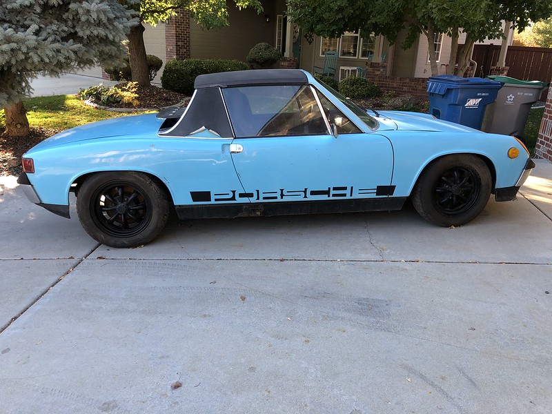

74:
(IMG:http://www.914world.com/bbs2/uploads_offsite/live.staticflickr.com-22225-1555094918.1.jpg)

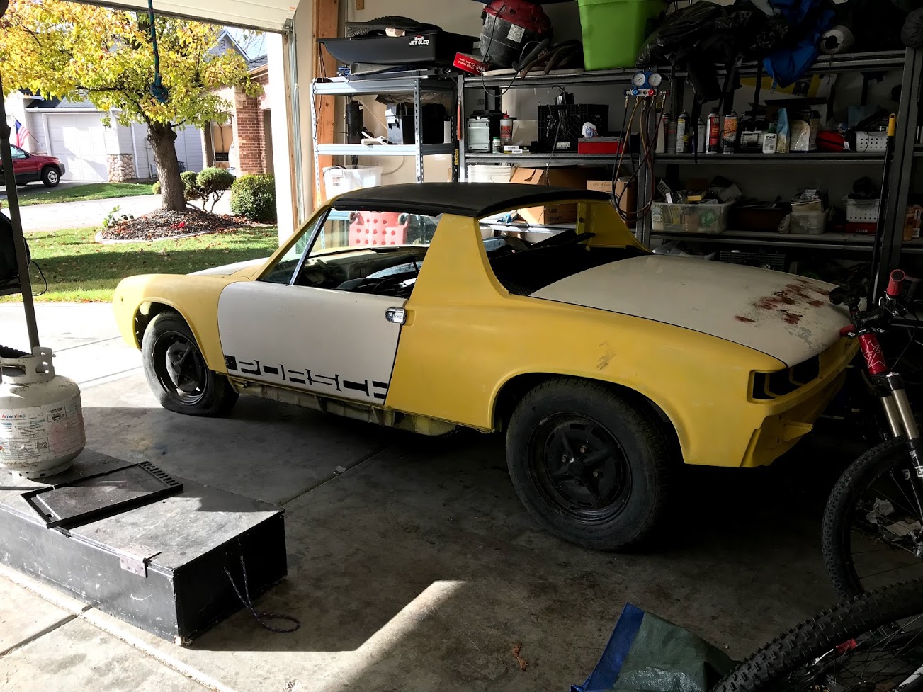

73:
(IMG:http://www.914world.com/bbs2/uploads_offsite/live.staticflickr.com-22225-1554504271.1.jpg)
The PO had stuffed a Pontiac v6 in the 73. He totally scabbed the conversion together - especially the cooling. No radiator fan, square tubing for coolant lines - its ugly. Not surprising, he cooked the motor. Then let it sit outside and rust. The interior is in excellent shape, but the rockers, longs, hell hole, and door jams are pretty bad.
The 74 had been stripped and "prepped" for paint. His reality of "prepped" boarders on insanity. He was planning a LS conversion but didn't get any further than stripping it down and spraying it with john deere yellow (IMG:style_emoticons/default/barf.gif)
It basically came home in boxes. But, I picked them both up for $1500, then sold the 1.7 and trans from the 74 for $1K. Not a bad deal at all.

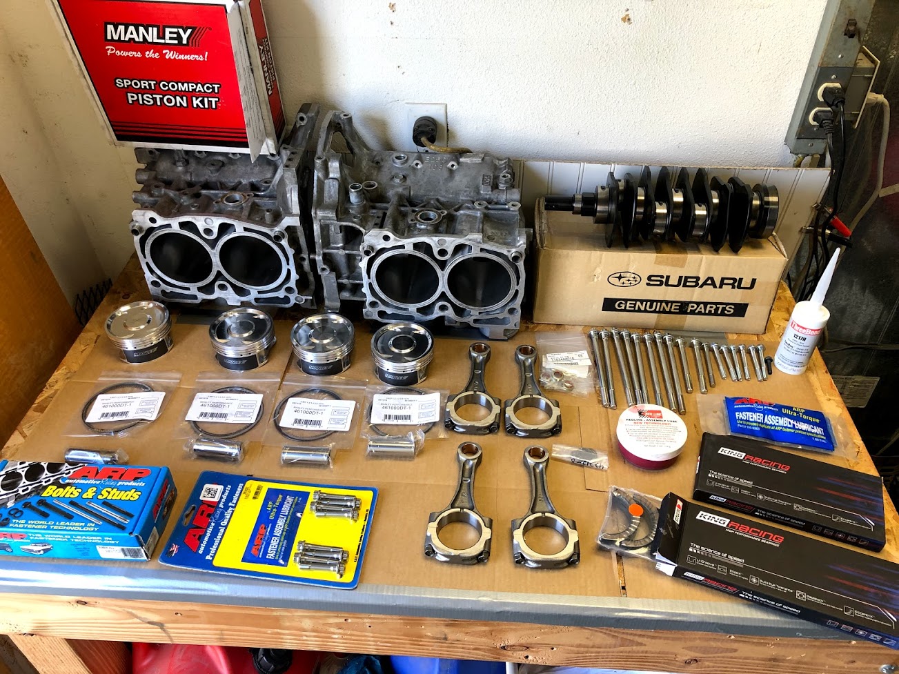

Now for a motor porn teaser - This is what I put together last weekend (IMG:style_emoticons/default/happy11.gif)
(IMG:http://www.914world.com/bbs2/uploads_offsite/lh3.googleusercontent.com-22225-1554500840.3.jpg)

Motor:
2008 EJ257 STI block bored +.5mm
Timesert head bolt anchors
2008 OEM STI crank with nitride coating
OEM STI rods with ARP rod bolts
King racing main and rod bearings
Manley forged and skirted pistons
ARP head studs
Heads - 2004 OEM with single AVCS
- new OEM valves and guides
Stock exhaust and uppipe
Turbo - Cobb 20g
ECU - 2004 STI stock with Cobb AP tuner

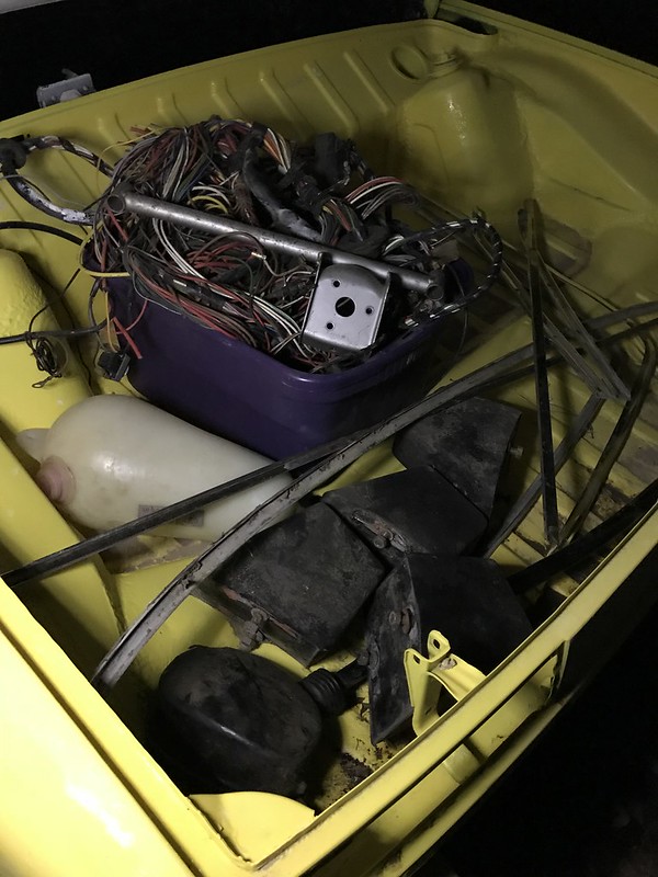

More of the '74:
(IMG:http://www.914world.com/bbs2/uploads_offsite/lh3.googleusercontent.com-22225-1554501446.1.jpg)
(IMG:http://www.914world.com/bbs2/uploads_offsite/lh3.googleusercontent.com-22225-1554501446.2.jpg)
(IMG:http://www.914world.com/bbs2/uploads_offsite/live.staticflickr.com-22225-1554504649.1.jpg)
(IMG:http://www.914world.com/bbs2/uploads_offsite/live.staticflickr.com-22225-1554504650.2.jpg)
(IMG:http://www.914world.com/bbs2/uploads_offsite/live.staticflickr.com-22225-1554504650.3.jpg)
(IMG:http://www.914world.com/bbs2/uploads_offsite/live.staticflickr.com-22225-1554504650.4.jpg)

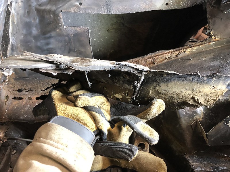

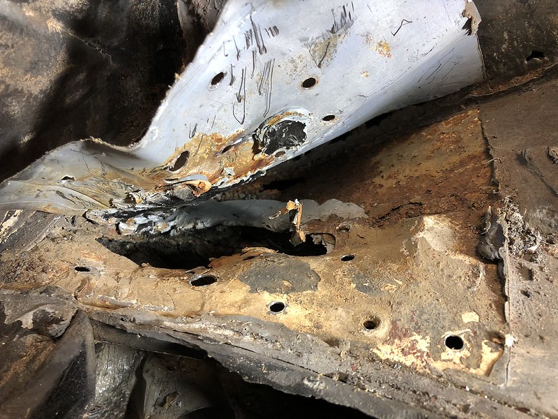

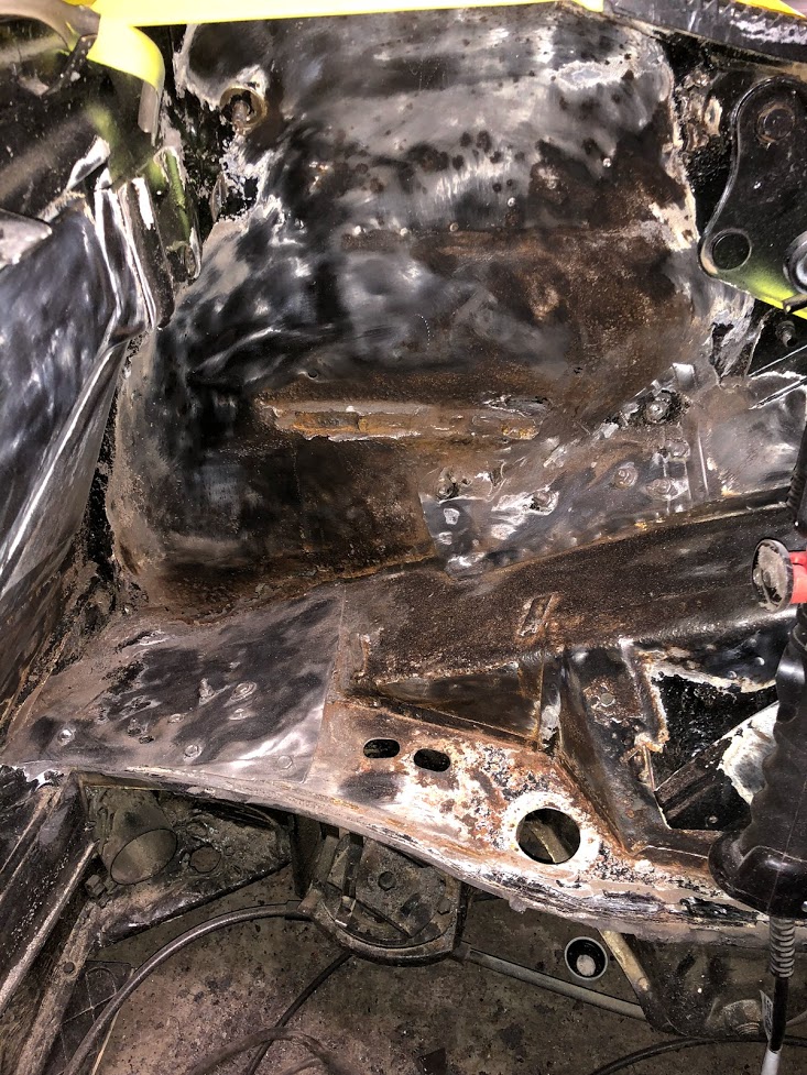

I wanted to see what the PO's "fix" to the hell hole looked like. So I grabbed my wire wheel and started cleaning. Before long, bolt heads appeared - what the....
(IMG:http://www.914world.com/bbs2/uploads_offsite/lh3.googleusercontent.com-22225-1554501734.1.jpg)
I should also mention that this was under about a 1/2 inch of what looked like roofing tar. (IMG:style_emoticons/default/WTF.gif)

Those FI parts in the front trunk may have some value, just saying we have a buy/sell forum.

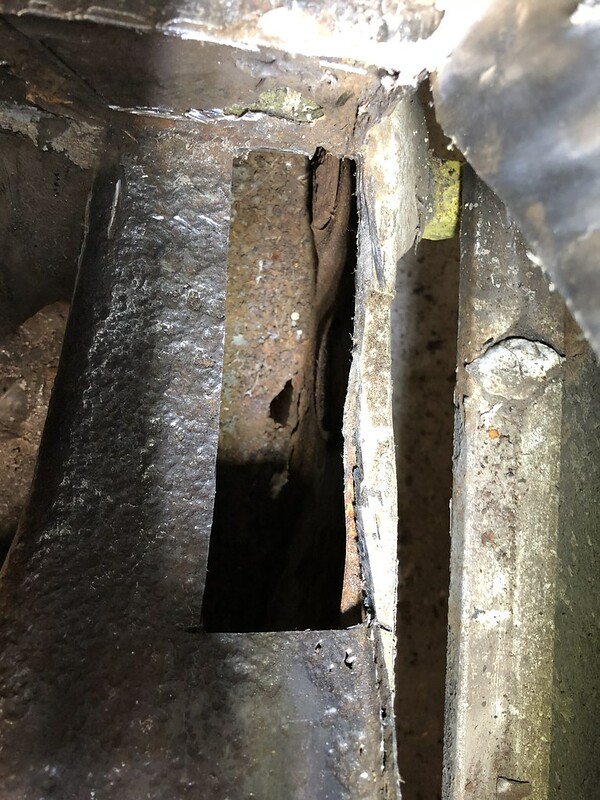

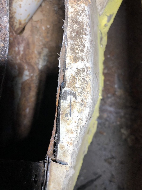

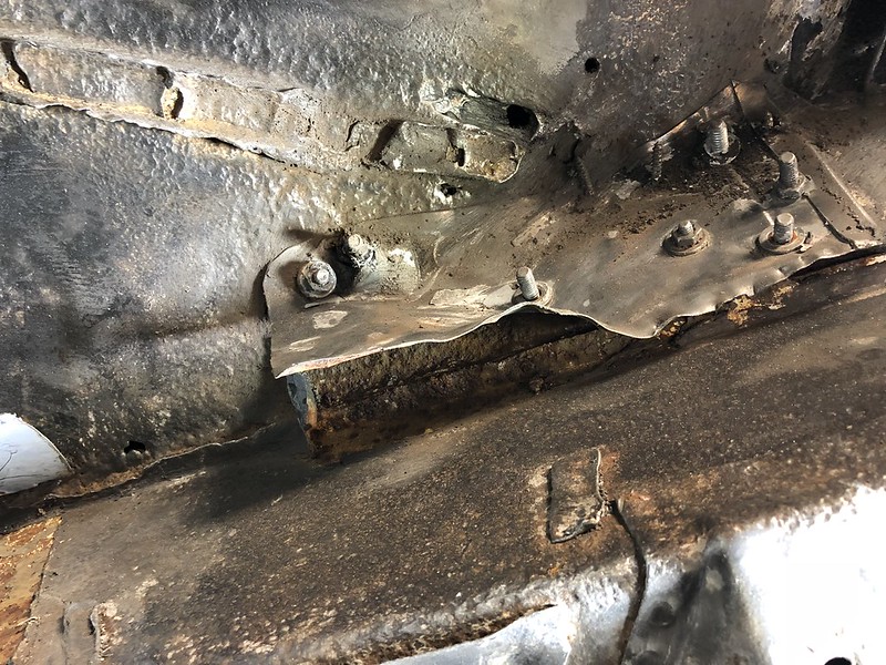

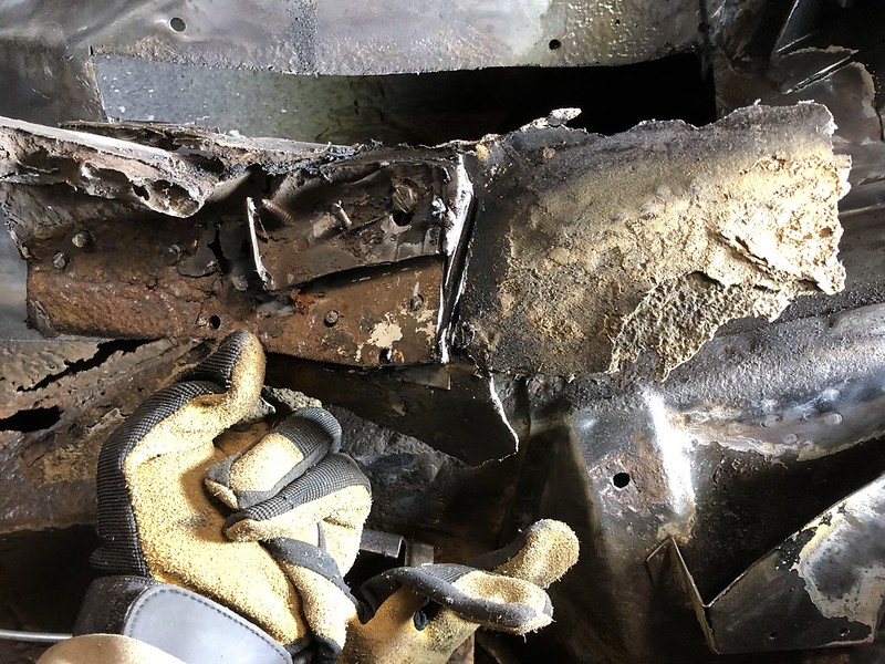

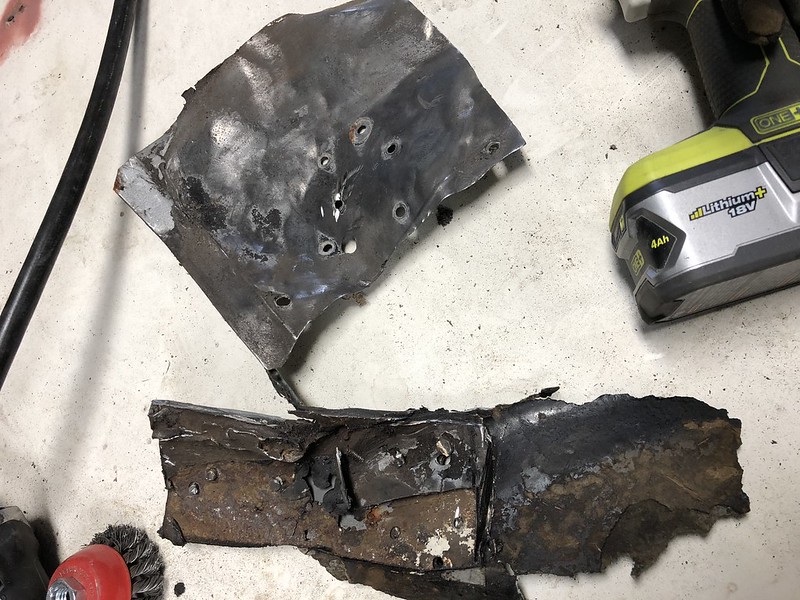

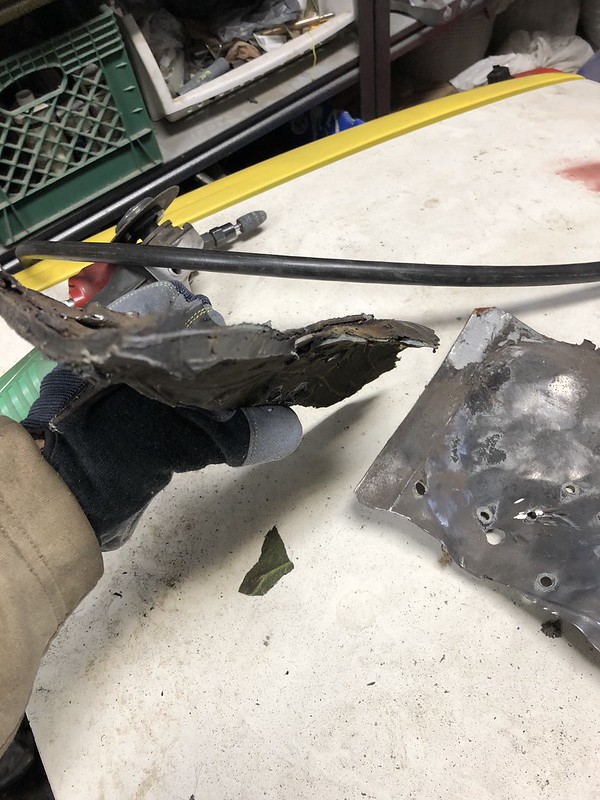

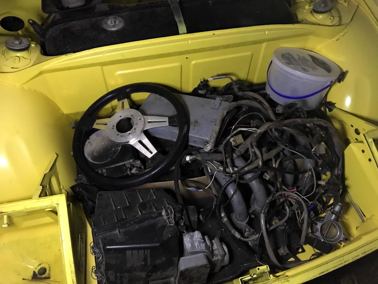

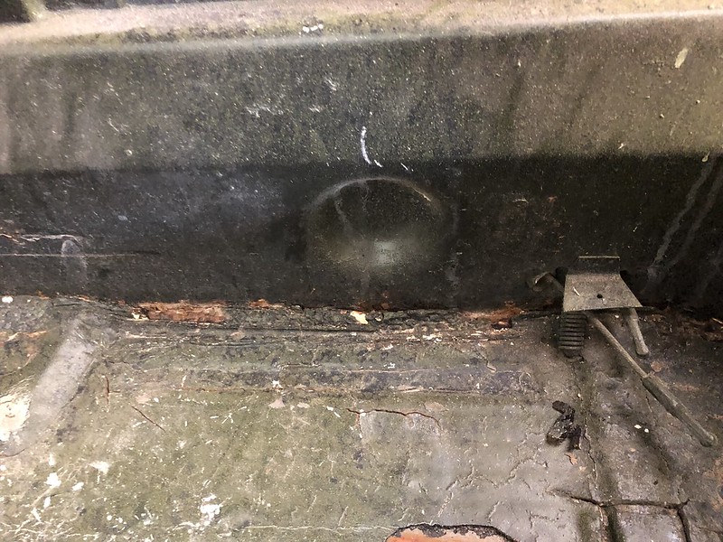

All right, lets kick this off properly. No 914 rustoration would be complete without a trip down to hell (hole). The PO waxed poetic on all of his extensive work to fix the hell hole. He said that he had "installed" patch panels and sealed them with rust inhibiting treatment. I think he mentioned POR15.
Once I got the car in my garage, I started cleaning things up and sorting through the parts, I noticed there was something a little off with the "patched" areas. After a little wire wheel action, I see this:
(IMG:http://www.914world.com/bbs2/uploads_offsite/live.staticflickr.com-22225-1554736440.1.jpg)

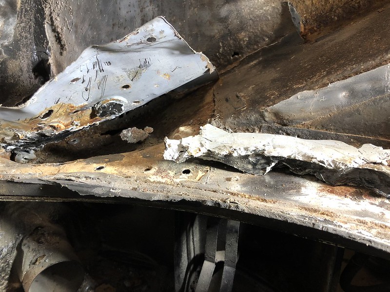

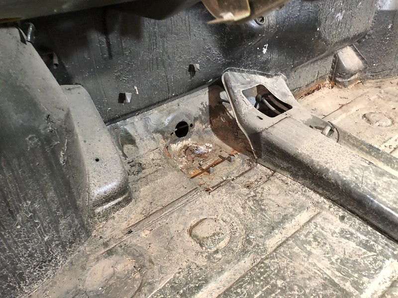

Then this:
(IMG:http://www.914world.com/bbs2/uploads_offsite/live.staticflickr.com-22225-1554736441.2.jpg)
(IMG:http://www.914world.com/bbs2/uploads_offsite/live.staticflickr.com-22225-1554736441.3.jpg)
(IMG:http://www.914world.com/bbs2/uploads_offsite/live.staticflickr.com-22225-1554736441.4.jpg)
(IMG:http://www.914world.com/bbs2/uploads_offsite/live.staticflickr.com-22225-1554736442.5.jpg)
(IMG:http://www.914world.com/bbs2/uploads_offsite/live.staticflickr.com-22225-1554736442.6.jpg)
Pictures don't do this custom work justice. This patch was a good inch thick with
what looked like fiber filler and tar.
(IMG:http://www.914world.com/bbs2/uploads_offsite/live.staticflickr.com-22225-1554736442.7.jpg)
(IMG:http://www.914world.com/bbs2/uploads_offsite/live.staticflickr.com-22225-1554736443.8.jpg)

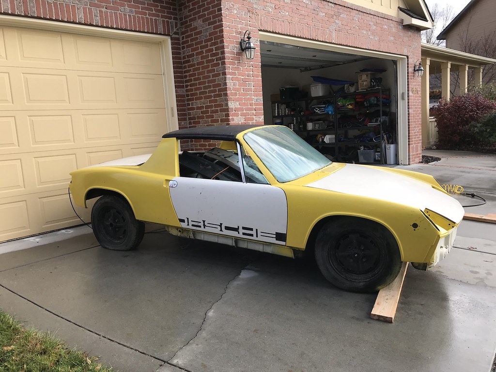

Before I got too crazy with the cutting and welding, I decided to check the door gaps to make sure. Everything checked out. But I was worried that the PO had done similar repairs in other areas and covered them up with the lovely Walmart tractor yellow.
I went around the car and tested door jams, trunks, fenders, sail panels - all the nooks and crannys that might have other surprises waiting. I did find a nice bondo monument to middle school dropout bodywork in the rear trunk, and a few small cover ups on the sail panels, but overall this is a pretty solid car.
Oh, and if anyone is interested I have a set of slightly used hell hole patch panels that I'd sell for super cheap.

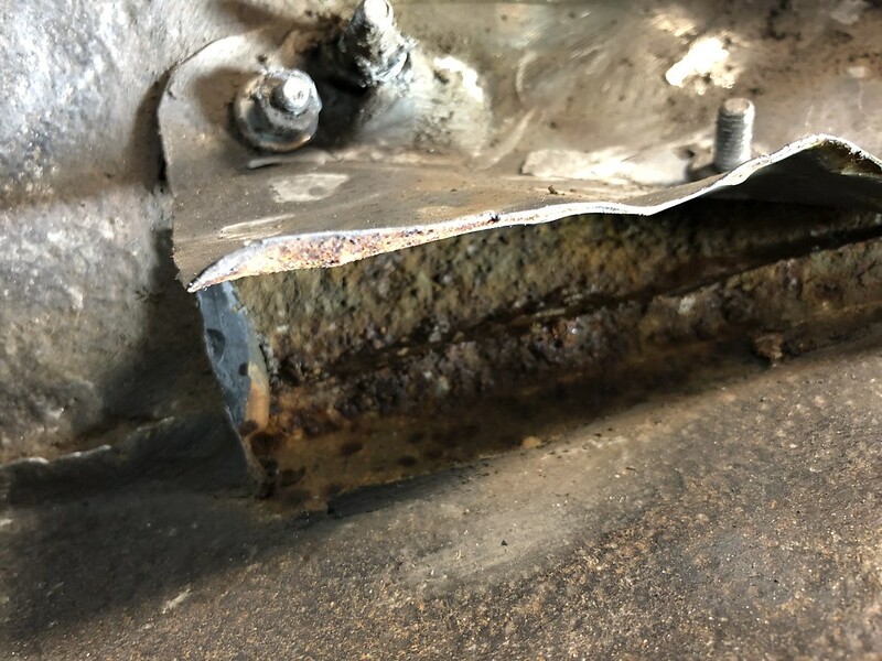

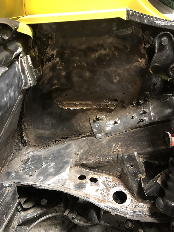

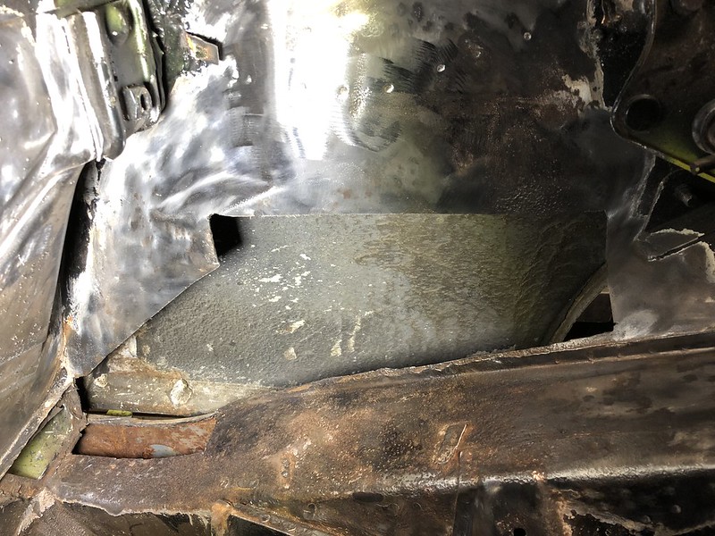

I started cutting back to find solid metal. Luckily, the long wasn't bad, and I probably cut more out of the inner fender well than I needed. There was definitely one annoying little corner in the firewall that was a booger to clean up.
(IMG:http://www.914world.com/bbs2/uploads_offsite/live.staticflickr.com-22225-1554737982.1.jpg)

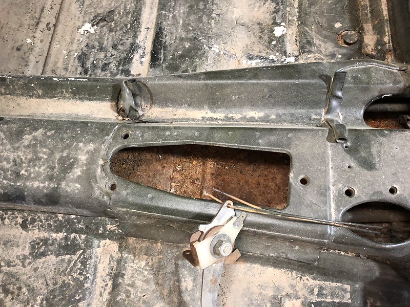

It was nice to see that the inside of the long wasn't completely rotten. I probed with my chisel and body hammer and found a little spot at the bottom of the long.
(IMG:http://www.914world.com/bbs2/uploads_offsite/live.staticflickr.com-22225-1554737983.2.jpg)
But there was solid metal to work with. Sorry for the shady picture..
(IMG:http://www.914world.com/bbs2/uploads_offsite/live.staticflickr.com-22225-1554737985.3.jpg)
I was relieved to see some factory primer peeking through the sides and bottom. Once I vacuumed all the rust and flake out, it looked pretty good overall. I didn't get a good picture, but just in front of the firewall toward the front of the car is all factory primed metal. I'll have to open up the bottom and weld in a patch, but it should be minimal. My plan is to open it up, clean and scrape and then treat with phospho and some frame wax.
