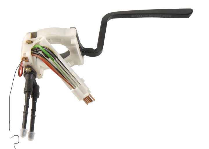

Your problem is a loose ground connection. This connection is through the steering housing and not a brown wire. There are 4 screws that hold the turn signal / wiper switch in place. This is where the ground comes from. I had one steering column where the boss that the screw screws into was a little low. This means when you tighten the screw, the contact point on the back of switch doesn't fully make contact with the housing. I believe it is the top right screw that is important. Try placing a small brass washer on the underside of the switch where the screw goes through.
Bartlett 914
post Jun 28 2012, 08:21 AM
Posts: 2,218
Joined: 30-August 05
From: South Elgin IL
Member No.: 4,707
Here is the backside of the switch. You can see there is a washer where the screw will come through. The other 3 do not have this. It must make good ground contact.

QUOTE(Bartlett 914 @ Jun 28 2012, 06:21 AM) *
Is this the same part ?
