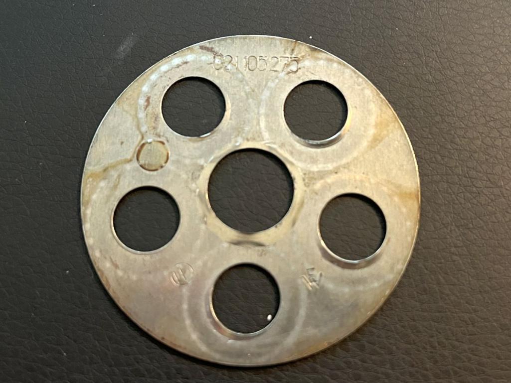

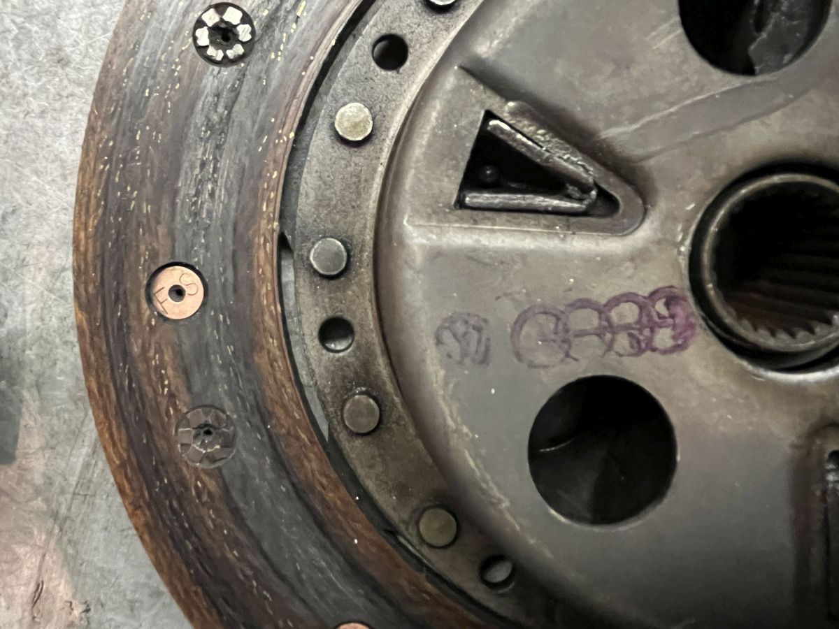

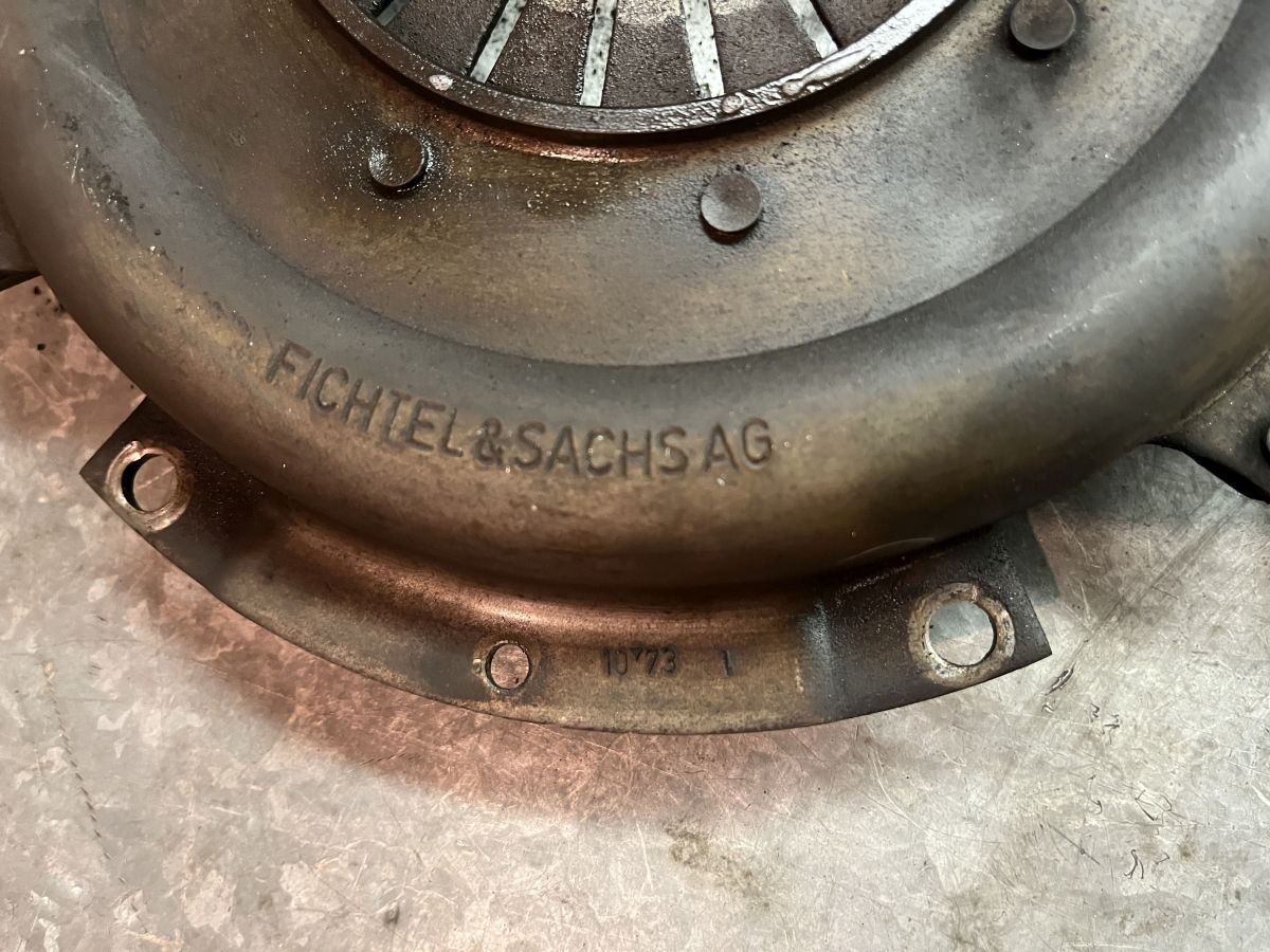

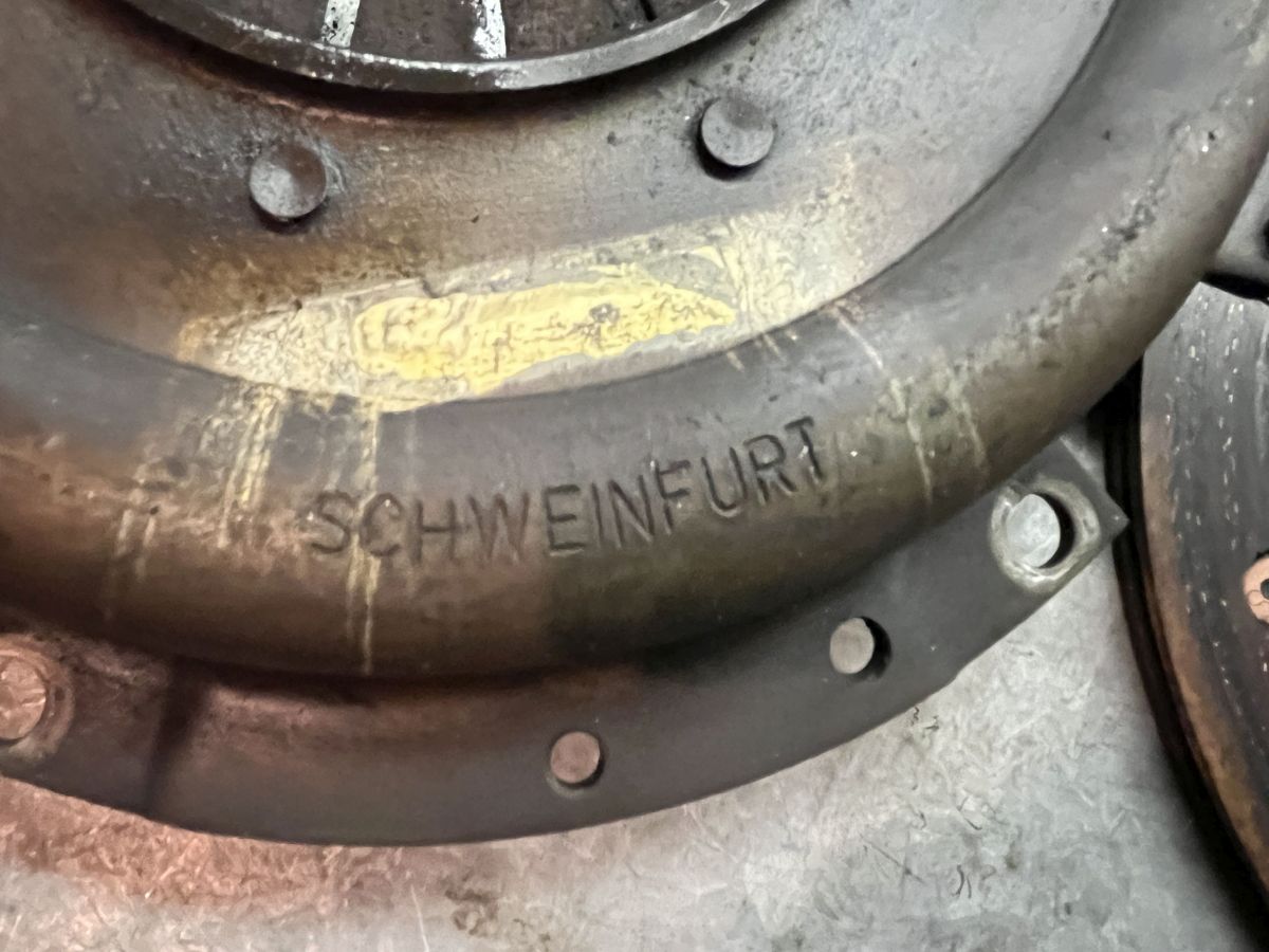

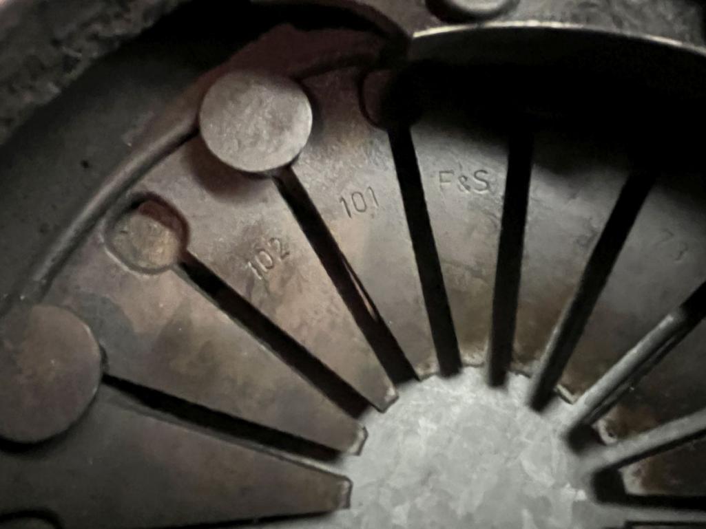

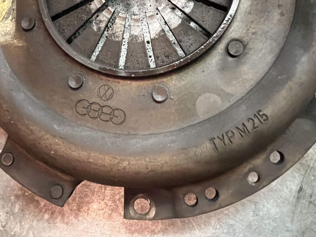

@JeffBowlsby - check your flywheel washer while you have it all out.
if its got the VW insignia on it 99% means its a production line item.
and flywheel has never been off.
spare parts washers only had the parts manufacturer emblem on them.
that the strange little mark to the right.
post Jan 2 2026, 05:32 PM
Posts: 9,154
Thanks wonki...here are my numbers from the various parts. This is everything. Looks like there may have been a lable on the pressure plate, but its long gone. PP plate dated 10/73, for a car that was dated 2/74. JIT production didn't exist back then.
