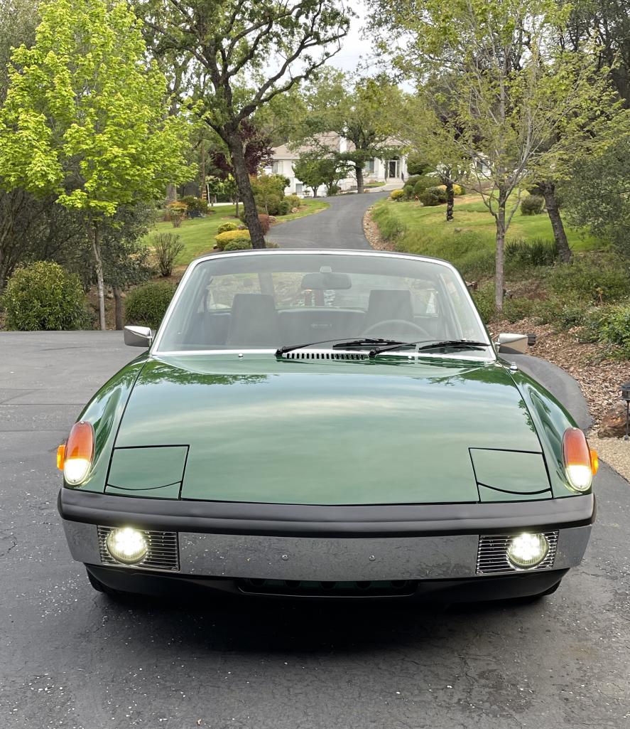

Here's a 914 fog light install with the backdated bumpers so of course I needed the fogs!
I got the housings from Bruce Stone, and they just needed some good cleaning, resto, and wiring to connect it to the existing parts on the harness! I used 914Rubber’s lens seals and clips, and they also have glass replacements for the lenses! This project definitely had its little knots, just like the one Russ had to untangle. Name that spoof!

I have a set of allegedly yellow LED fogs that look a bit too much like amber and I haven't sold them. You can have them for no charge if you make a video of the install. The LEDs are in a rectangular 2x4 pattern.

ohh those are cool too. I need to figure out the wiring trickery if I go LED on these. Need to do some reseach to see if there are LED bulbs that can go into those bayonet sockets. dunno anyhitng on this stuff. Thank you for the offer and the kind words. I'll let you know what direction I will be going. I need ot get this rolling on its own ASAP

Francis. Take him up on his offer. There are LED bulbs that fit but light pattern is way off. Jerry (Spoke) helped me fix the fog light/ led headlight issue. Are you running LED headlights? If so there is a simple mod you need to do.
Happy new year and nice video. Call me and I will explain the needed mod.

QUOTE(TINKERGINEERING @ Dec 31 2025, 11:36 PM) *
My foglights connect up to the OEM wiring. No changes necessary. They are about 2x as bright as OEM bulbs and burn 8W each compared to 35W for the OEM.
The boards replace the bulb, socket, and reflector and attach to the original lens and bezel using the OEM clips.
I provide a little tool to assist in installing the spring clips.

I have had Jerry's LED foglight in my car for a few years now and love them. I run them as stand-alone daytime running lights.
