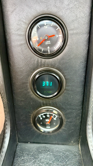

I have one that is good to go from a NH Speedo restoration but I'm not going to be back around it for a number of weeks.
If I were you, I'd find a Kienzle mechanical (not quartz) version. I have one and love it. It goes CLUNK every 45 seconds or so as the spring winds itself - just like the 914, it's so analog.
Mine is dated 7/72 so it's too "early" for my 74 but it's not a CW car...
(yeah - my CHT temp is a bit high here but that's been dealt with..)Attached Image
