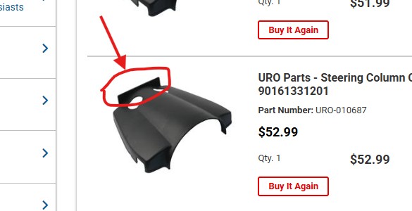

From my Summit order. The quality is great, fit is great. I couldn't be happier.
tygaboy
post Nov 22 2025, 10:04 AM
Posts: 5,710
Joined: 6-October 15
From: Petaluma, CA
Member No.: 19,241
Heads up that in order to fit the lower dash pad, there's that little edge I had to trim off. It's on the lower shell and essentially hidden when everything's installed.
Hope this helps.

Be very careful with those as reproductions are currently not available. I have been seeking a set for a customer car for 6 months now.
and to answer your question, they don't mount to the clamshell, they sit behind it. There is a channel that slides into the dash facia pieces on both sides. Easier to install if you haven't already installed the facia and steering column.

That is not the correct clamshell for a 914-6. It will work but it is physically different.
JamesM
post Nov 22 2025, 01:10 PM
Posts: 2,153
Joined: 6-April 06
From: Kearns, UT
Member No.: 5,834
QUOTE(JamesM @ Nov 22 2025, 12:03 PM) *
QUOTE(rgalla9146 @ Nov 22 2025, 06:06 AM) *
I can't believe this but of all things Summit Racing sells the clamshells.
914 613 311 00 is the correct column cover/switch housing
and
914 552 241 10 are the pieces that you have in your photo
Autoatlanta had someone that was molding reproductions but they no longer are. We have been working to try and facilitate production as we have a factory -6 in need but as of right now there is no ETA (and there may never be)
