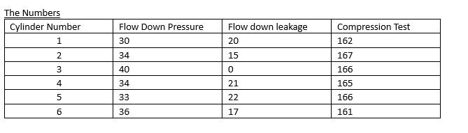

Less than 1 hour of run time between now and this measurement earlier in the year.
1 - 162
2 - 167
3 - 166
4 - 165
5 - 166
6 - 161
I have the leak down numbers somewhere - but I recall them to be consistent as well,
The valves were all set when the engine was out and on the stand - there is a mention of this within the rebuild thread
Thank you!

post Oct 9 2025, 11:46 AM
Posts: 7,592
QUOTE(ctc911ctc @ Oct 9 2025, 01:19 PM) *
1 - 162
2 - 167
3 - 166
4 - 165
5 - 166
6 - 161
Thank you!
ON to the carbs!
Just to clarify- with respect to spitting the location of leakage matters not the absolute numbers
Example: let’s say all cylinders are excellent with say 5% leak down.
But let’s say cylinders 1, 3-6 are primarily leaking 5% past the rings - great all is good and pretty normal due to ring gapping, cylinder sealing, etc.
But let’s say cylinder #2 is leaking 5% all past the intake valve seems great but not really - you will have spitting on #2 and more trouble tuning that cylinder.
Clearly I’m making up a pretty extreme example here to make a point. Not trying to imply this is what is going on in your case.
The point being - where the leakage is at matters in conjunction with the absolute leakage percentage. You’ve got to understand what is being measured, know where the leakage is at; that is the power of a leak down test Vs. compression test. There is more to it than looking at absolute numbers or leak down percentages.
Focus on the carbs but if you can’t get there - recheck assumptions.

Oh, here is a the numbers from earlier this summer:
