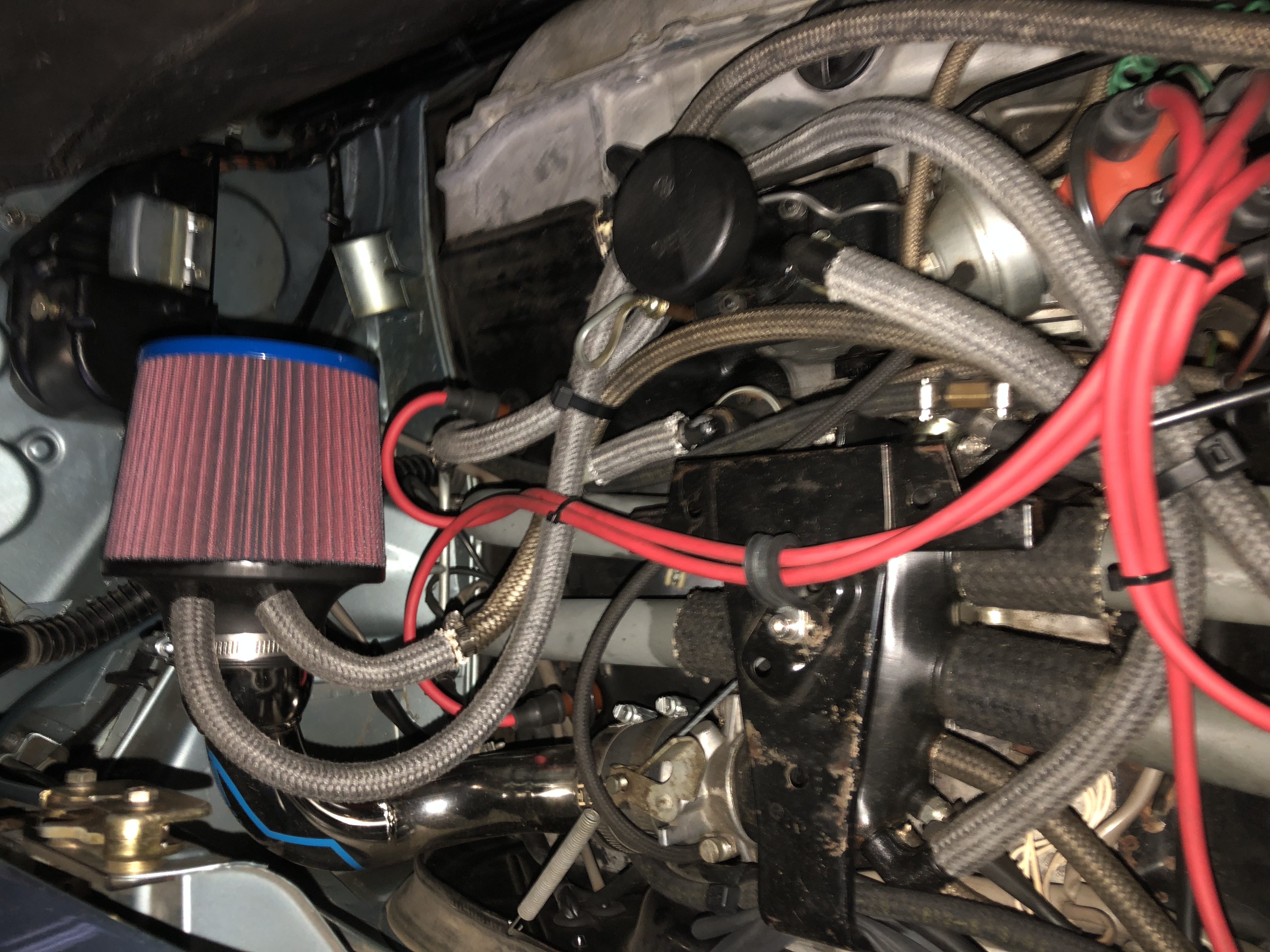

What set up is this? This is exactly what I'm looking for.
(IMG:http://www.914world.com/bbs2/uploads/post-8476-1756396037_thumb.jpg)
windforfun
post Aug 29 2025, 09:48 AM
Posts: 2,062
Joined: 17-December 07
From: Blackhawk, CA
Member No.: 8,476
http://www.autoatlanta.com/porsche-parts/a...sec=AIR-INTAKES
krazykonrad
post Aug 29 2025, 10:01 AM
Posts: 1,155
Joined: 21-February 06
From: Canton, GA
Member No.: 5,610
Thanks! (IMG:style_emoticons/default/beerchug.gif)

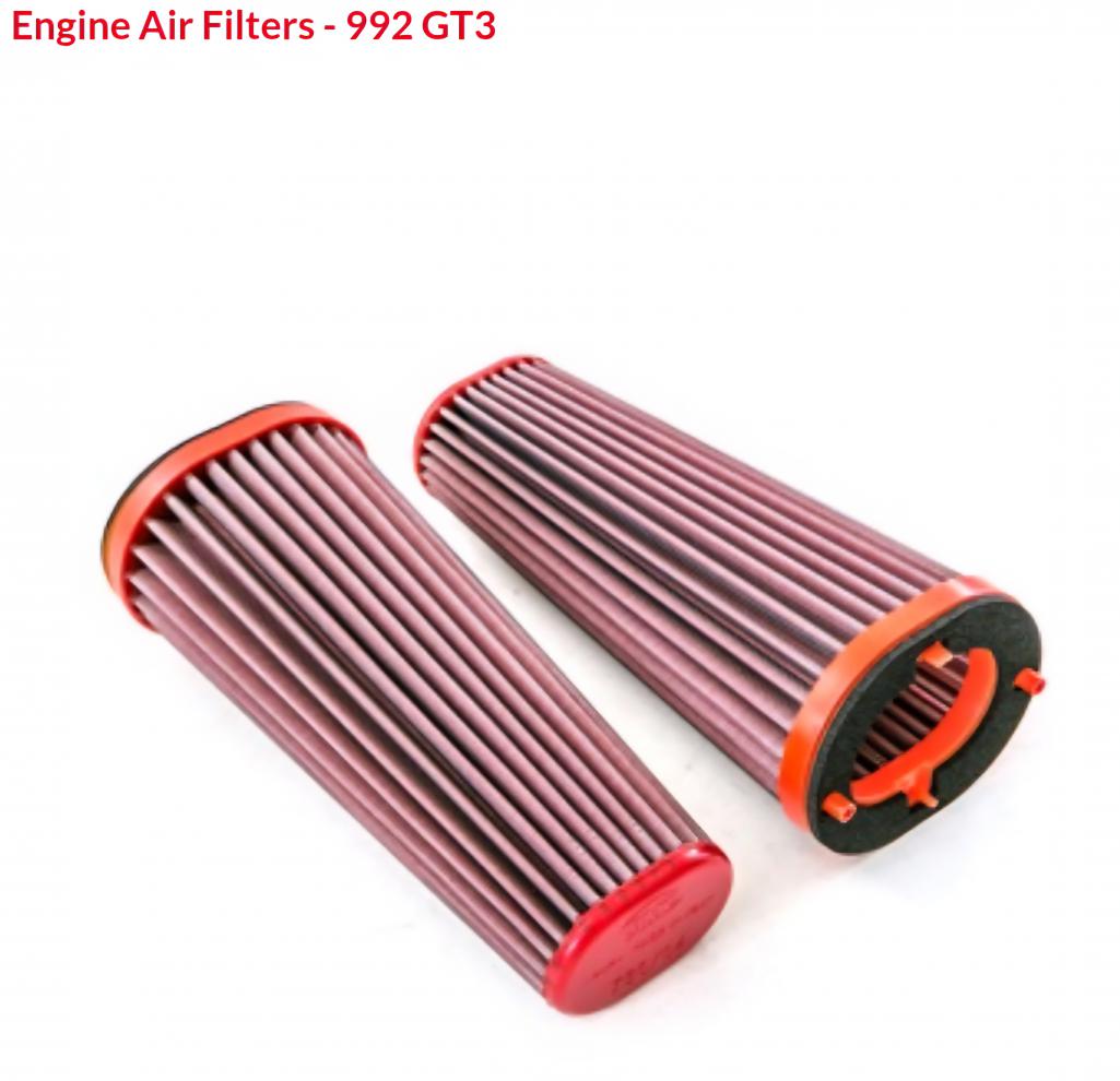

QUOTE(windforfun @ Aug 28 2025, 08:47 AM) *
Plug & play.
Even Porsche aG Discovered through the aftermarket: benefits of the Cotton gauze/ SS mesh cone air filters (IMG:style_emoticons/default/flag.gif)
