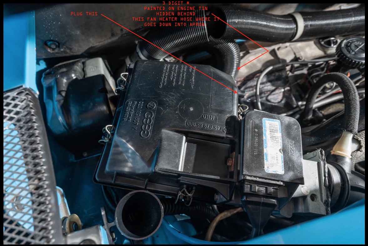

i checked out the engine bay photos when it was on BAT for L jet research.
noticed that its had its evap cannister and hoses removed.
not big deal.
but looks like the tube where the hose connected to air cleaner box has been left open?
its above the air filter element. means unfiltered air can be pulled in.
only small opening.......but. i'd cap it if its not already sealed.
if you got time, there is a bit of data be useful for L jet research.
there is a three digit number painted on in white paint usually where i have indicated on photo. on LHS engine tin. hidden by the fan heater hose from view.
the engine tin looks all original and unrestored on your car so its probably still there.
if it is what is the number?
and if you know, was the car an original california car (sold first in cal) or is it a 49 state car.
enjoy the 914. fun. (IMG:style_emoticons/default/beerchug.gif)

Thanks for the info/reply. I will cap that portion ASAP. I do not know if the car is/was always a California car. I have paperwork showing it was in Canada, Oregon, and California in the past. It has 81k original miles and has remarkably little rust in all of the problem areas. I cleaned behind the side skirts / longitudinals today, removed about 4 lbs of dirt and crud. The longs look great.
Here are a few photos of the white painted numbers you were asking about:
Drivers side
Passenger:
What do the numbers mean?

918 should mean this.
75 1.8 L Jet. 49 states.
Engine Famiy 15.
No oil temp sensor/sump plate.
No EGR.
IO means in order. or more strictly german Inordnung.
or in USA manufacturer language OK.
sounds/looks like an original car with original engine to me.
if so - its a non californian market car originally.
thanks for the info?
here is a link to thread with final table of all those markings for all the years.
all the various aircooled VW engines of that time had these coded markings.
http://www.914world.com/bbs2/index.php?sho...6668&st=140
