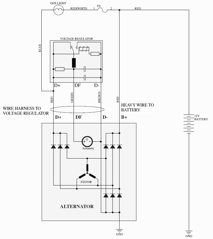

There is a quick test you can do on the alternator.
Start the engine.
Measure the voltage on all 3 wires going to the alternator with respect to chassis ground.
D- should be zero volts
DF should be 5-9V
D+ should be 13-14V

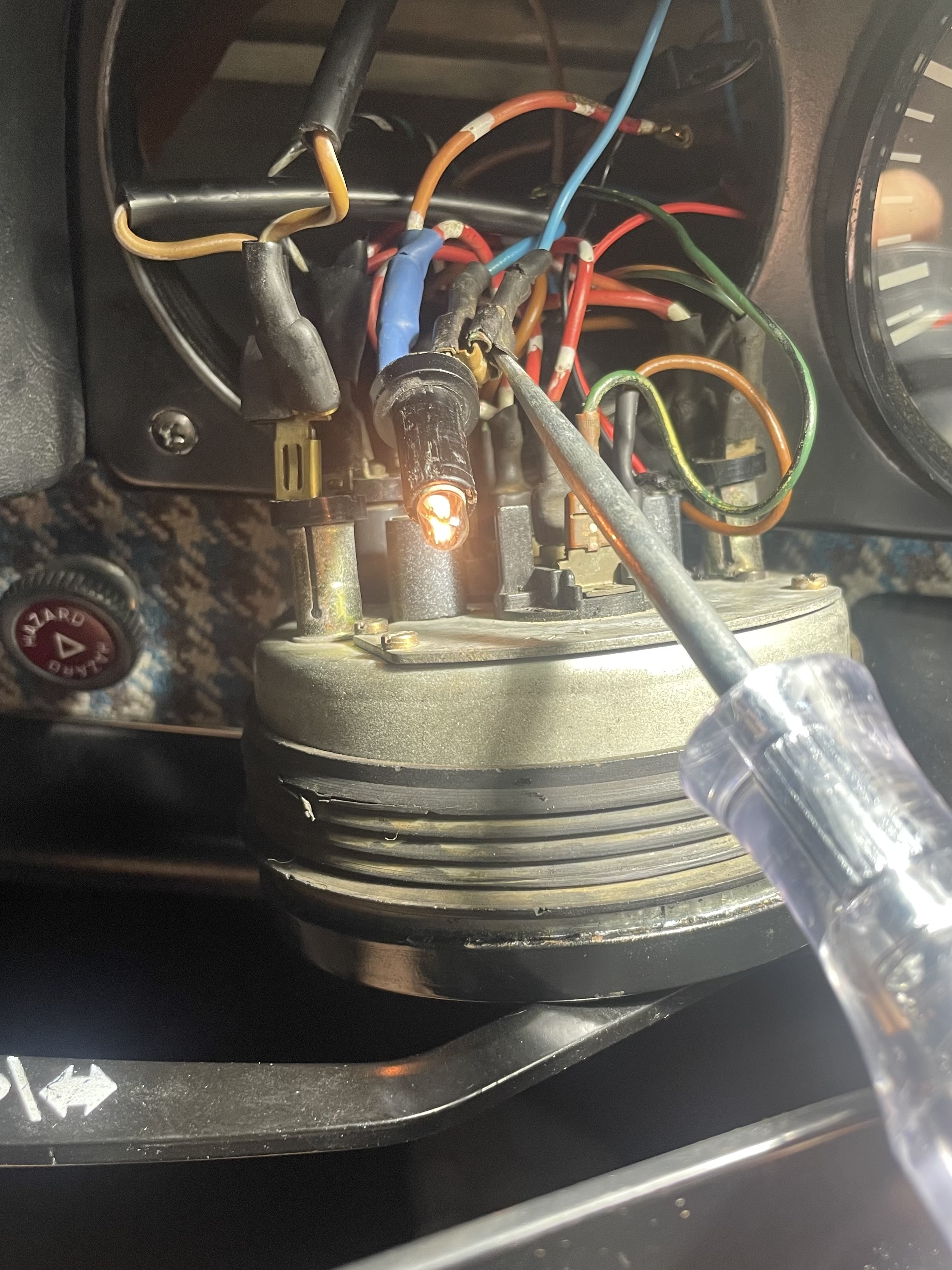

update - the bulb is not blown. I can get it to light up with the ground provided by a test light.

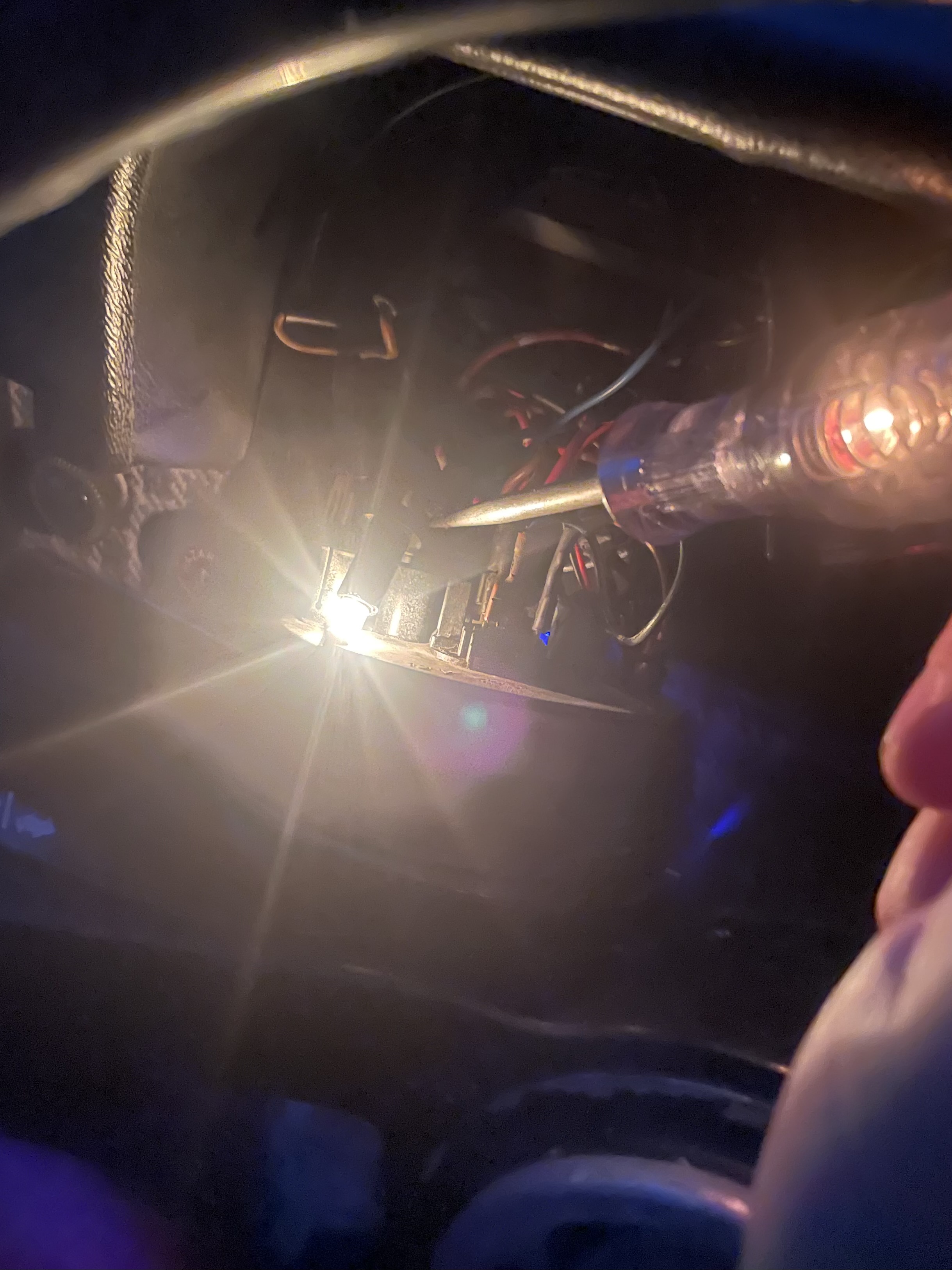

Alt light with ground provided by test light… lights the tester too.

You can see the rat’s nest of wires here
GregAmy
post Aug 10 2025, 08:13 PM
Posts: 2,549
Joined: 22-February 13
From: Middletown CT
Member No.: 15,565
QUOTE(Literati914 @ Aug 10 2025, 08:42 PM) *
You're aware that it's almost impossible to get the alternator to "excite" without a properly working GEN bulb? Make sure it's on with the key on. Once confirmed, start the car and recheck the voltage at the battery.
QUOTE(Literati914 @ Aug 10 2025, 08:14 PM) *
What else can be checked before assuming it's a bad alternator?
Read post #2 above..? (IMG:style_emoticons/default/confused24.gif)

QUOTE(Literati914 @ Aug 10 2025, 11:17 PM) *
removing the alt plug at the relay board in order to check the voltages of the wires there, like @Spoke suggested ^^ and forgetting you've done so, will cause the Alt light on the dash to no longer illuminate. I plugged it back in and the light on the dash works fine again. Sorry for side tracking everyone.
About those wires... with the engine running, the red wire is showing a (guessed) average of about 1.3V .. the brown and the green are both showing .002V . So, that's a bad alternator, no?
If you unplugged the alternator please plug it back in to test. The test I suggested is done with the plug connected as normal.

QUOTE(Spoke @ Aug 11 2025, 06:30 AM) *
idleing:
D+/Red = 13.6v
DF/Green = 4.05 etc
D-/Brown = 0.05 etc
Spoke
post Aug 11 2025, 04:02 PM
Jerry
Posts: 7,231
Joined: 29-October 04
From: Allentown, PA
Member No.: 3,031
QUOTE(Literati914 @ Aug 11 2025, 04:32 PM) *
idleing:
D+/Red = 13.6v
DF/Green = 4.05 etc
D-/Brown = 0.05 etc
Those are excellent numbers. The VR is working perfectly. The VR senses the voltage at D+ and adjusts DF to output 13.6V +/- 0.4V. I made up that tolerance but the bottom line is 13.5-14V is perfect.
I should have asked to also measure the battery voltage at the time of measurement. It runs open loop from the alternator diodes driving D+. If diodes are all good VBAT should equal D+.
What is the battery voltage at idle? Positive terminal to chassis ground.
What is the battery voltage from positive POST to the negative POST? Just want to see if the battery wires or connections are suspect. Post to Post or Pos Terminal to chassis should be identical if the wires/connectors are good.
