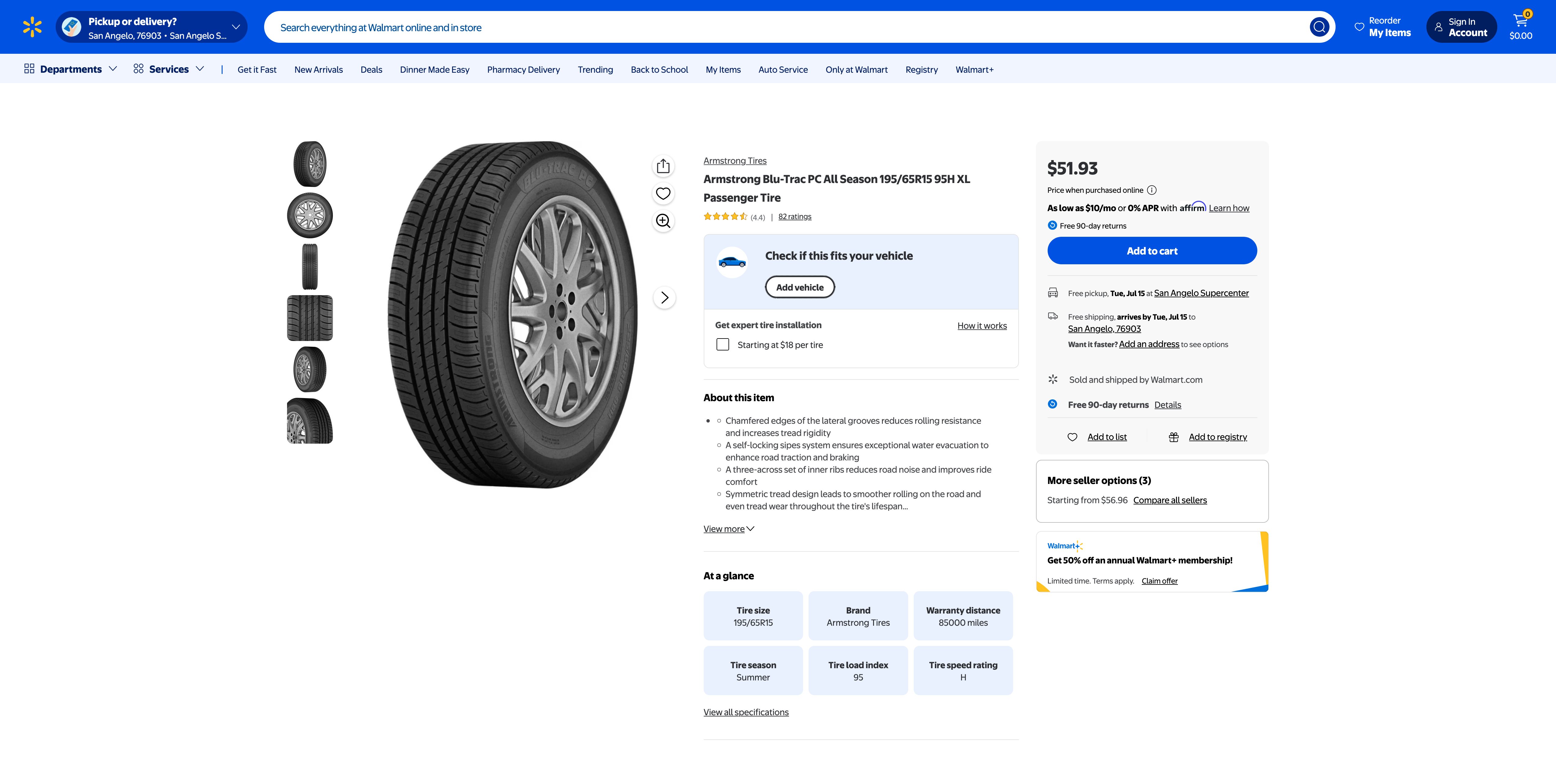

195/65/15 for the Creamsicle. Don't laugh but this tire is a good also season H rated tire with 85,000 range. Price is great. They KILL YOU on installation and balance for half the price of the tire. $22+ $3 disposal.

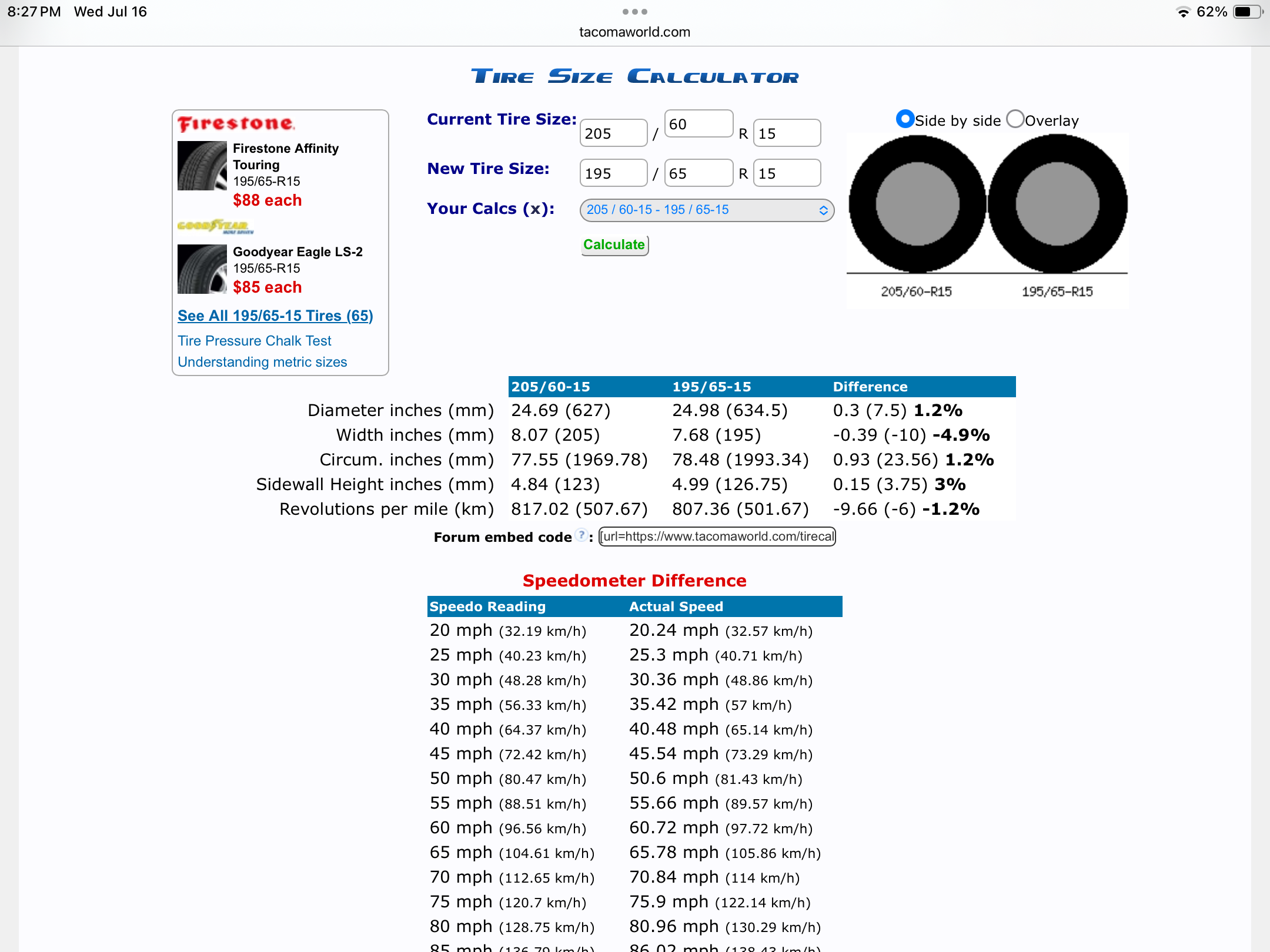

My old (205-60-15) tires looked perfect with about 2K miles when installed about 20+ years ago.
Yesterday I installed (4) new 195-65-15 tires that improved ride quality with improved handling (IMG:style_emoticons/default/pray.gif) This was long overdue and cheap life insurance due to old tire safety driving issues.

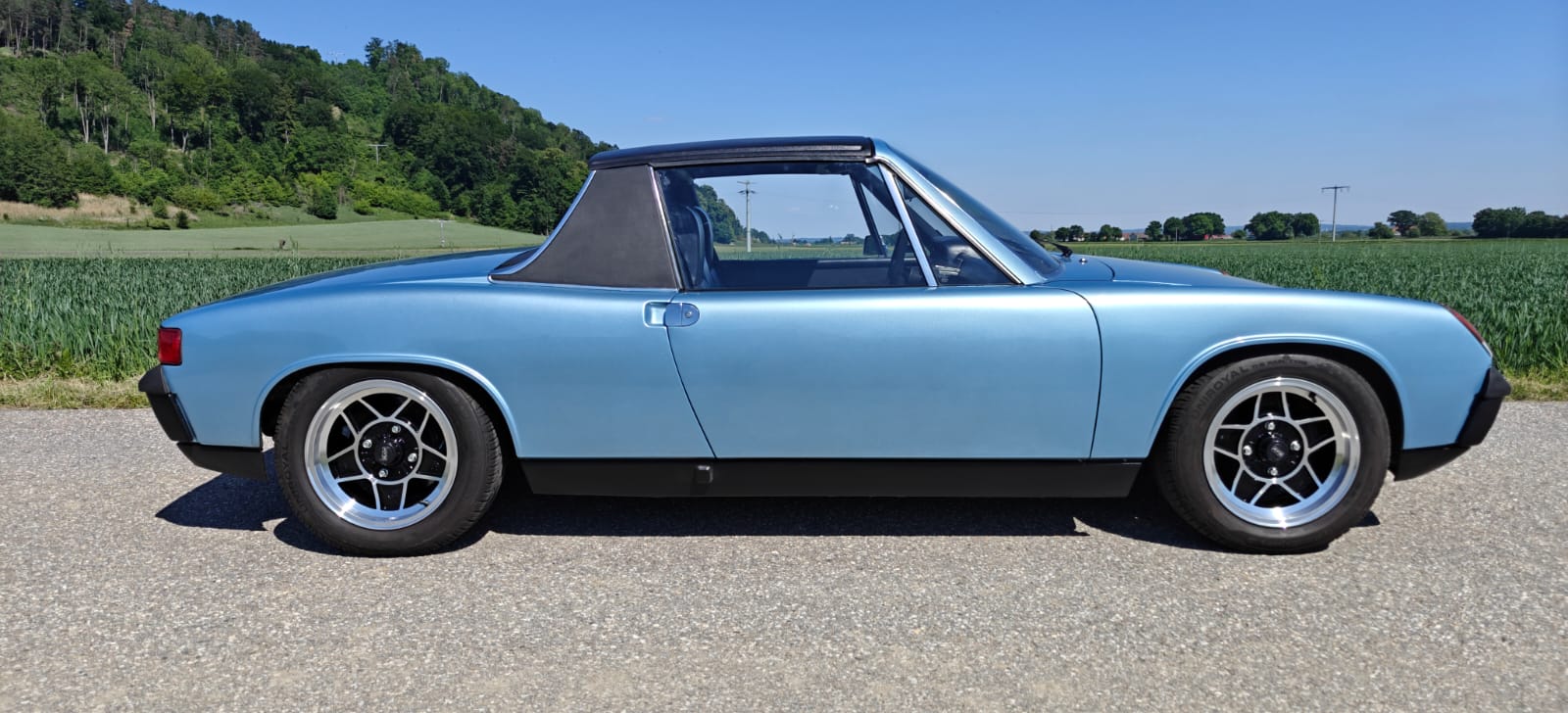

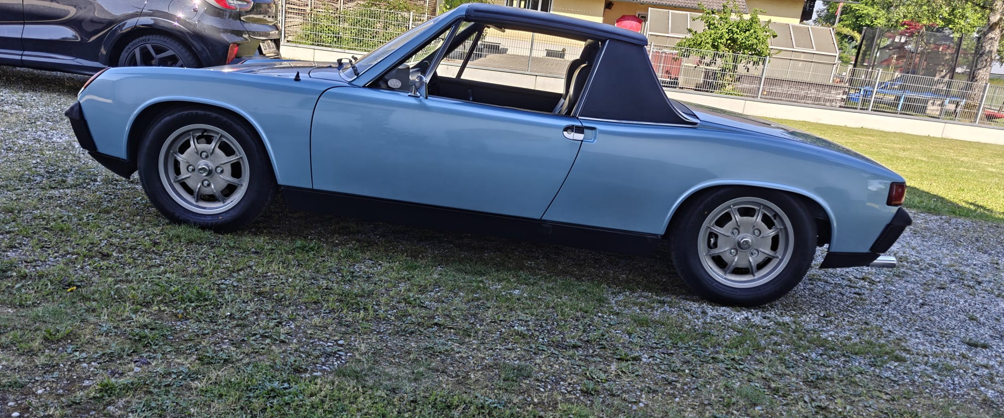

Hey guys,
I do have 205/60R15 Kleber Dynaxer HP4 tyres on 7" wheels with 16 offset.
No need to do some bodywork with this setup.
Third picture is with the 205s on serial rims.
Best regards
Chris
