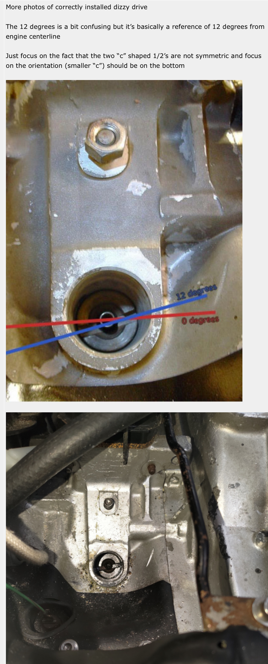

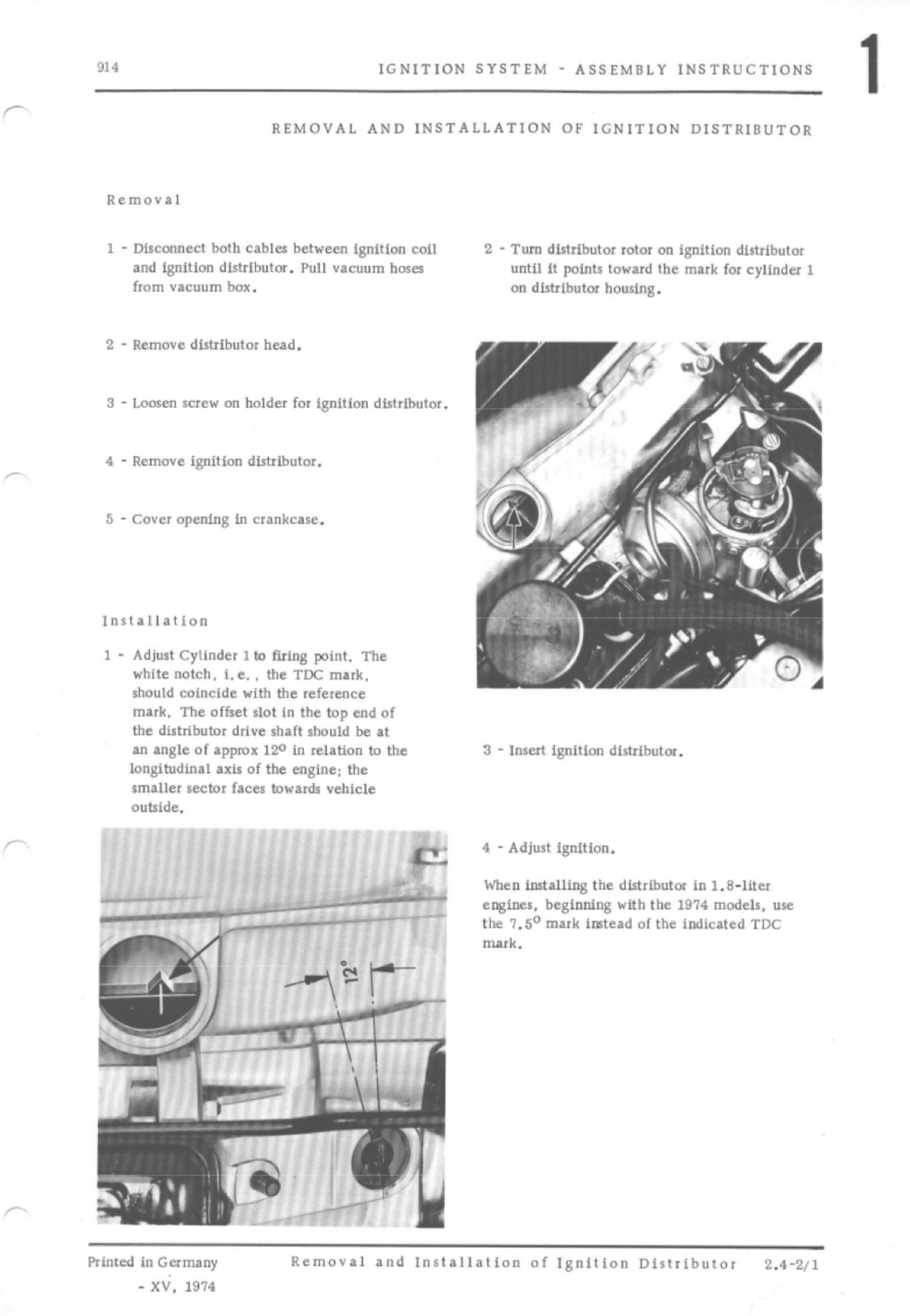

The dizzy drive gear installation and proper position is covered in both the Haynes and factory manual Attached Image
http://p914-6info.net/PDFs/Group%201%20Engine%20914-4.pdf
I’ll post some better pictures of a properly oriented dizzy drive gear shortly (within next hour) for your reference of what it looks like vs the grainy photo above
The bottom line is the drive is asymmetric - the smaller section goes toward passenger side and is angled about 12 degrees counter clockwise to the case centerline. The drive gear has 12 teeth - so being off 1 tooth advances or retards the timing by 30 degrees. Likewise - these often get installed 180 degrees off.
Note: this needs to be set at TDC of cyl#1 compression stroke (ie both valves closed)
Note: If you have to re-index the drive gear — Be careful when you pull the drive out. There is a thrust washer on the bottom that will stay in the engine under the drive gear. Hopefully you’ve seen this washer before and are familiar with it from the rebuild.
