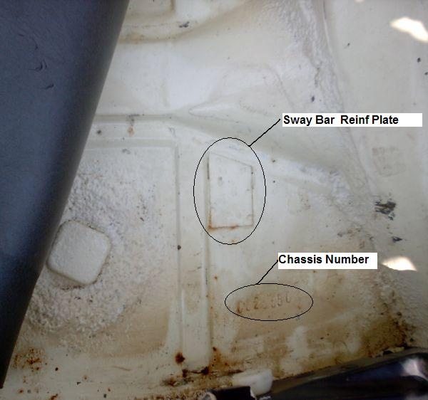

Clay, Interested if you can confirm this, as well. (IMG:style_emoticons/default/beerchug.gif)
A pic could probably help as well. Hard to see in the above photo that I pulled from an very old thread. Thanks!

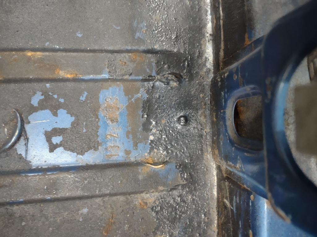

I just walked out into the garage and took this:
Funny.. I work with LOTS of metric stuff all the time, but all of my tape measures are in inches. It is about 3.8 of an inch, which is 9.5 mm. But it was an eyeball and tape measure thing, so I figure 10 mm is right.

QUOTE(ClayPerrine @ Jun 27 2025, 02:57 PM) *
Clay, what year is Elwood? Your chassis number appears to be located in the middle - not to the pass. side by the sway bar reinforcement tab. Interesting (IMG:style_emoticons/default/huh.gif)

I can confirm 10mm height and 7 digit number plus position relative to sway bar mount on rear passenger side of trunk. This from survivor LE.

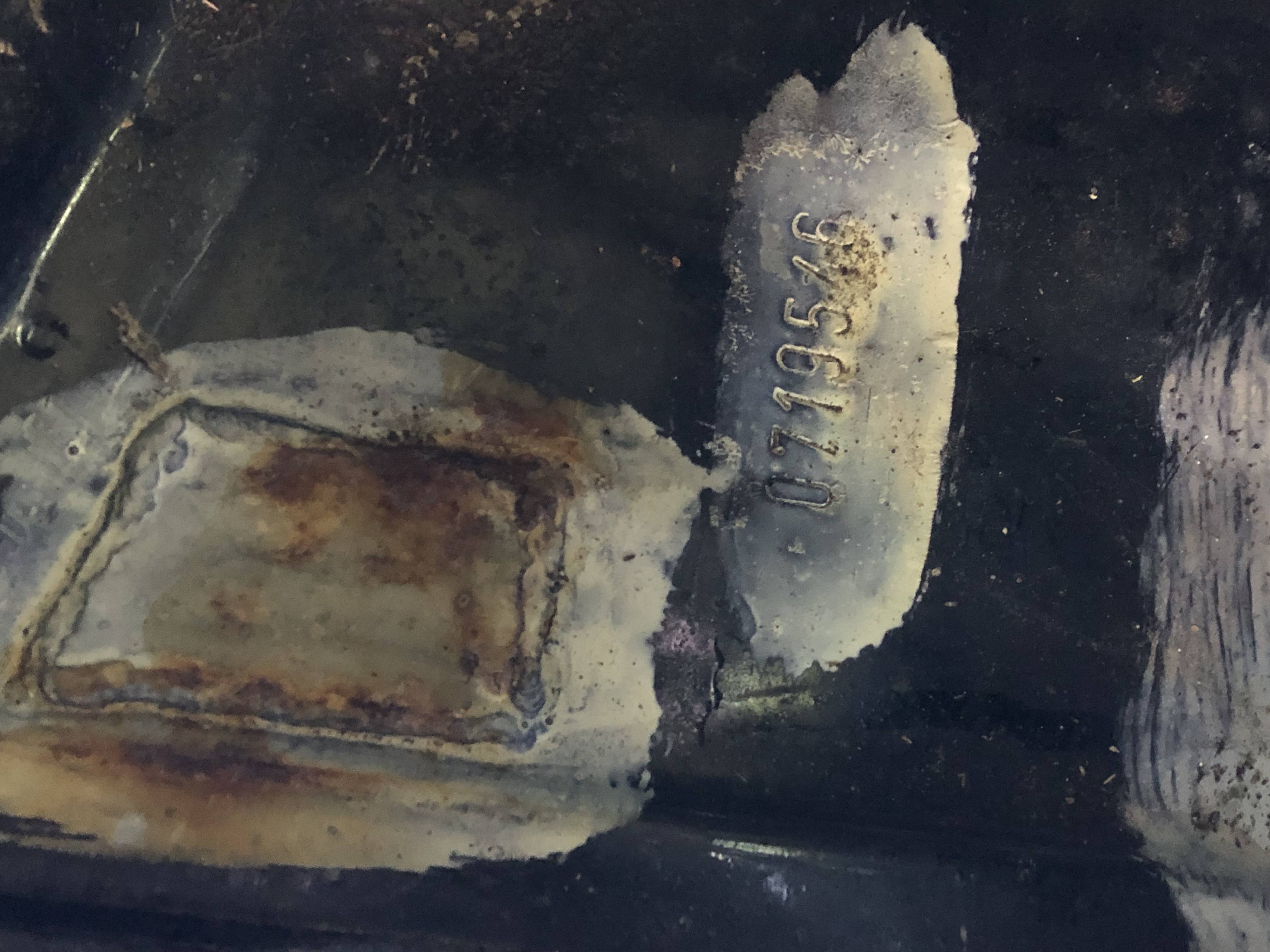

This is the 1970 location, and the 1970 914/6 series # with the year position missing.

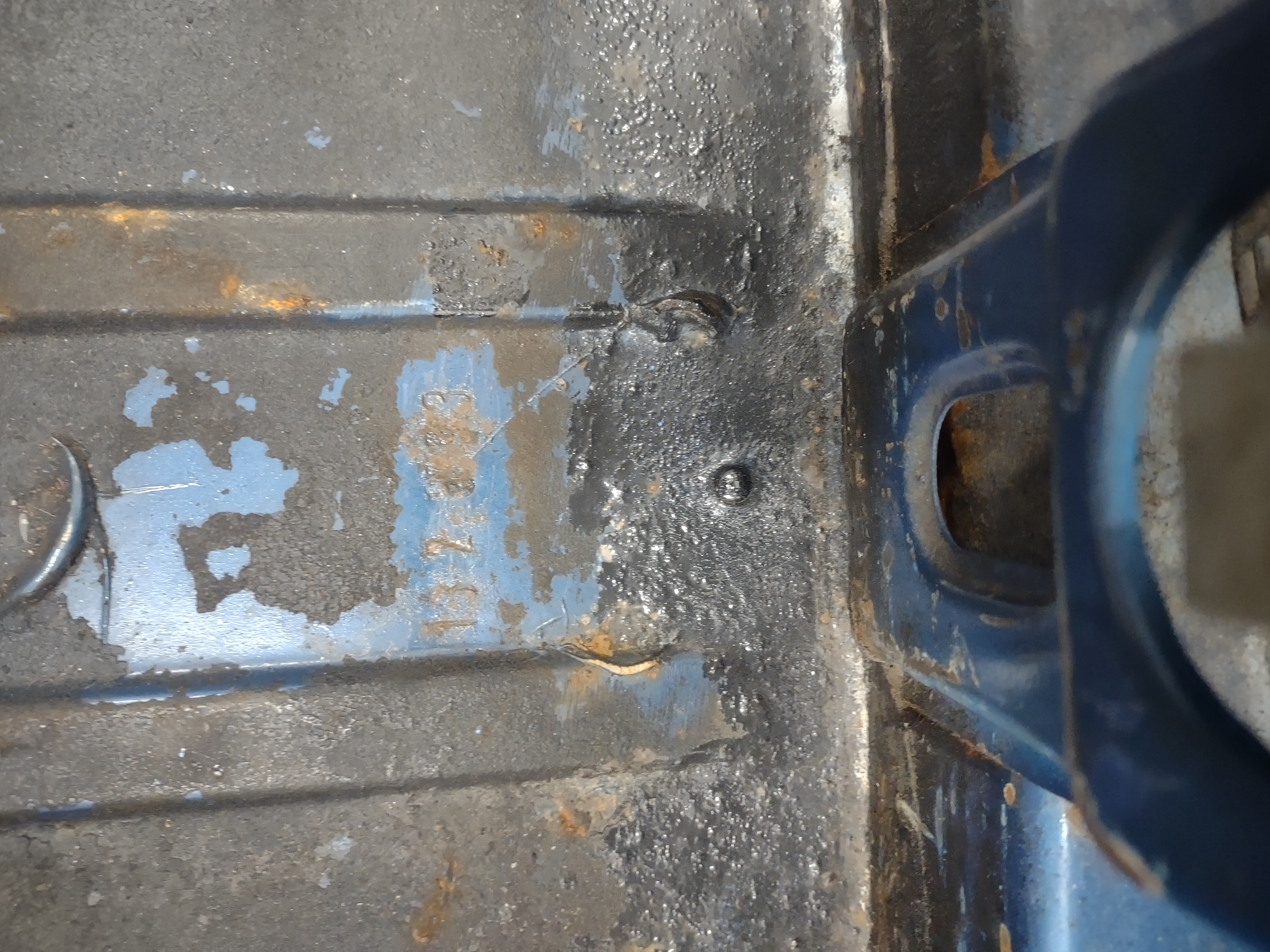

Apparently the number on the six chassis was stamped in a different location.
There is surface rust obscuring some of the letters. I am hesitant to take it off.

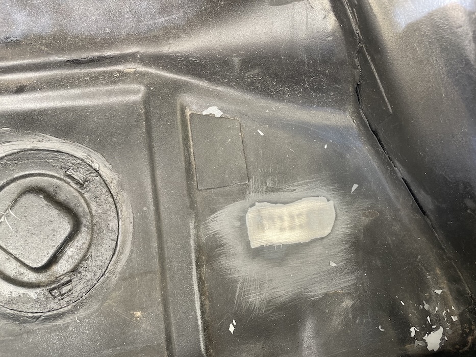

Well I won't call it a complete failure but....
It's not easy to get a hammer in here and get the numbers straight. I used a piece of tape as a bottom line, which helped but I couldn't hit with enough force to really make a good imprint. Probably needs to be done before the piece goes in the car. (IMG:style_emoticons/default/confused24.gif)
If I can't get something behind it to actually imprint the numbers better, I may abandon the effort. I'm thinking I might use a bottle jack and some wood blocks to provide support from underneath. If so, I'll grind/hammer what I did and start over.

They should be oriented East/West, not North/South to be like original. (IMG:style_emoticons/default/rolleyes.gif)
