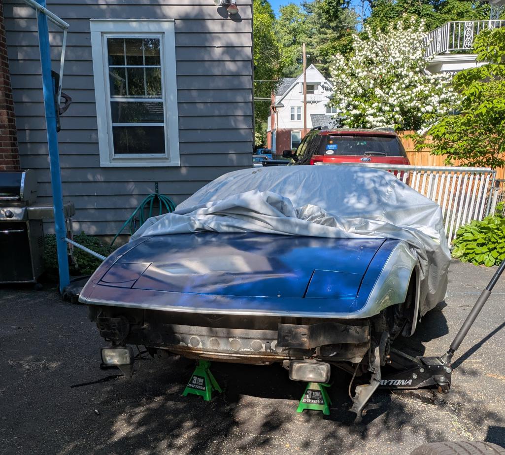

Doing some bumper repair this weekend. That and my son wants to help with new wheel bearings. Two birds with one jack stand setup.

Nice that you can pull the bumper off to handle repairs like that.
Don't let yourself find too much else "while you're in there", otherwise it'll be on jackstands for months!

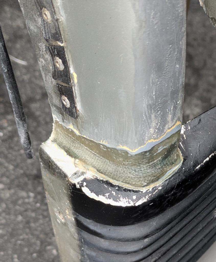

If that is fiberglass, I’ve found over the years that the Total Boat polyester resins are super strong and lay out Very nicely.
emerygt350
post May 31 2025, 11:23 AM
Posts: 2,915
Joined: 20-July 21
From: Upstate, NY
Member No.: 25,740

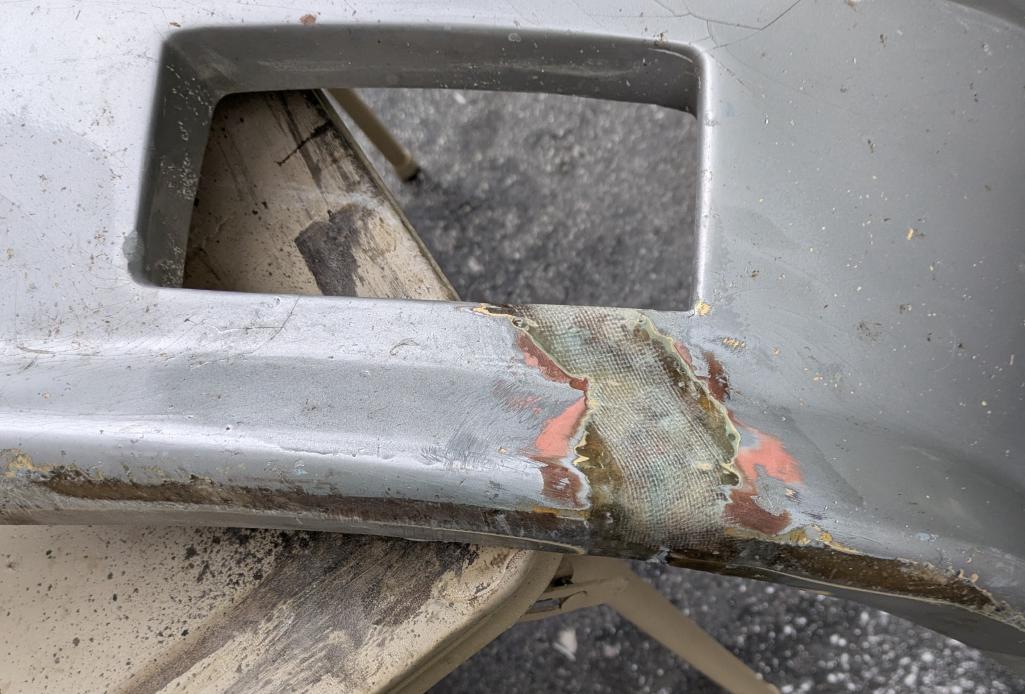

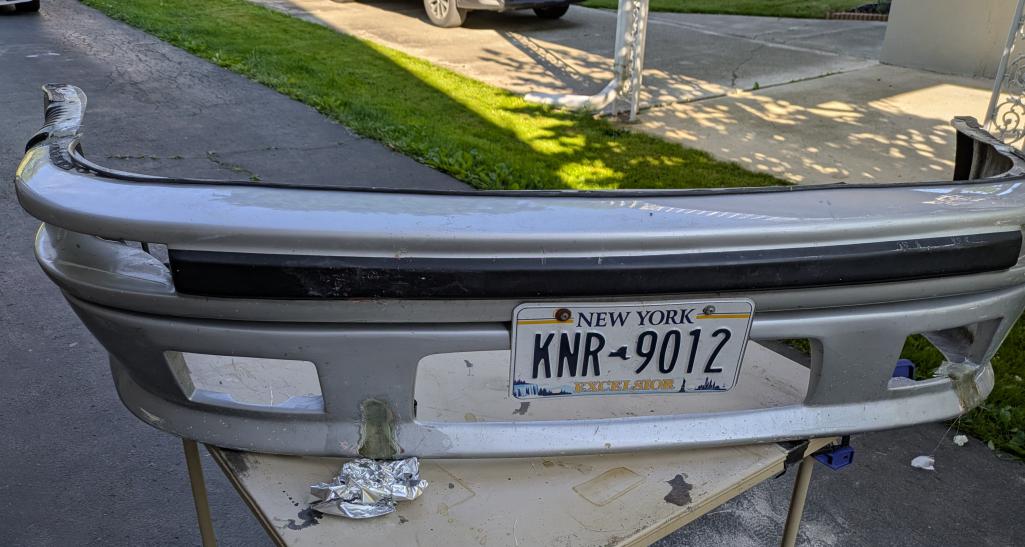

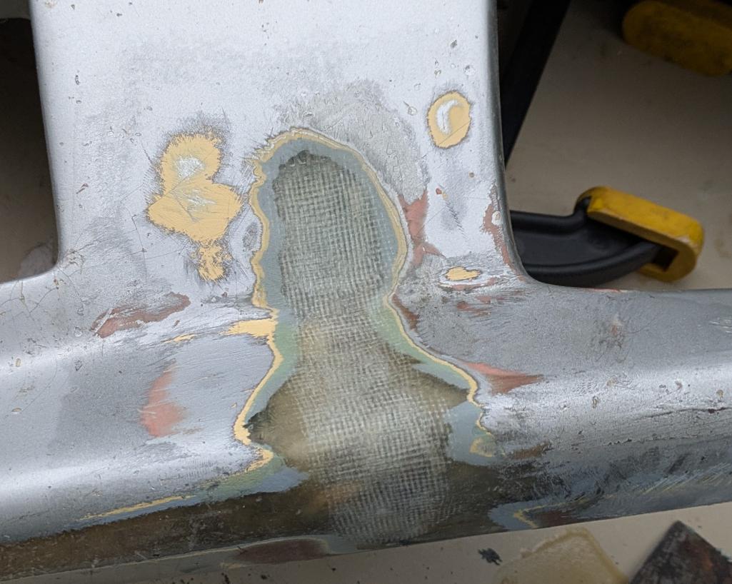

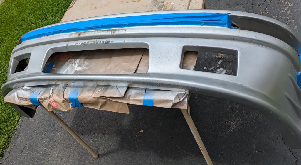

I have been using some expensive stuff I bought from the auto body shop supplier in town.
The overcoat of bondo is drying now. Should be painting tomorrow.

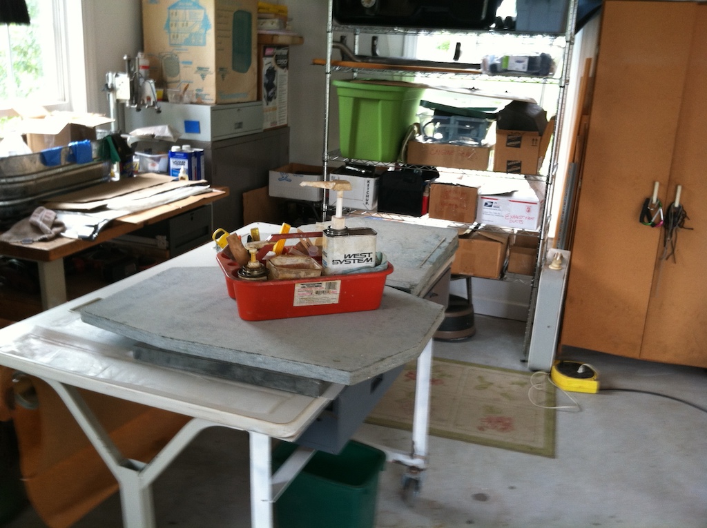

I've done almost the identical repairs on my FG front bumper but using West System epoxy products. I've used them for lots of marine projects, so easy to use on 914's
I even added a FG layer on the back side of the door cards as mine were kinda flimsy & did some minor repairs on the back pad also.
Rather than vacuum bagging the door cards, I had some scrap Granite counter top bits that are VERY flat to use to insure the door cards didn't warp.

That's a great idea.

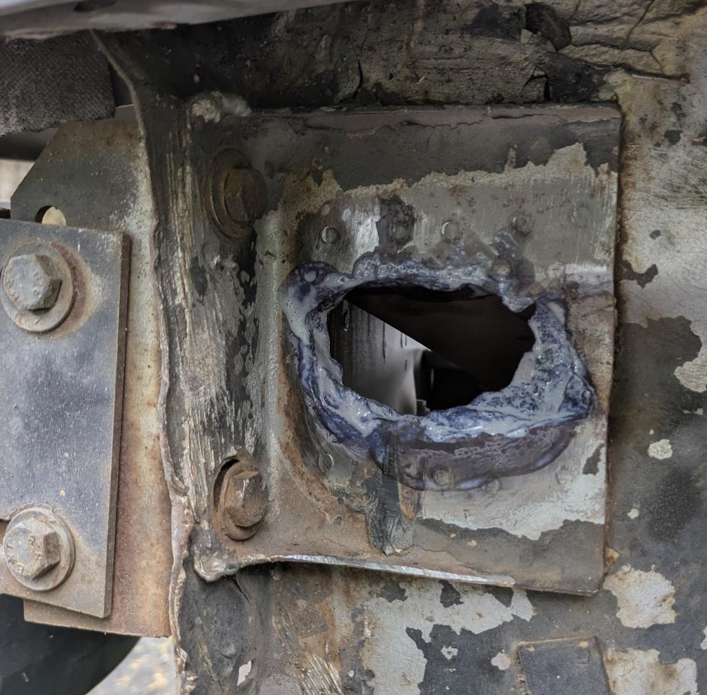

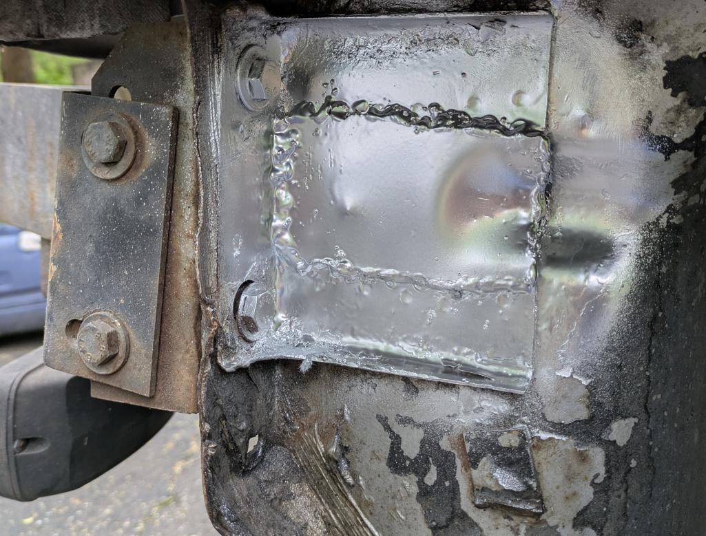

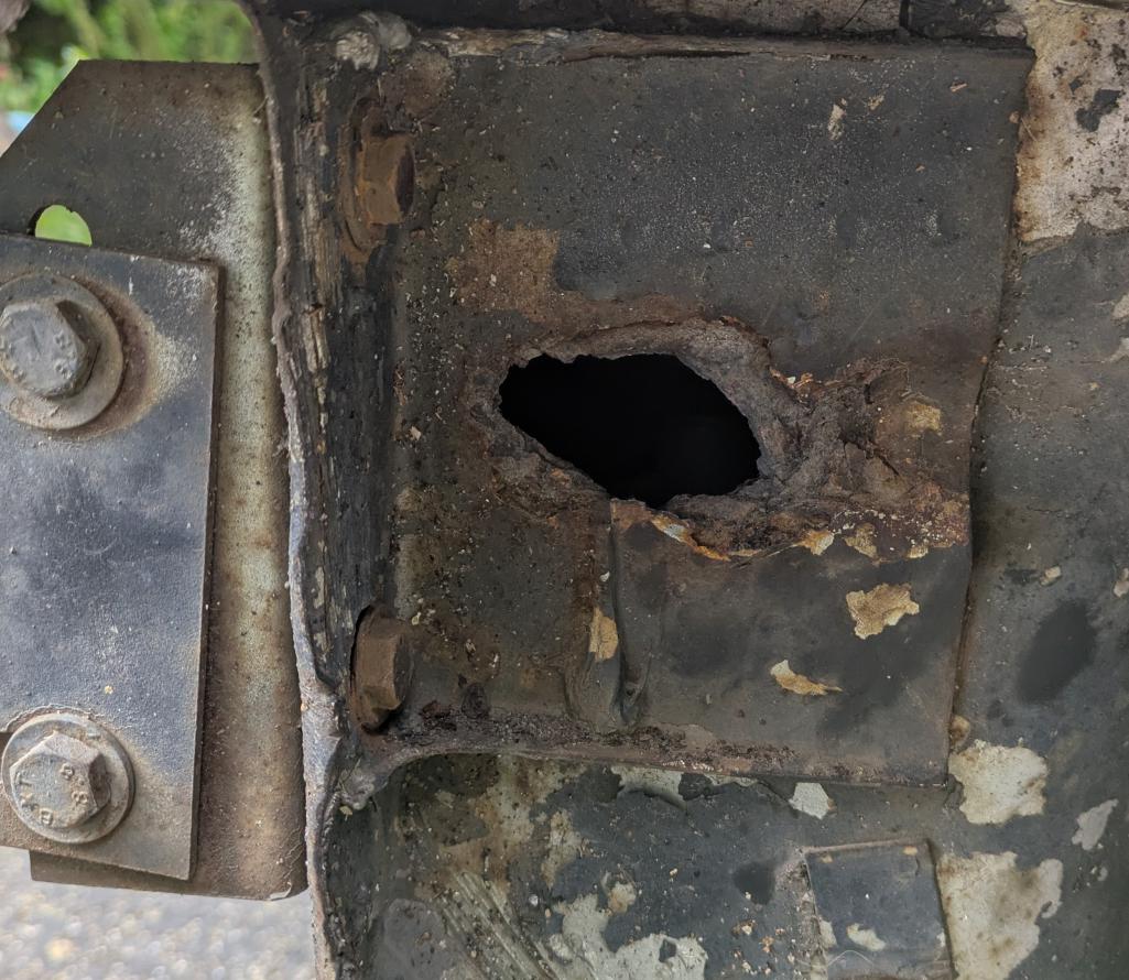

My son found some corrosion in a super stupid spot so I had to do my usual DACO repair. Nice thing about a chalon, you can do this kind of stuff and not feel awful about it. It's all about driving this car.
Some grinding, some rust transformer/inhibitor, and some random 14gauge I had laying around. The 120v resin core welder is ugly but it gets the job done. Some day I will treat myself to a gas rig...

I always use that obnoxious chrome silver paint so a future owner will always know where I was messing around....

Such a strange spot for rust to develop, the car is pretty clean otherwise.

And it's done. Just need some trim to set overnight and she will be ready for some sun tomorrow!
And a wash. It really needs to be washed.
