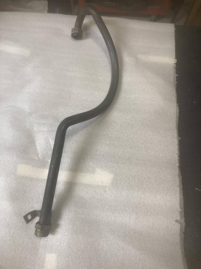

Looking for pics of correct six hard engine oil line attachment to engine. At this “age” so many variants …….trying to get it accurate so appreciate any pics that show clamps/bracket locations. TIA
post May 29 2025, 06:00 AM
Posts: 16,369
That's not a 914-6 line. That's for a 70s 911.

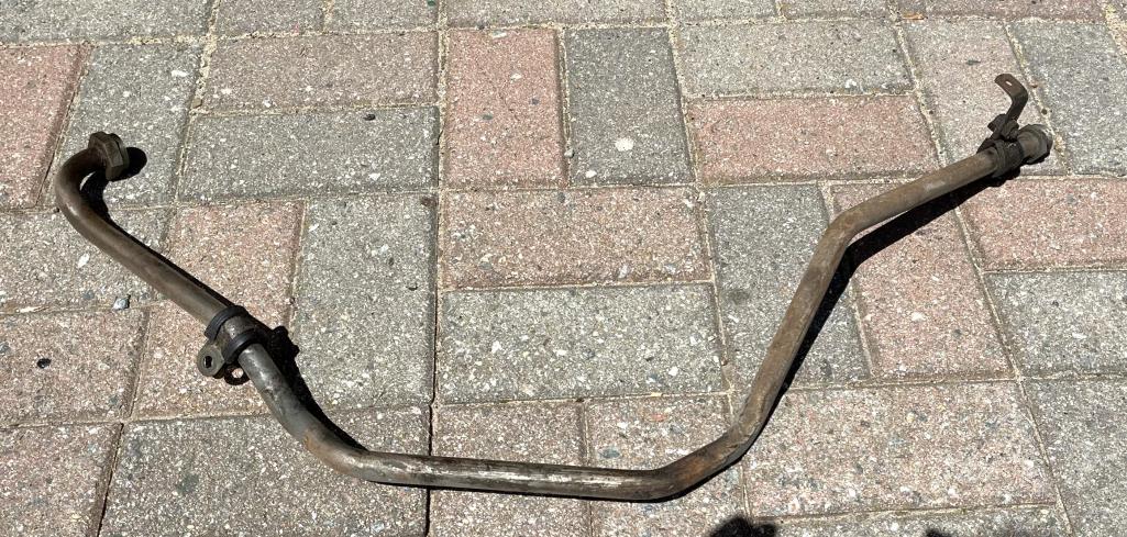

I have an extra hard line if you need it for the -6, I'll attach pics later this afternoon if you're interested (IMG:style_emoticons/default/beerchug.gif)

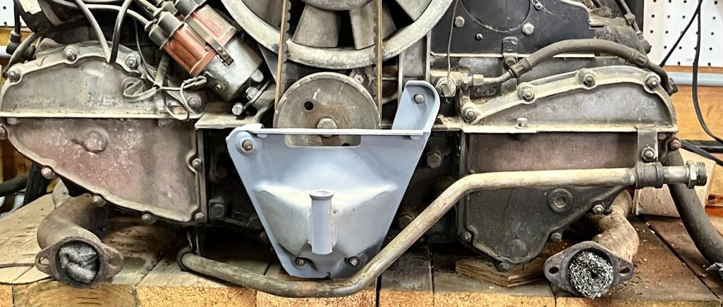

gandalf_025
post May 29 2025, 09:04 AM
Posts: 1,494
Joined: 25-June 09
From: North Shore, Massachusetts
Member No.: 10,509

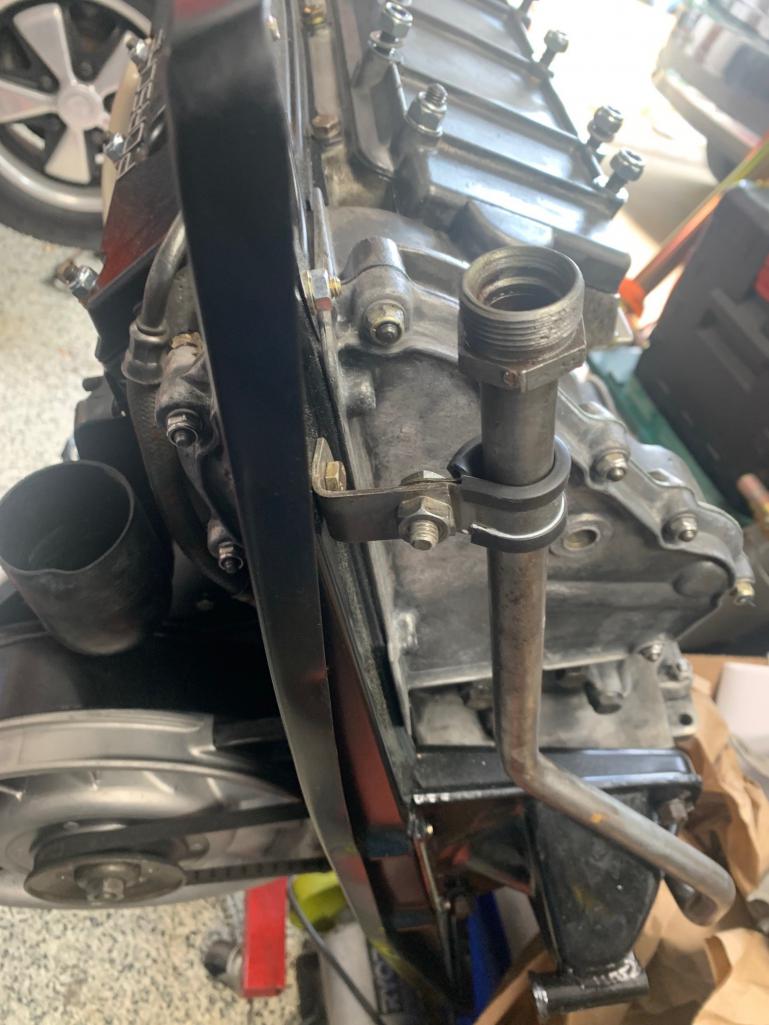

This is the one from my car….
Luke M
post May 29 2025, 09:22 AM
Posts: 1,411
Joined: 8-February 05
From: WNY
Member No.: 3,574
QUOTE(gandalf_025 @ May 29 2025, 08:04 AM) *
This is the hard 914-6 return line you want.

Sorry guys …head in wrong place.
Y’all are correct…picture was of 911 hard line I was selling.
This is for a factory six and just trying to see where it brackets mount to engine.

I was working on this VERY issue this evening,
I also do not have the attach point pictures and the factory manual does not show their placement in the pictures.
I believe the one with the right angle attaches at the engine mount lower left (the mount over the pulley) and the other is attached to the engine case towards the front.....
Unless someone else provide a picture I will get one that matches my guesses,,,,,,,

post May 31 2025, 07:32 AM
Posts: 4,750
Hey Terry
Gandalfs picture shows the correct mounting hardware perfectly.
The larger clamp on the left attaches to an 8mm stud on the right chain
housing.
The other clamp with the small 90 degree bracket attaches to the front engine
tin in front of the left chain housing.
Rory

QUOTE(rgalla9146 @ May 31 2025, 07:32 AM) *
Hey Terry
housing.
Rory
Rory, you are awesome, kinda figured this out - though - not quite sure, going to bolt it together now

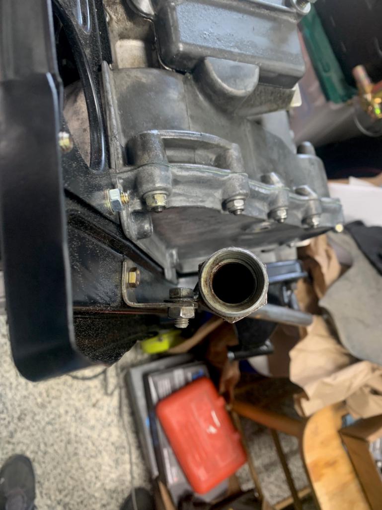

gandalf_025
post Jun 1 2025, 07:26 AM
Posts: 1,494
Joined: 25-June 09
Member No.: 10,509
I’m a little late Cary but something like this…
post Jun 1 2025, 07:29 AM
Posts: 4,113
QUOTE(gandalf_025 @ Jun 1 2025, 07:26 AM) *
better late than never, thanks for posting. this is great information

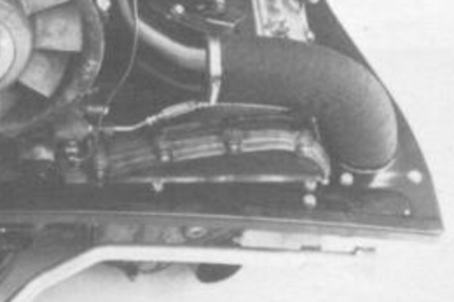

sixaddict
post Jun 1 2025, 09:27 AM
Posts: 942
Joined: 22-January 09
From: Panama City Beach, FL
Member No.: 9,961
Thanks to all ….Finally found the pic I needed. (IMG:style_emoticons/default/beer.gif)
post Jun 1 2025, 04:43 PM
Posts: 10,863
From: Life Elevated..planet UT.
As per factory, the L bracket attaches to the sheet metal..
ctc911ctc
post Jun 1 2025, 05:56 PM
Posts: 1,146
Joined: 9-June 18
From: boston
Member No.: 22,206
QUOTE(sixnotfour @ Jun 1 2025, 04:43 PM) *
Here is how I attached it - I believe that the "L" bracket attaches UNDER the tin.
- Lo-Fi Version Time is now: 2nd June 2025 - 06:50 AM
