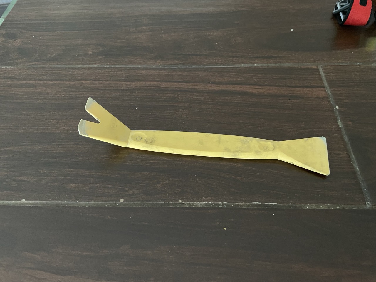

Just did this a few weeks ago…forget the push pull! It doesn’t work. Get this plastic tool from harbor freight, it comes with a set of 4 for less than 10bucks. Use the soft soap as instructed above, but put the seal all the way in the track on one side. Look closely at the rubber seal and you will see that one side( I think it’s the side that faces out of the car) it has more involved shape with more curves, that’s the side you install all the way. Then use that tool to work in the opposite side while pushing against the side that’s already in. It will go in easily about a half inch at a time. I had to completely disassemble the tracks on both sides of the Martha top and bend the tracks to accommodate the seal to fit properly against the glass when completely rolled up. It took about 3 times on each side, so I had to find a better way! It really is easy with that tool, it doesn’t scratch or bend anything and for some reason with the angle of the tool on the side with the two fingers, it just works that rubber right in. Hold the tool with the fingers facing down and use only one side of the fingers to work it right in. Don’t forget the SOAP!

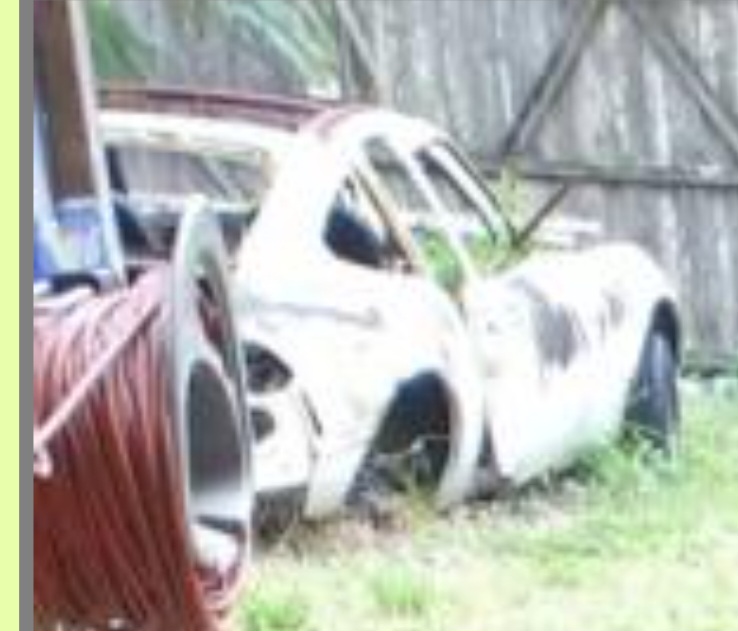

That was one of 3 different Opel GTs that I had. My neighbor drove me crazy for 3 years wanting to buy it, so I finally ended up selling it to him. That white one was just a parts car I stole the roof off of and some other miscellaneous parts from. The one that I sold to him was a prostreet frame, 4 link tubbed rear end set up, with a 347 stroker forged motor. It had all kinds of custom metal work done to it, including metal lower flairs, brake cooling induction…ect. It was only partially done and he still hasn’t finished it last time I talked with him. He moved last year so I don’t see it anymore.

If you look at the picture below that one, you can see the one I’m talking about. It was Very slick looking with all the metal work. I wish I wouldn’t have sold it now, but I had so many cars in the yard…and well, cash always talks.
