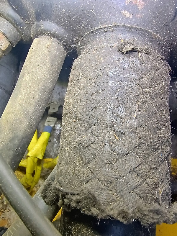

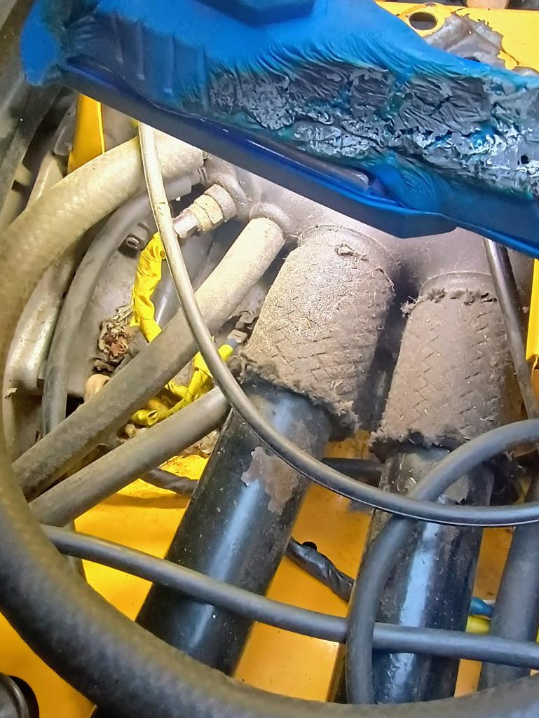

Member No.: 21,338
For folks don't know where the Three Groung Thingie.
Root_Werks
post May 28 2025, 12:56 PM
Village Idiot
Posts: 8,692
Joined: 25-May 04
From: About 5NM from Canada
Member No.: 2,105
Zoinks, the wiring in the picture looks sketchy at best.
Check your grounds, they seem to cause all sorts of issues.
