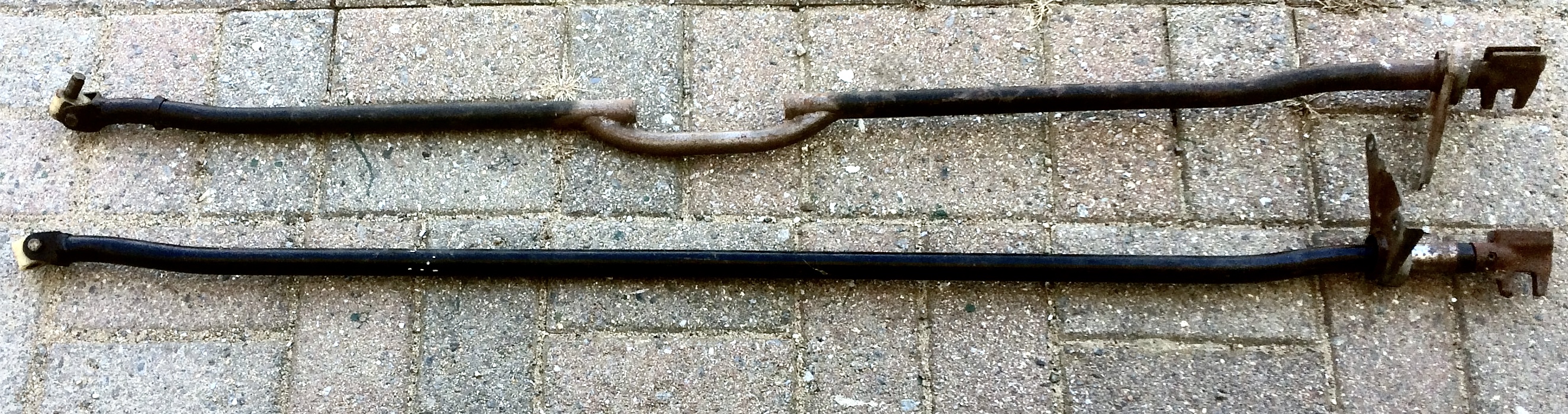

Many years ago I put a 1965, 911 engine in my 6…
Talk about shift rod interference..
I was lucky and the shop I was doing the swap in had a shift rod
that was modified by the previous owner..
Here is an original and the modified one..

QUOTE(gandalf_025 @ May 26 2025, 02:20 PM) *
Which one is factory?
gandalf_025
post May 27 2025, 02:42 AM
Posts: 1,494
Joined: 25-June 09
From: North Shore, Massachusetts
Member No.: 10,509
Straight one is the factory one.
The early aluminum engine cases
stuck further down than the he later mag cases.
