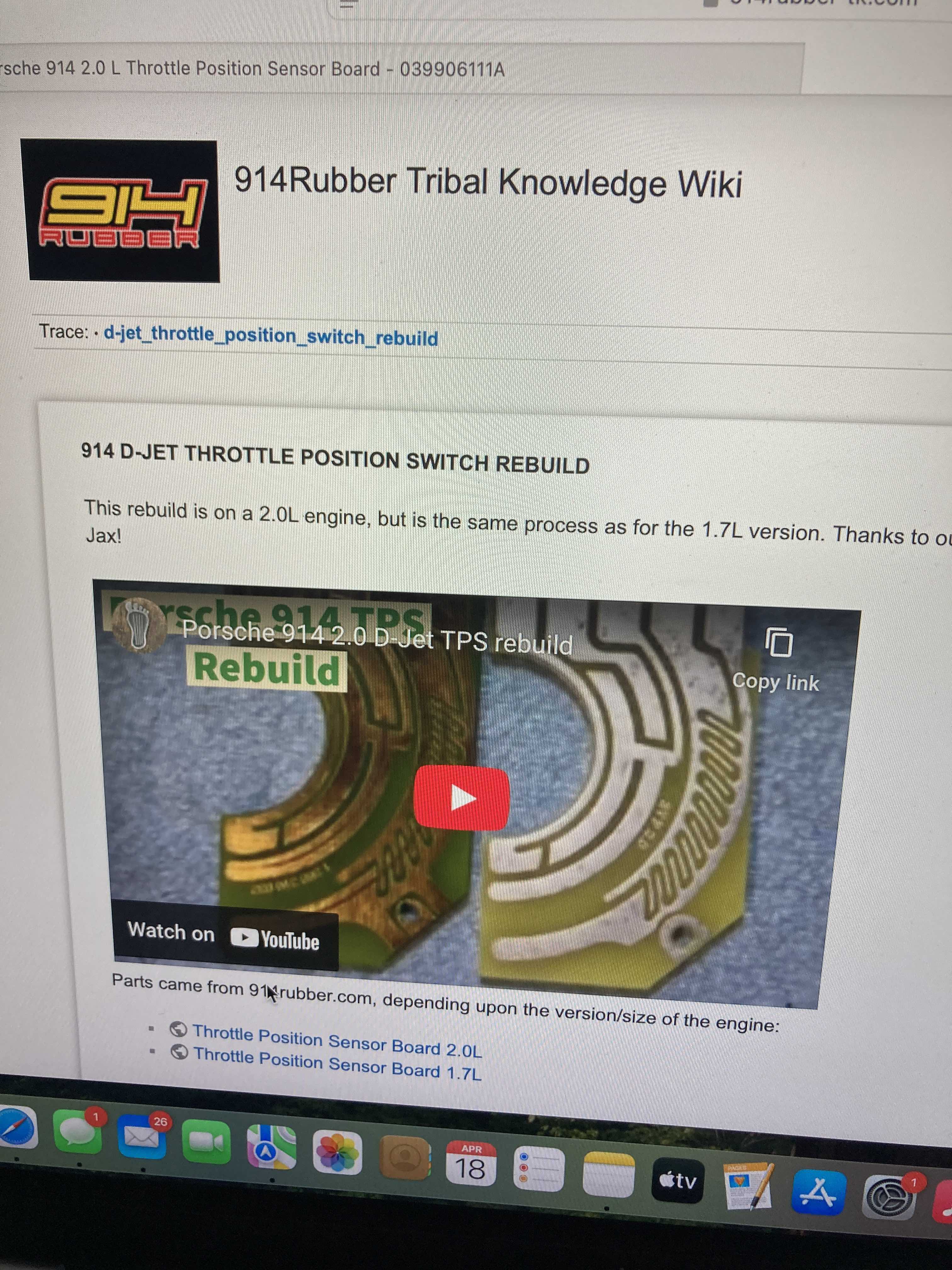

It's quite possible the TPS is not adjusted properly. It's one of the few things I haven't adjusted from the previous owner. My plan, when I replace the TPS board, is to just remove the whole throttle body from the car and adjust it on the bench before reinstalling.
Anyone got a link to the TPS adjustment procedure?

Hi Bill ,
It's on the 914 Rubber TPS purchase page. Its in the installation section for the TPS

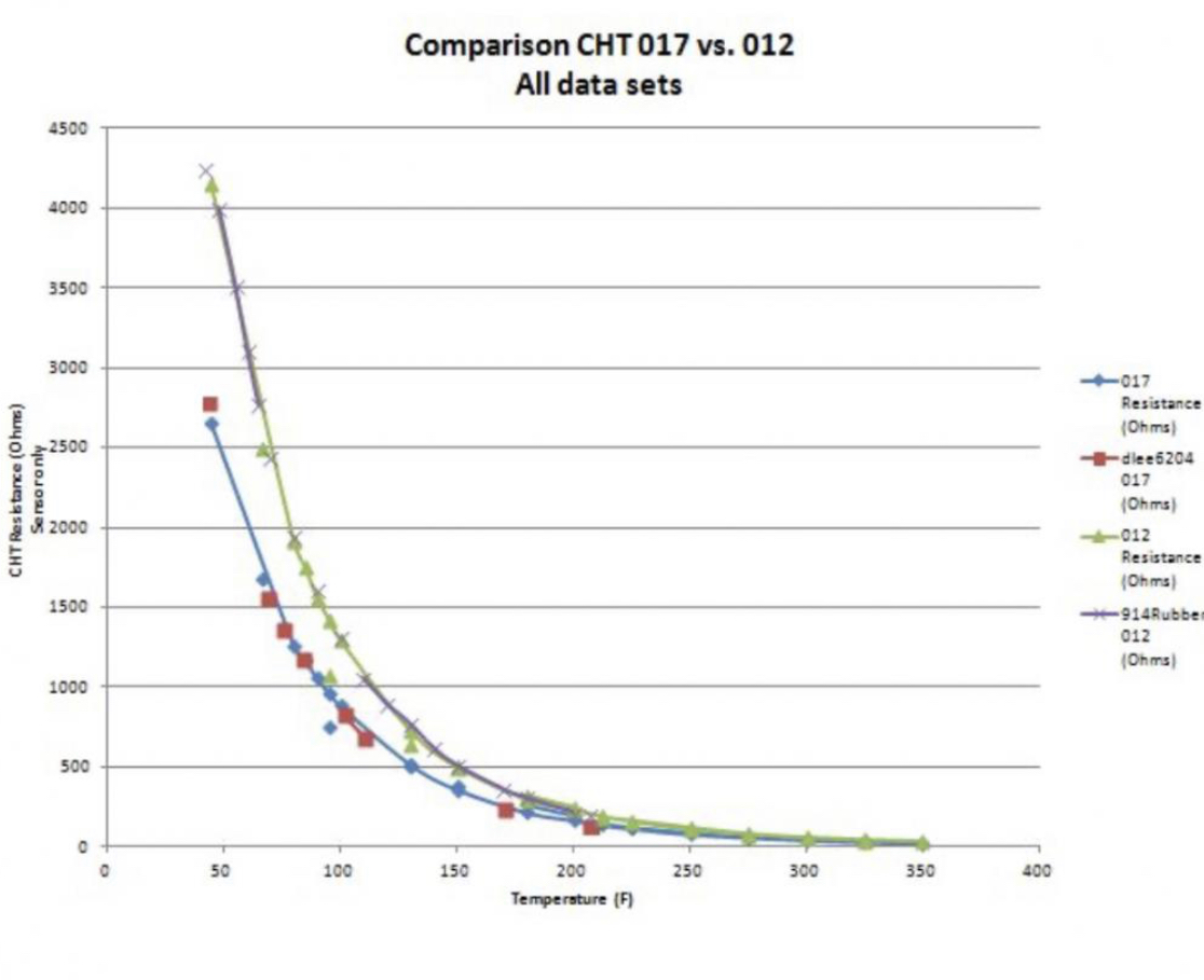

Known issues: it has the wrong CHT sensor (it's the one that's commonly available) and I think the TPS board has worn traces. I finally found the right CHT and ballast resistor, and I also have a 914Rubber replacement TPS board, and I will install both of them when I get a chance. However, I don't think either of those should keep it from idling at a reasonable RPM.
Incorrect
The 012 CHT forces an overly rich condition until the engine is hot which is totally consistent with you having to give it enough air to keep running. Then once it’s hot (200F) it’s forcing a lean condition if you don’t have the 270 ohm ballast resistor in place.
Get the correct CHT and ballast resistor in it then reevaluate
All data below is the CHT sensor only (no ballast resistance included)

So, I installed the 017 CHT and 270 ohm ballast resistor. I also replaced the circuit board in the TPS and adjusted it according to the video on 914Rubber. Unfortunately, drivability is worse (now has a big part-throttle stumble), and I still can't get it to idle down where it should.
