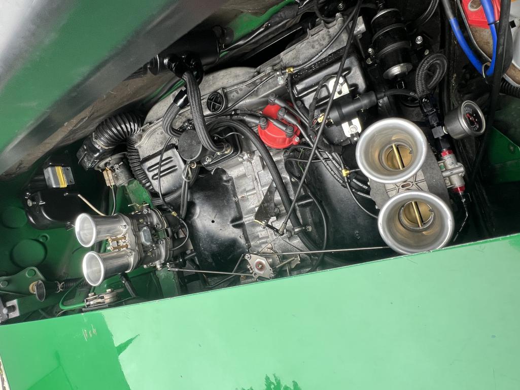

Hi everyone,
My 75 is ready to drive again. I fixed the oil leak from the main seal a couple of weeks ago and all is good. As I continue to do the shake out of the car, since I'm on the tail end of the restoration, I've had one problem the entire time and I need to get it fixed now. Cold or hot, as I'm driving there's a flat spot when I shift between gears. It bogs and then picks up again. It's particularly noticeable from 1st to 2nd and 2nd to 3rd. Sometimes even when starting for a dead stop. I know NOTHING about carbs but I'm willing to jump in. Does anyone have any experience with these symptoms? Is there a write up on the world that I've missed? Would anyone be willing to work for high end craft beer and good pizza (along with an hourly rate) (IMG:style_emoticons/default/smile.gif) I'm in north county inland San Diego (Valley Center) Mike |

First thing I'd check is if the accelerator pump circuit is working on both carb.
Operate linkage while looking down carb bores. Should see a squirt. Old version IDF have a linkage that can be misaligned which might cause this. New version has an adjustable rod linkage that cannot disconnect (without parts loss) but CAN be adjusted down to the point of almost no spray. |

1st we need to know what jets are in there now. Pull one from the side (idle jet), pull the top stack (main, air, emulsion). If these are brand new Weber IDF or even old stock ones you are probably running something like this: 50 idle 115 main 180/200 air (can't remember which one came factory) F11 emulsion 28mm venturis The 2nd item that is needed is an AFR gauge. I usually use an AEM UEOG wideband, but you can use whichever you like. They even have a fancy bluetooth one that shows on your phone so no need for an additional pod. You will need to have a bung welded into your muffler or exhaust. Preferably both sides, but one in the muffler should suffice. There is another option in LM2 (if memory serves) that connects to the end of the muffler tip to get a reading on AFR. Never used that one. OR you can just keep making minor changes until it "feels" right, but you could be overly rich and not know it. |

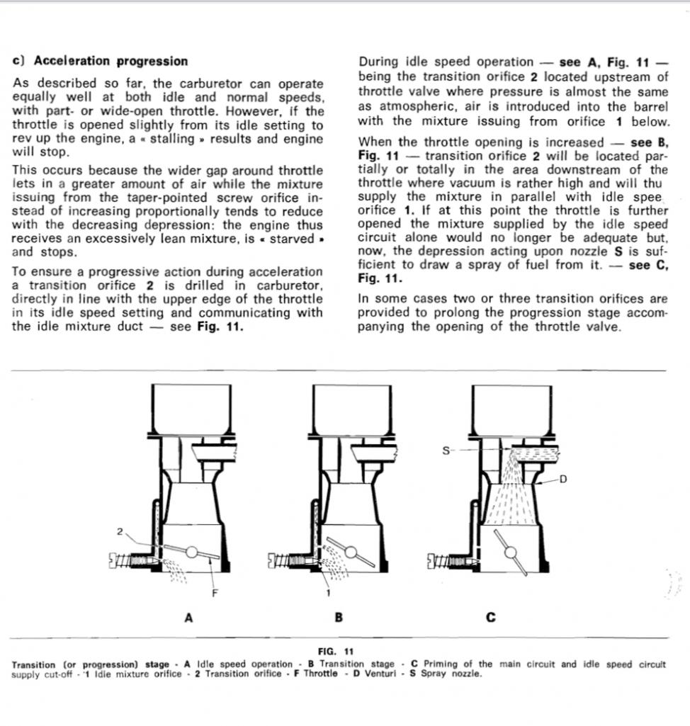

One thing that is critical to tuning IDF’s is to understand the transition ports and that in light throttle / light load you are running on the idle circuit and transition ports more so than the mains.
Take the time to read the Weber tuning manual to get a baseline understanding of the transition ports. The manual isn’t specific to IDF but the principles are the same. https://www.lainefamily.com/images/WeberTuningManual.pdf |

A great tip that John from ACN told me was to remove the main stacks and drive the car around (caution no big inclines) You get to feel where the idle port drops off. The car will fall on its face. This gives you an idea of your idle jetting and the transition to the nonexistent mains.

Drilling new progression holes is a last resort and not for the home mechanic unless you have a mill to put them in a precise location in each barrel.
Spanish version Weber 45 DCOE's of the mid 2000's were notorious for this particular progression problem and the only solution was to drill an extra progression hole exactly like the original Italian 45's. You might Google for pictures of 40IDF progression holes in an original Italian version and compare to your carbs. |

Need the Venturi size too!!
Very often the venturis shipped in IDF’s are too large for good street driveability and lead to bogging similar to your description. |
