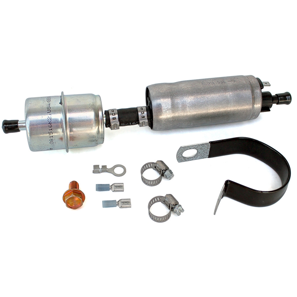

This is the pump i had on my 2056:
https://www.cbperformance.com/product-p/319...e7z9AA76ZhCfxII
Quiet with a filter and built-in regulator.

Thanks everyone for replies. On the CB Performance pump in the attachment of one reply, it says it runs at 3.5 psi, which another commenter said was to high (wrote it needs to be lass than 3). Is the extra 0.5 psi a concern?

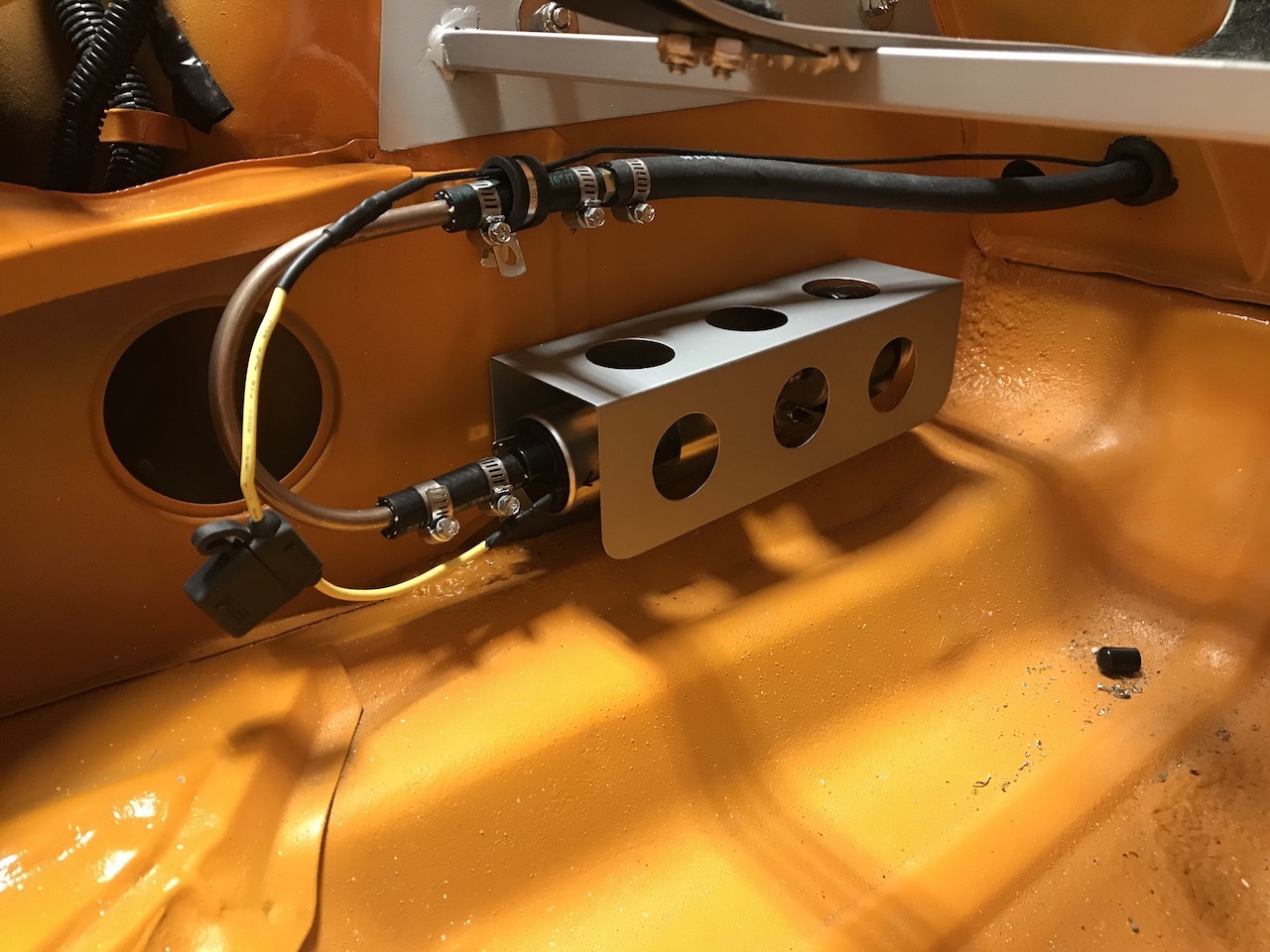

Most by the steering rack or under the tank. I put mine more up front for easy access under a modified fuel tank. Should be in the push position. Best, markAttached Image
