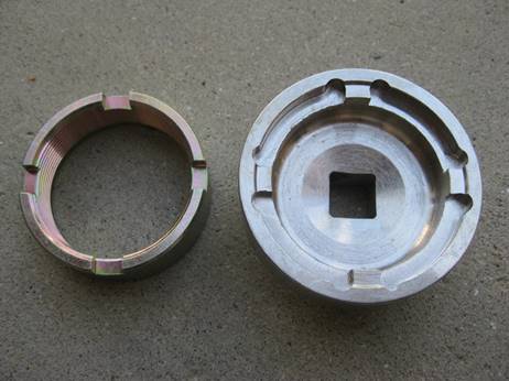

The more important thing to make install easy is to have the proper ball tool for the threaded collar.
I prefer to have the control arms on the car. That way you have something to torque against. That also allows me to use a jack to keep some upward pressure on the ball joint tool while I’m torquing the collar which keeps it from slipping off the collar.

Thanks for the tip. I have the P280B Ball Joint Nut Socket made by Jimmy Tidewell.
So you do ball joint to control arm on the car? Then the strut.
As opposed to ball joint to strut off the car, then connect to control arm on the car.
I am probably overcomplicating it. I just have limited time with the car, so I try to plan everything in advance as methodically as possible.
