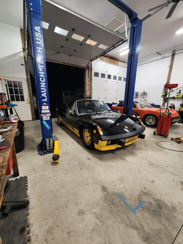

jhynesrockmtn
post Sep 26 2023, 07:22 AM
Posts: 437
Joined: 13-June 16
From: spokane wa
Member No.: 20,100
Thanks for the replies. It is done. Quite the learning curve with these. The driver side was done first. It looks ok if you don't look too close :-) Passenger side went way faster and looks better. I'm not generally a patient person and this requires a fair bit of deep breathing, measuring, not rushing bubbles out, more measuring, more deep breathing. The wetter the better.
