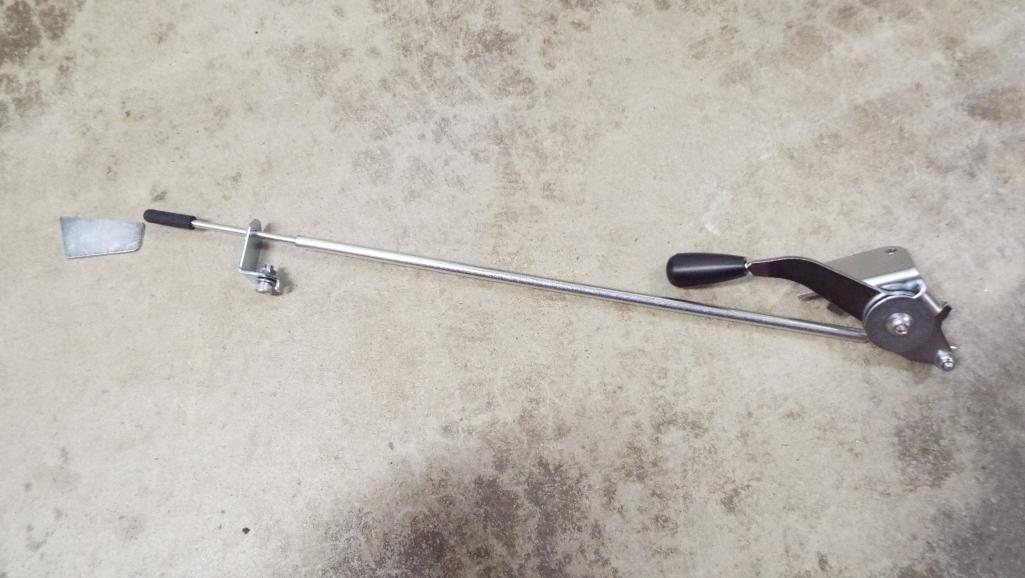

Yes, mine works perfect with a 2056, mild cam and twin 40IDF carbs. I got the kit from one of our suppliers and I recall making a few modifications.

914 Rubber sells the kit. (IMG:style_emoticons/default/beerchug.gif)

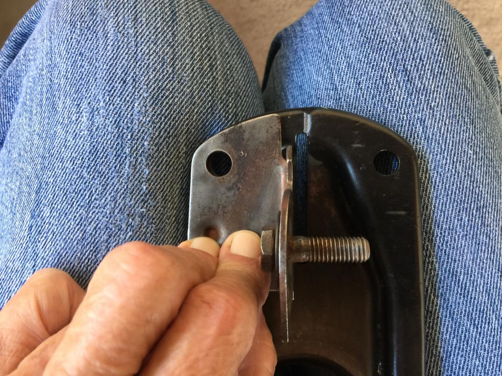

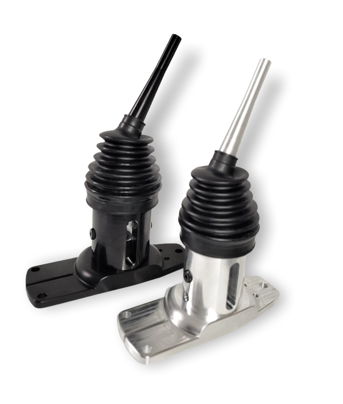

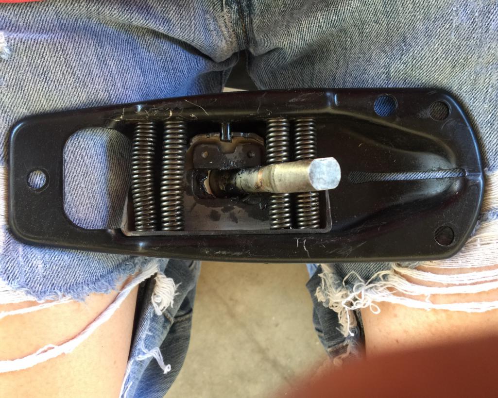

I do not think mine has a slot? Will one have to be cut? Saw for mill?
post Sep 20 2023, 09:01 AM
Posts: 3,592
QUOTE(rfinegan @ Sep 20 2023, 06:53 AM) *
I got this pic off the internet. Looks like they may be cutting them now for a hand throttle.
There is a dimple, Like an alignment pin. So a small cut and an extra hole. Or half a hole, that is pretty thick material.

Cool! might be time to go to a short shift kit, i was thinking of doing this and the Chris Foley mod at the transmission console shifter bushing too.

I need to either cut my OG Rennshift base or see if I can buy just that part from @JWest .

That is what I did. Knocked it all out at the same time. Added a couple springs , a quick shift and built the hand throttle. I’m doing my own trans console mod with steering parts and a chunk of aluminum. Need a machinist for the actual console shaft for OD and cone screw.

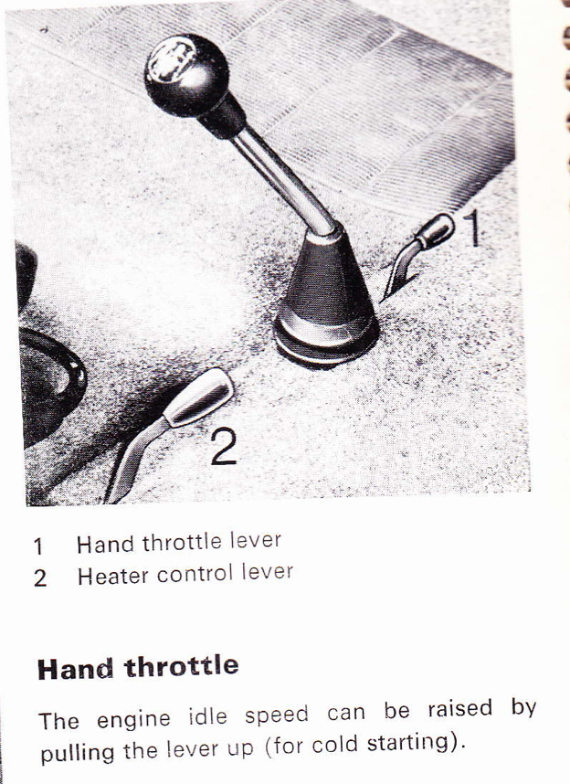

QUOTE(Geezer914 @ Sep 20 2023, 04:11 AM) *
Purpose of a hand throttle? Just for warm up?
FWIW - Here's the applicable section from the 914-6 Owner's Manual.

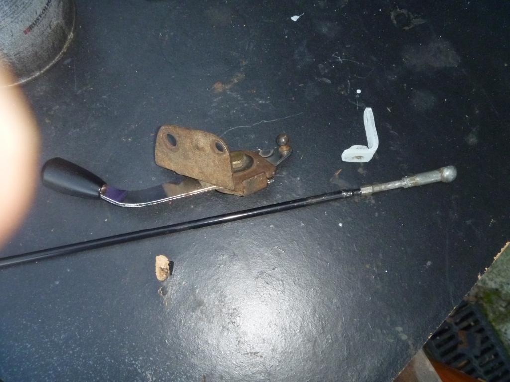

Handy to have ,I normally set it to around 1200rpm but usually not for long as my engine warms up fast ,must be a 911 thing ? ,also helpful with tuning carbs.
Made mine up out of bits and bobs, spare heater control lever, fitted a ball end stud to the lever and threaded ball cup from an old T4 carb linkage to a piece rod,the metal piece copied from a pic of an original "6" throttle lever ,the guide for the rod made up as per original also .
Good useful project that cost me nothing but they are a bit of a PITA to final fit.

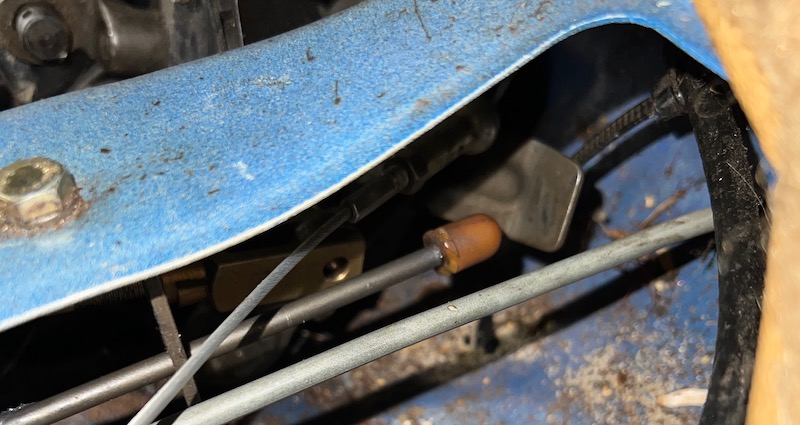

I am trying to figure out how this can hold the throttle at a set rpm yet not effect the operation of the gas pedal???
Rob-O
post Sep 22 2023, 05:58 AM
Posts: 1,320
Joined: 5-December 03
From: Mansfield, TX
Member No.: 1,419
It does affect the gas pedal. It’s connected to the gas pedal fulcrum.
post Sep 22 2023, 06:55 AM
Posts: 3,592
QUOTE(Geezer914 @ Sep 22 2023, 04:36 AM) *
In the pic you can see the lever and the rod. Looks like this rod may have a rubber cap. Then you see a piece of metal tab in a particular shape. That piece is welded to throttle assembly. The rod only pushes up against that tab. If you hit the throttle the tab pulls away from the rod. They are not connected.
DennisV
post Sep 22 2023, 08:04 AM
Posts: 1,030
Joined: 8-August 20
From: Santa Rosa, CA
Member No.: 24,575
QUOTE(Shivers @ Sep 22 2023, 05:55 AM) *
Here is a photo of where the rod hits the tab when it's installed.
