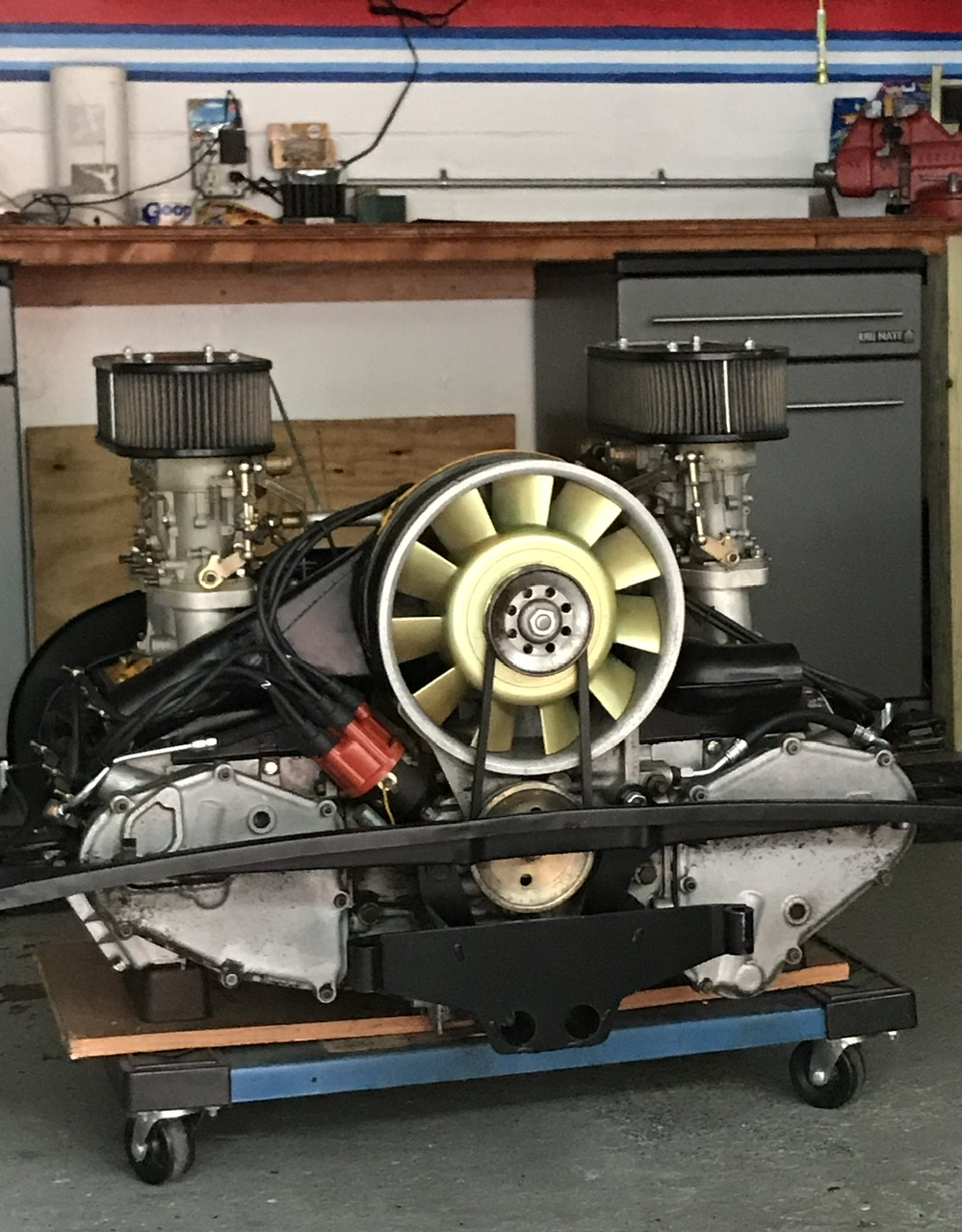

Hey Fellas , so I’m getting close to starting my 2.4L. I’ve read that the original 6 takes 9 quarts. Mine is slightly larger as stated. I want to start adding oil to the system. Not only to look for leaks but want to get some in the block so I can rotate her without fear of
scuffing up metal that shouldn’t. I know your supposed to check when hot and running.
How much would you add at first. Any starting procedure tips. It is carbed and does NOT have a front cooler. Appreciate any insight and experience.
Cheers, Dion

We put 10 qts in my brothers 3.0 6 conv with an org 6 tank. I put some oil in the engine oil cooler before mounting it on the engine. Front oil cooler is not hooked up yet. Seamed to read a little on the high side once we got it running.
post Jan 14 2022, 07:13 PM
Posts: 10,798
I usually put about 9 quarts in my car and then take it for an easy drive to get it hot and make sure the oil cooler thermostat is open and then I checked it and top it off. I would guess about 10 to 11 quarts. I am guessing as I can never really get all of the oil out of the system.
post Jan 14 2022, 07:19 PM
Posts: 7,832
9 qts. Start car and run until 180. Check oil level and top off as needed. This is assuming you have no external oil cooler
post Jan 14 2022, 08:20 PM
Posts: 5,014
Hey Dion
From empty I'd put in eight quarts and crank it with plugs out till you see the oil
pressure light go out.
Crank it once or twice more till light goes out each time.
Install plugs and start engine.
Add oil at idle until it touches the dipstick.
Allow engine to reach operating temperature.
At operating temp, at idle, on flat ground add oil untill it reads half way between
the bottom line and top line on the dipstick. Done.
Looking good, keep up the good work.
Rory

Thanks guys for all the tips! Ok, will go with the 8qt. and proceed with caution. Thanks Rory.
I don’t have any coolers other than one on engine. So no guessing on filling up extra hoses.
Another question…related to starting a dormant engine.
Do you fellas do anything particular with the carbs? Do
you let the pump do its thing or do you add any fuel to the carbs bowls pre cranking?
They are recently rebuilt Webers but were stored for 3 years, only receiving WD40 coating occasionally.
Thanks again!
