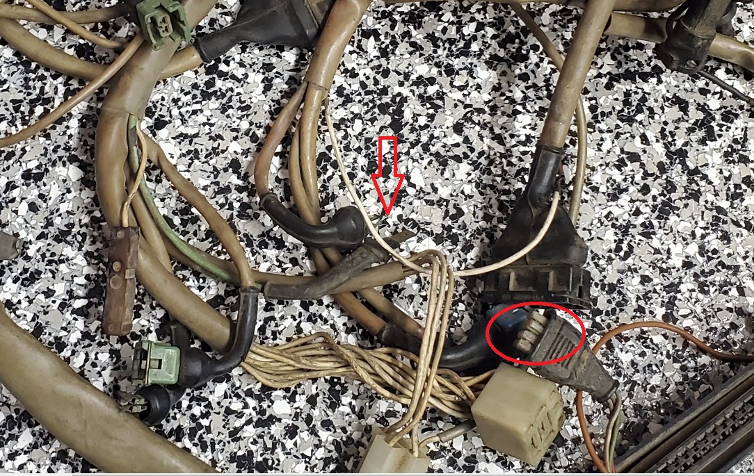

> Withdrawn: Engine harness 4 cyl 1.7(?)
post Jan 14 2022, 02:47 PM
Posts: 1,356
Incorrect part
Posts: 1,356
Other side
post Jan 16 2022, 09:49 AM
Posts: 16,568
That is the EFI harness for an L-Jet system. Used on 74-75 1.8L cars.
What is the asking price?
Clay
post Jan 16 2022, 09:53 AM
Posts: 9,368
An L-Jet harness? Yes.
914? I am doubtful. There are at least 3 of the connectors that are not standard 914.
post Jan 17 2022, 07:59 AM
Posts: 1,356
Just catching back up with this thread! Well i bought it from a guy who said it was for a 2.0 (i wanted a spare for the 75). Somebody else said nope its for a 1.7. Now jeff you are saying not even 914??
post Jan 17 2022, 08:43 PM
Posts: 9,368
Does not look 914 from those three odd connectors. Even if it were 914, only the 1.8L cars were L-Jet, not 2.0L.
Posts: 9,368
Double post
post Jan 17 2022, 09:57 PM
Posts: 1,356
Ok well will take this off the site then or if someone wants for like $50.

Not 914 as said above. The green wire with the single spade connector is for an O2 sensor and the circled connector was used with hall ignition distributors. My guess would be late 70's Vanagon.

Ok. Well will see what the guy that sold it to me says about it i guess. I am pretty sure he didnt intentionally sell the wrong thing.

QUOTE(ejm @ Jan 18 2022, 07:00 AM) *
Vanagon's did not come out until the 80s
