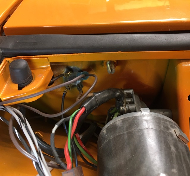

I have a pic of another 74 that has a bolt for a ground connection right by the headlights.
The wires floating free on mine are both brown ground wires. Attached Image

My '73 has Ground studs in the same place as pictured.

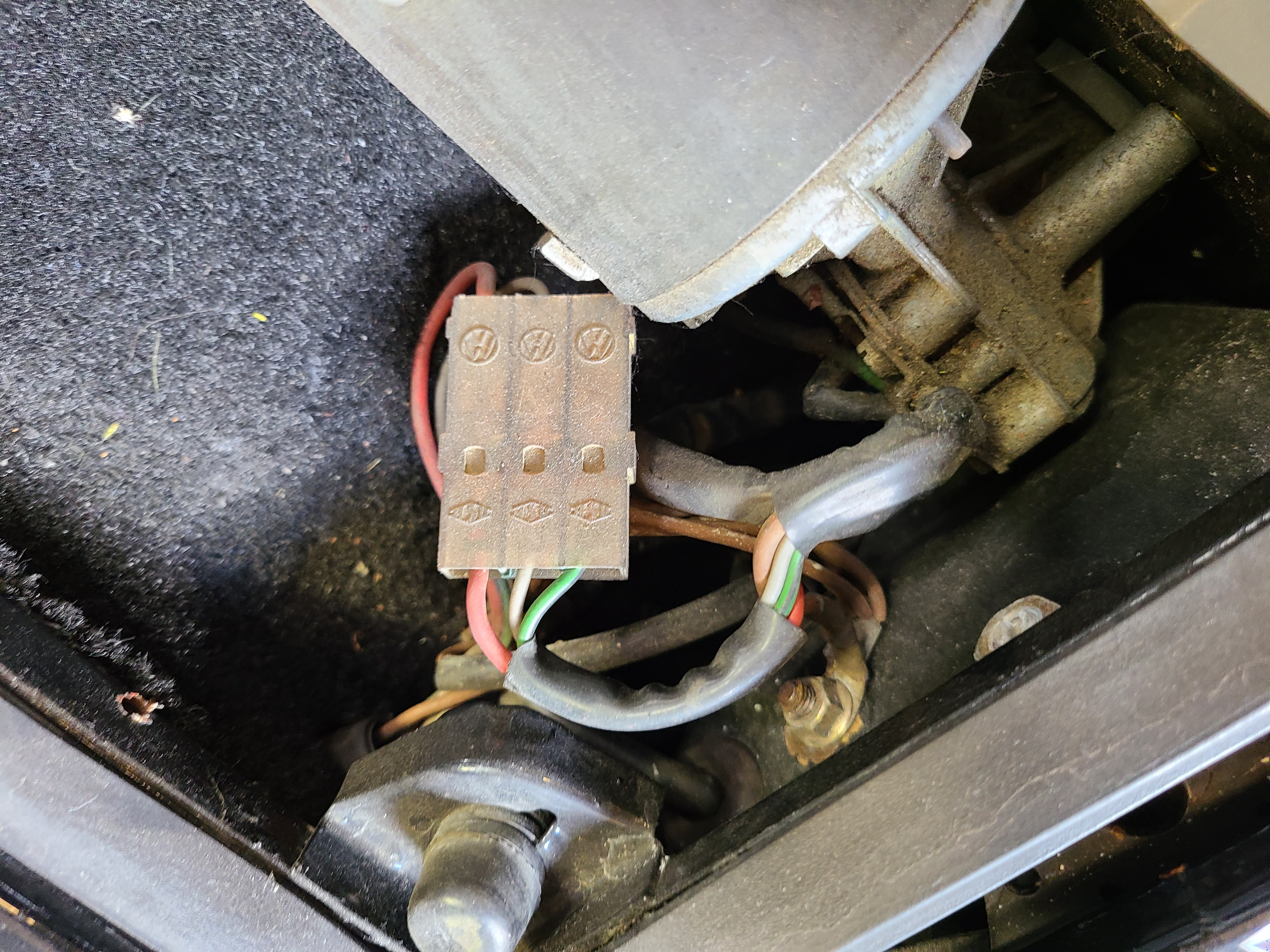

Are you looking for these ground tabs? this is a 76
