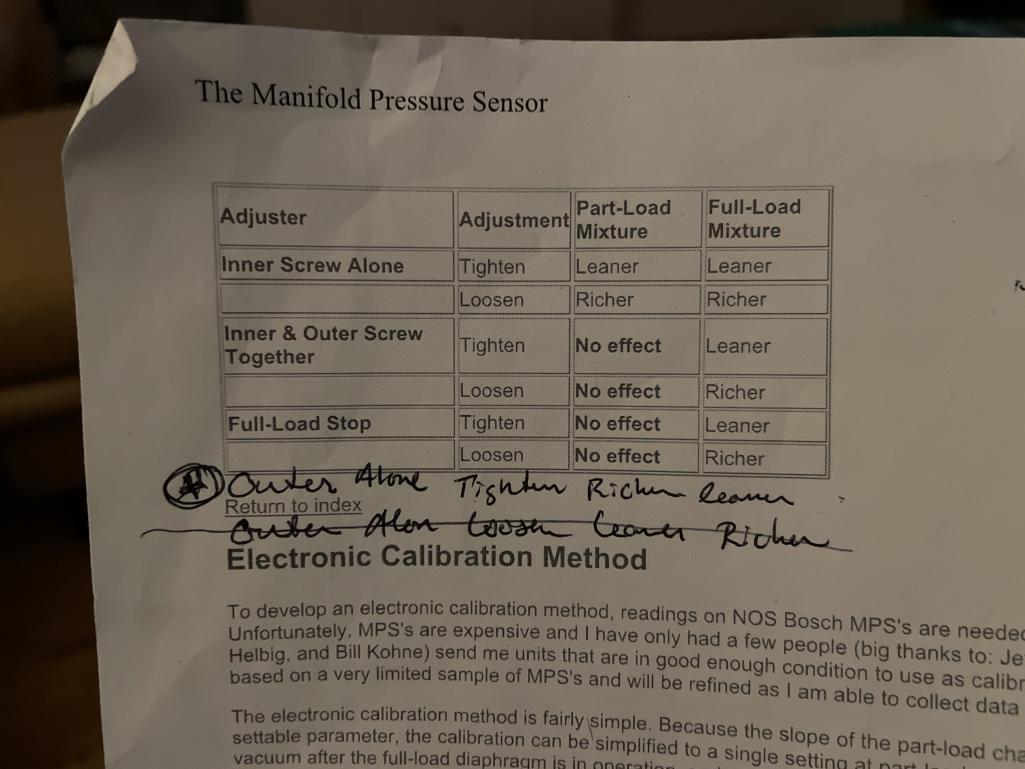

neither at this point - i had been using it with my stock motor, but with this one idle was so low with the vac retard hooked up ans using setting 3or4, i disconnected that and changed over to the non vac setting “C”, that’s been much better.
just went out for an hour of driving around and making some adjustments . after warming up, it was pretty lean across the board, so i adjusted inner screw out only, did this in very small increments then some driving etc, that got me out of the 14-15 range in part load down to 13-13.5, 12-12.5 on more of a full load or WOT. much better, ans seems still a bit rich on idle but if everything else is good i will leave it like this for a while and recheck plugs again after a few more drives. I am at about 35psi now for fuel pressure too and it definitely runs better with the FP at least 35-36.
There is not an easy way to just change part load, according to this chart.

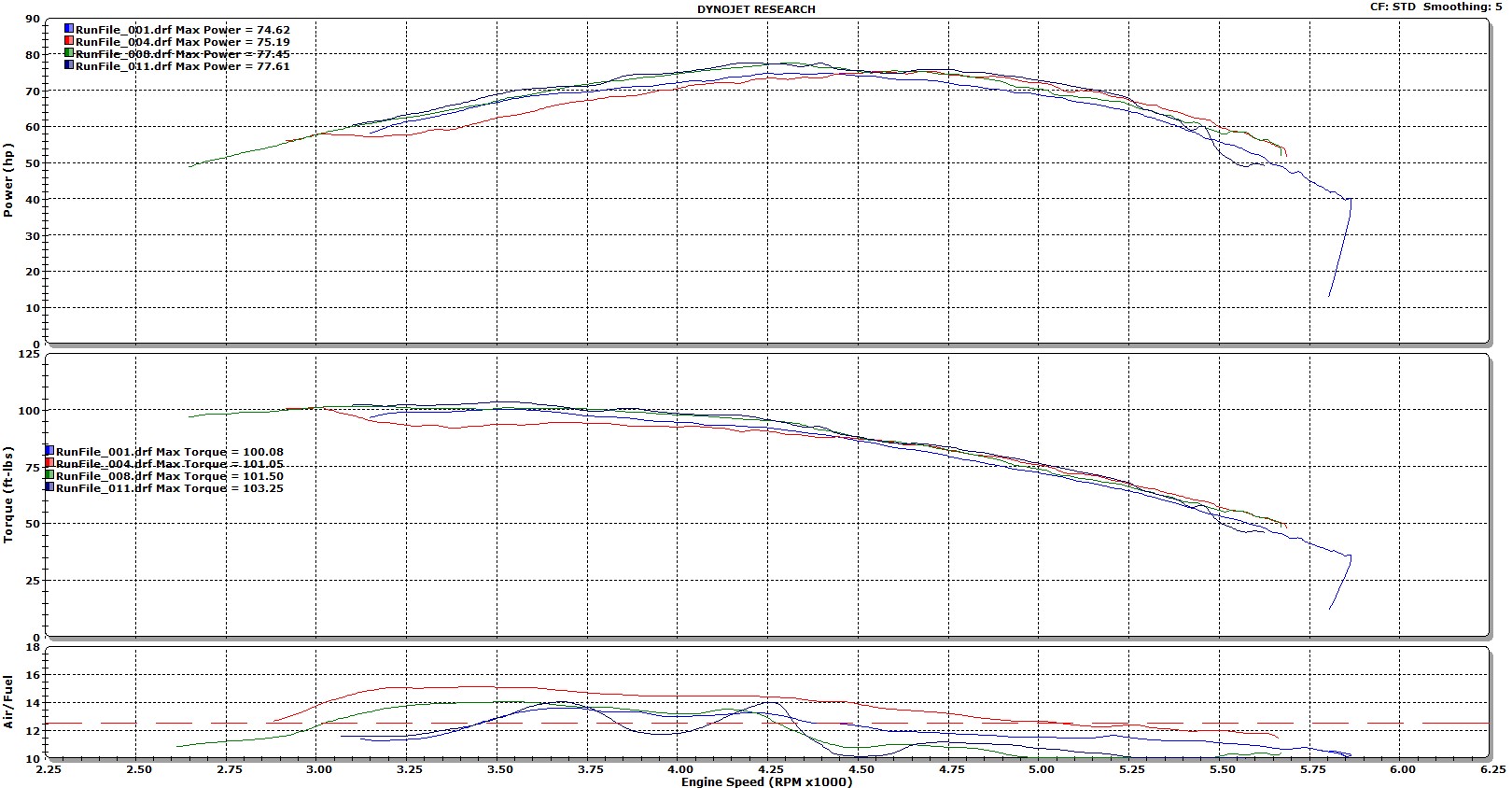

I really wish it were easier to change the part load and wot individually. I also wish at idle they would have really bypassed the MPS altogether. Not sure why they wouldn't. They have the TPS and the ECU knob. I guess on earlier years the knob isn't an option.
I think I need a vacuum gauge as well. I suspect changes in diaphragm position might be contributing to my strange lean early rich late WOT issue.
like i have written on that chart at the bottom, if you tighten the outer screw while holding the inner one, you will enrich the part-load and lean the full load out some and that sounds like thats what you need to do. would be so much easier to doe this while on the dyno rather than the stop go etc but thats what i did last night and am getting much closer to where i was. my mistake was thinking i could see that part load by just reving the motor sitting but thats not going to work you have to have some load. and if you get to the point of low and middle load and cruising is where we want it, but full load is off, then you can make a slight adjustment to the full load stop with out moving inner or outer screws.
way better to start off with it at least at the factory setting, and go from there.
also pull the plugs and see what they look like, thats going to tell you a lot too.

I have an LCR and as others have said, your mileage with it will vary. 150H was never even possible with my MPS. Really a range between 60 and 90 something. The numbers that pbanders puts up were impossible even with my stock MPS.
DrPhil, the problem is that afr readout in the dyno is WOT all the way. There is no partial throttle on there (we did that separately from a run). So that is WOT and the AFR changes as the motor is revving up to higher RPMs. As I richen the bottom the top gets way to rich etc. That is why I think I need to watch the vacuum as I WOT. If that is moving above what the MPS sees as WOT I could be moving into and out of partial throttle according to the MPS even though the pedal is to the floor.
I am looking at other possibilities though. I am going to put in a new coil etc. May retard the timing a bit too. Little steps of course and only one at a time.
