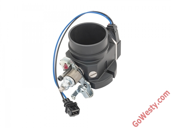

At this price point on the TB modification, I would seriously consider this one from GoWesty. I definitely like the sealed ball bearing for the throttle shaft. There might be a TPS/lever orientation issue ( I have read somewhere) but someone had gone around this problem. I think I had read it on STF. Obviously, this would mount on a Vanagon plenum which might be better for the 2270(?) (IMG:style_emoticons/default/confused24.gif)
https://www.gowesty.com/product/electrical/...e-valve-housing

$300 for a new TB ain't hateful. But you'd need to see if the TPS is swappable, as this is a single-mciroswitch Digifant setup.
They offer a "Gowesty Fuel Injection Component Replacement Kit" that uses a "All-new Billet Aluminum Throttle Body with modern TPS" so I'm guessing it could be converted...?
https://www.gowesty.com/product/electrical/...ement-system?v=

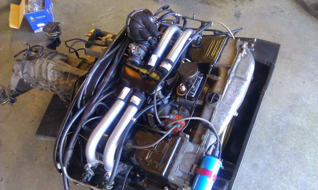

I believe @JamesM is running the Vanagon TB and plenum. I'd be interested in what's required to make that work. I can't find a good pic of one of those plenums, as I'd like to see what the vacuum outlet/port selection is like.
I think this is is rig. Very clean setup. But I can already see I'd probably have wiring harness issues with the way it's oriented.
(IMG:http://www.914world.com/bbs2/uploads/post-5834-1576449659_thumb.jpg)

QUOTE(BeatNavy @ Nov 27 2021, 11:35 AM) *
Throttle body is 2.1 vanagon, the plenum and runners though are 74 1.8 parts. Only modification made was using a tailpipe expander to open up the plenum to match the 50mm vanagon TB, and swapping the throttle arm from a 1.8 throttle body over to the vanagon throttle body for proper throttle cable orientation.
Using the Vanagon plenum is a bit more complicated as no 914 intake runners are a direct match to it.

I have one of these on the bench waiting to be installed this winter as my motor is needing even more air than the 50mm vanagon TB can provide. The throttle arm is in the wrong orientation and needs to be swapped and due to the design of the TB itself it is not as straight forward a swap as using a stock 2.1 vanagon TB. The GoWesty unit however is 52mm and uses a flat throttle plate as opposed to the 2.1 vanagons tapered thottle plate that creates some restriction at WOT.
Its a really nice piece, out of the box its actuation is buttery smooth.
