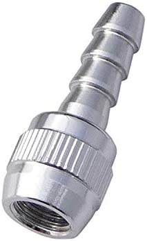

I do have the 914Rubber hose kit installed and everything seems to be working well except the slow leak at the tire fitting.
This system does share parts with other VWs but so far the closest I've come is used hoses that include the fitting for $40 or more. That's too steep of a price for a used part that might not be any better than what I have. If I could find NOS at that price I might for it.

Hmm. I wonder if that hose would stretch over a 1/4" barb. Not exactly stock but... (IMG:style_emoticons/default/idea.gif)
(IMG:http://www.914world.com/bbs2/uploads_offsite/images-na.ssl-images-amazon.com-20845-1612846290.1.jpg)

QUOTE(bbrock @ Feb 8 2021, 08:51 PM) *
It may. WE made our hose out of a moldable rubber that if you put it in hot water will soften it up. You can push over the barb when hot and it will seal nicely.
