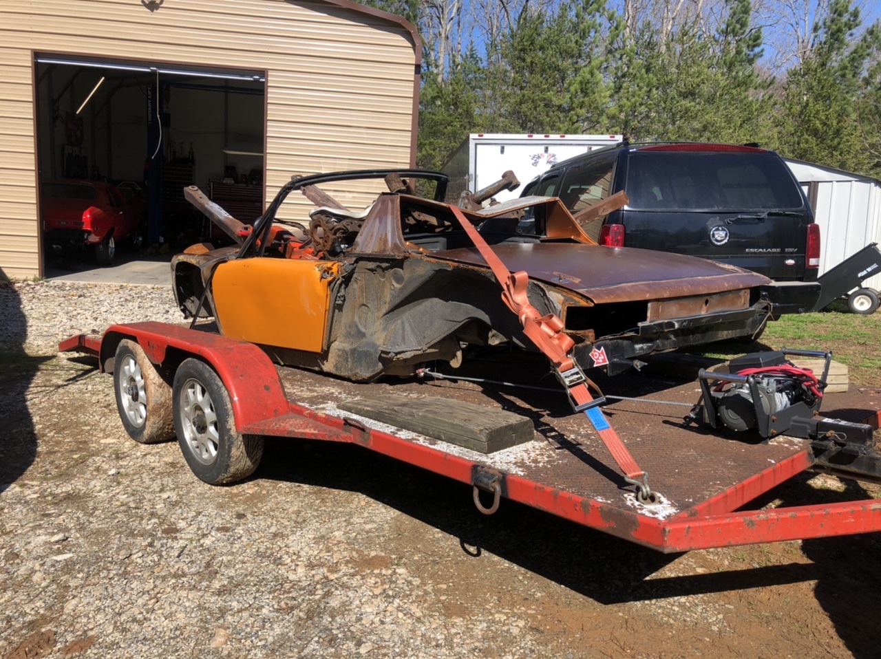

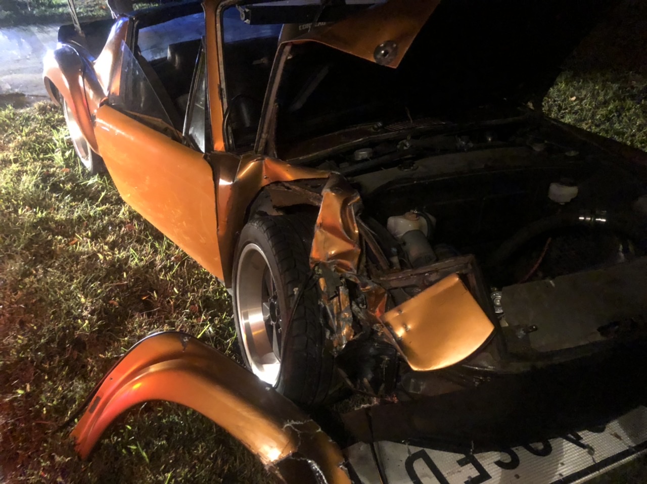

OG car:
The Crash:
Whats Left:
I dont have many parts left, I took all the good parts off sold what i could and kept what i needed.

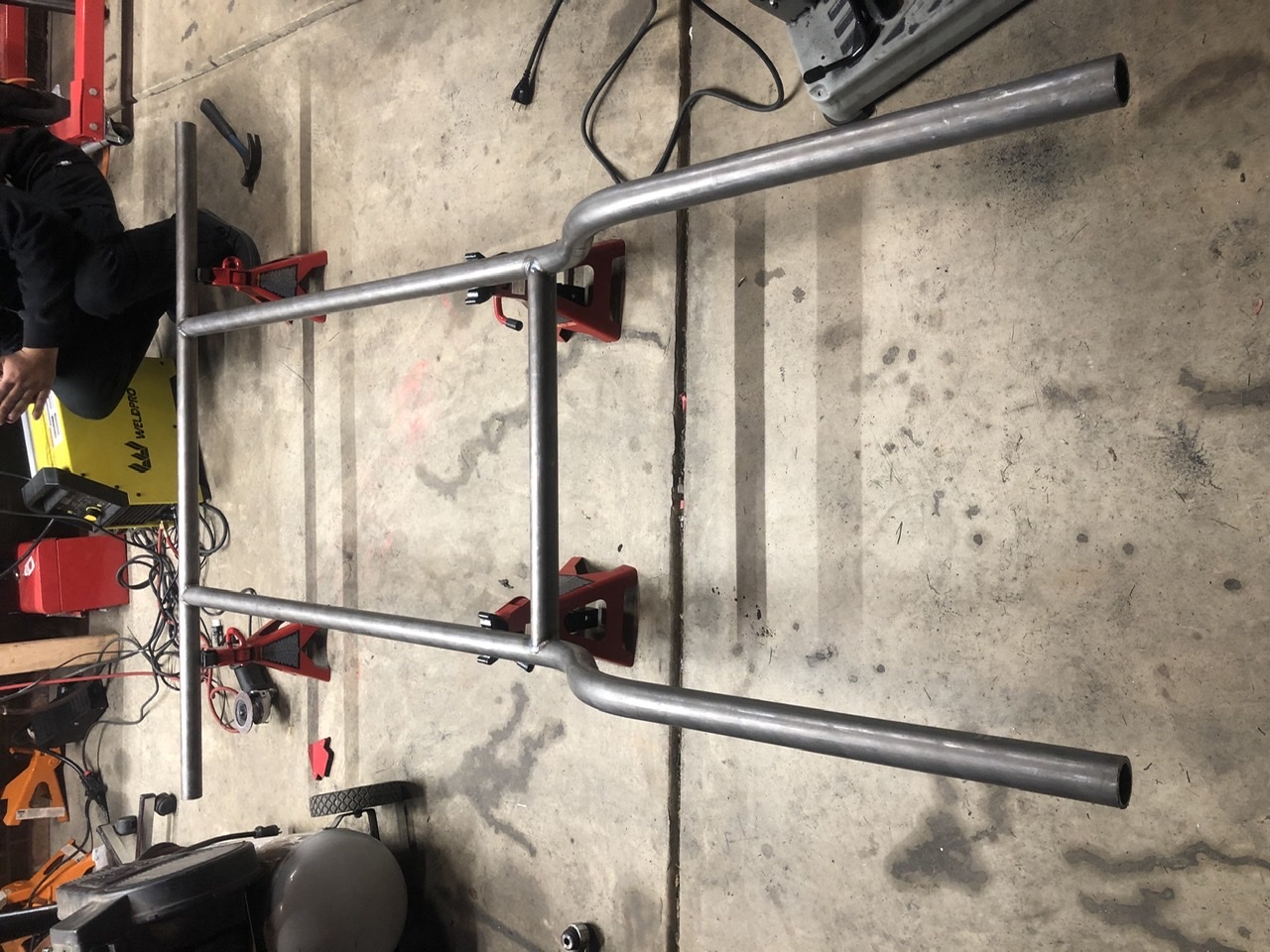

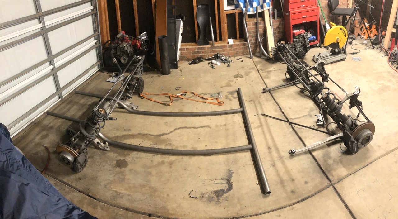

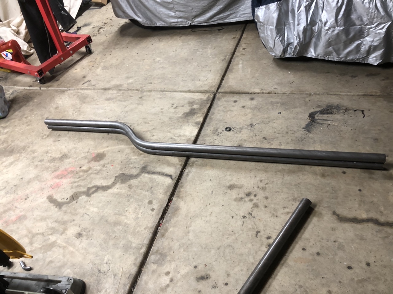

First step is the main frame rails. i bent these up and took way too long but they are within a 64th of an inch of each other and are dead flat.

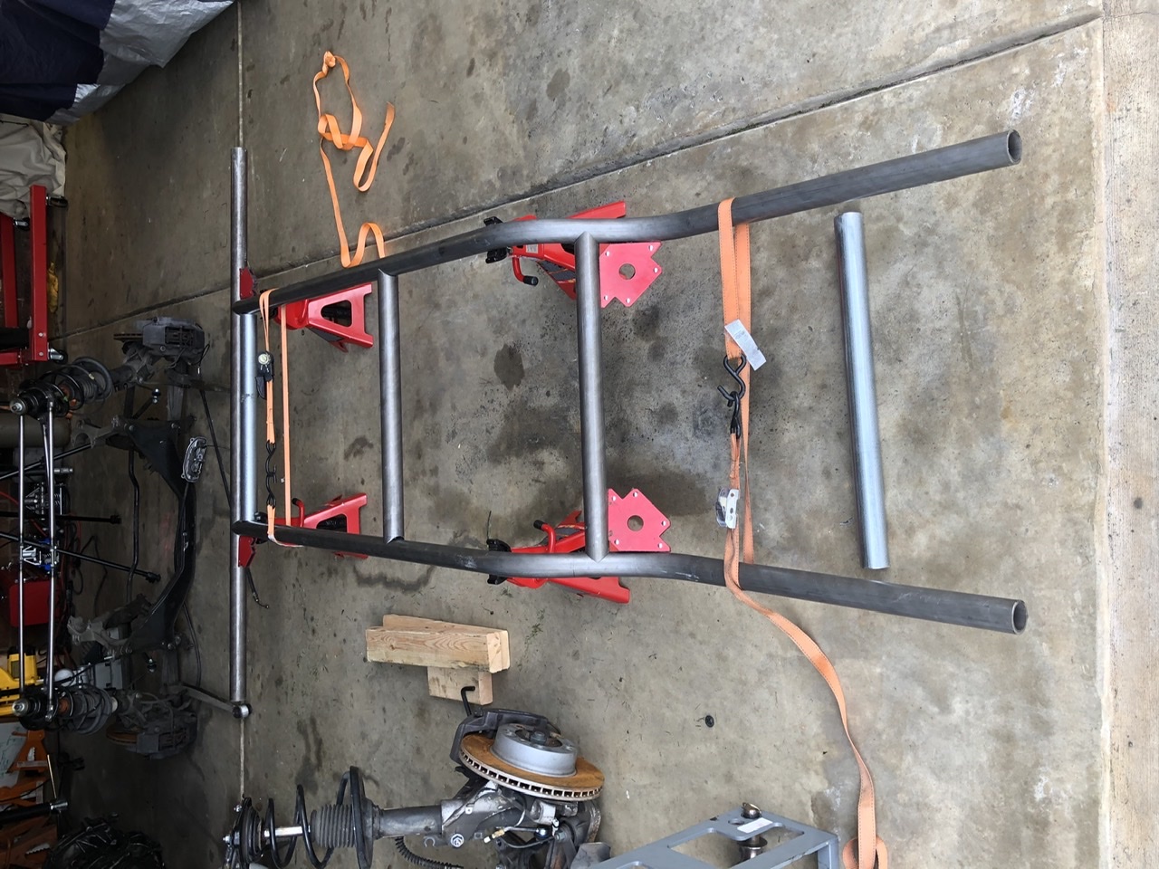

Next I needed to mock it up to find my width which is 22” inside to inside. I also wanted to see what it was gonna look like

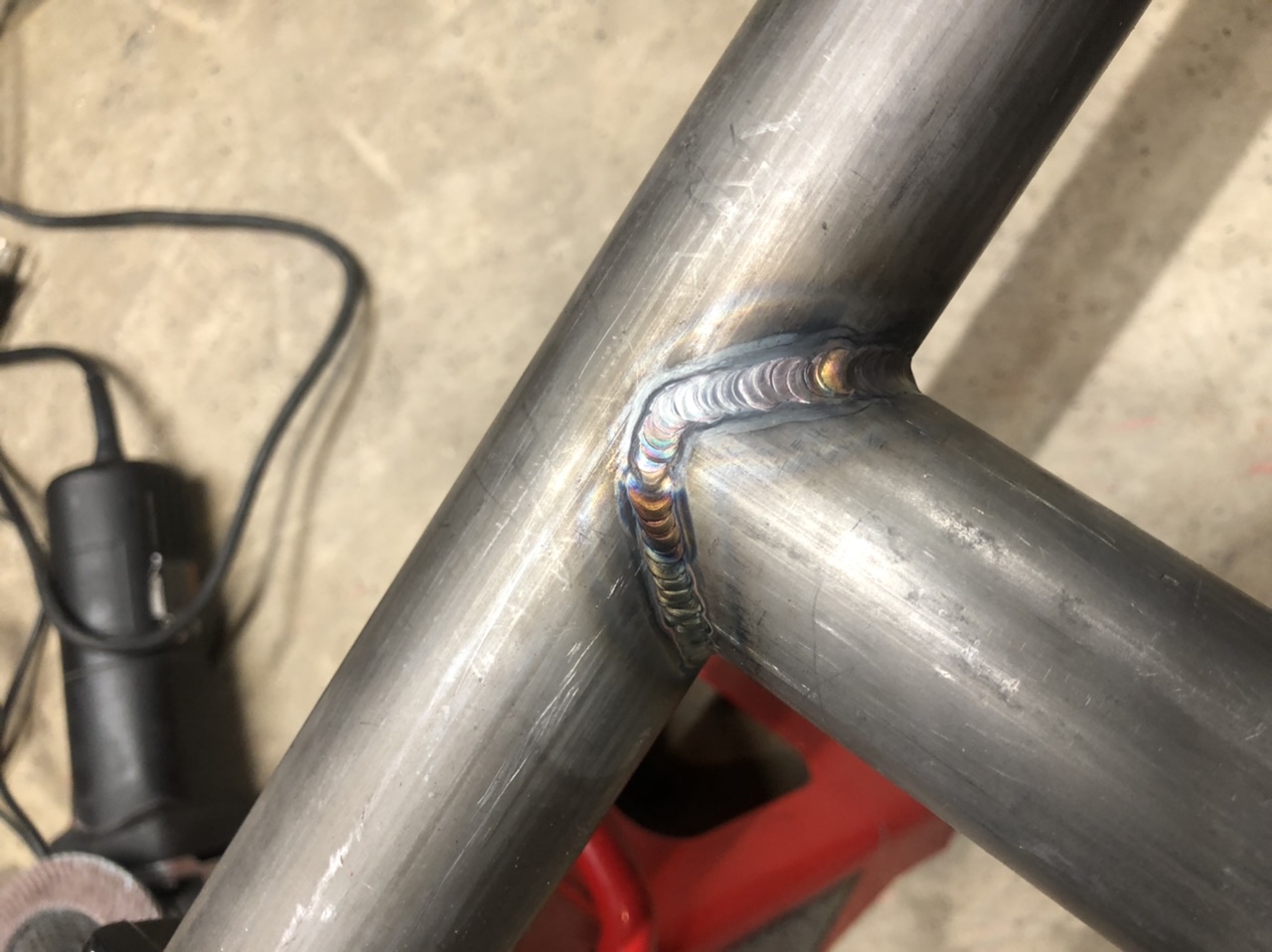

Began welding the main bit of the chassis together. Fairly decent welds, im still getting used to the hand controls instead of a pedal to make it more simple to weld while on the floor.
Damn pictures keep rotating, i even turn them in my phone but no luck.

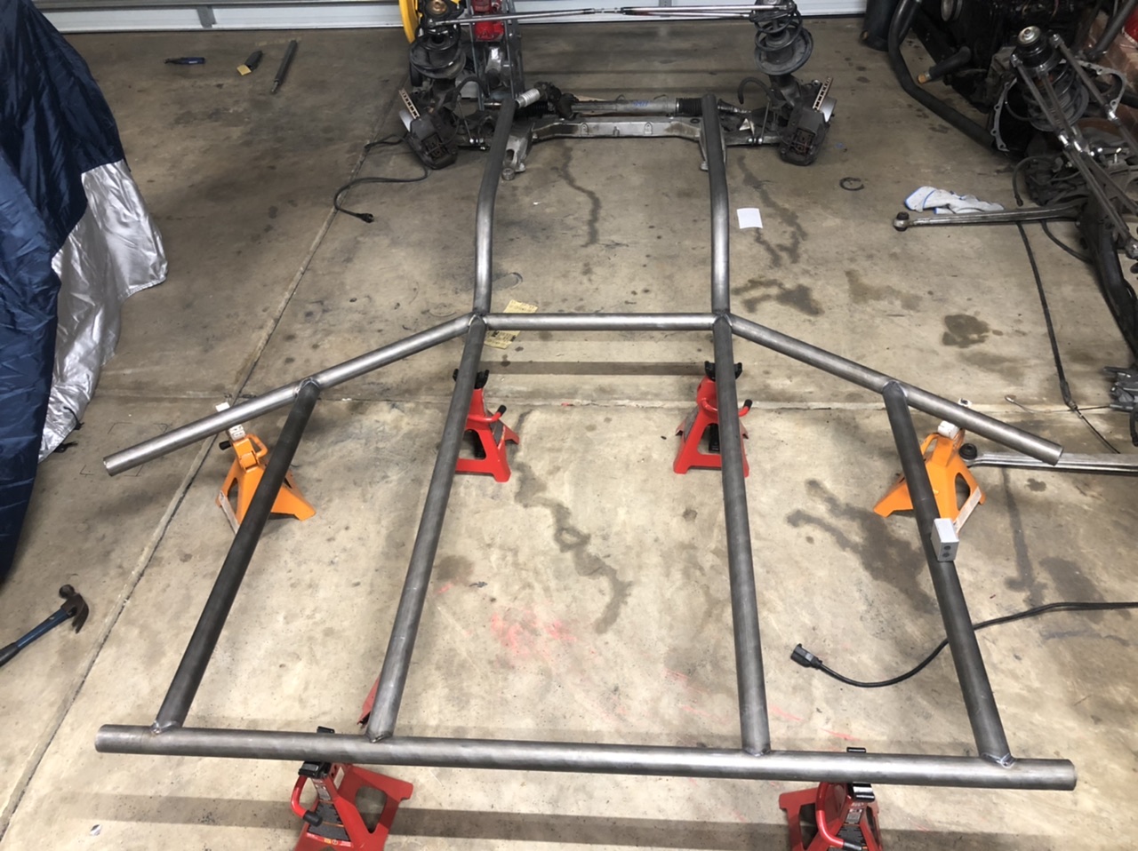

Spent the day adding in the wings of the chassis under where the driver and passenger(?) sits and honing in my tube bender. Turns out my bending die is advertised as a 7” radius but in reality its an 8.125” radius (which made me waste some good metal to find out). More on what i was bending tomorrow when im done. Attached Image

Looks great so far.
Have you measured the floor jacks to ensure same height or not grossly off?

QUOTE(Mueller @ Apr 7 2020, 06:46 AM) *
Looks great so far.
Yep i welded them in place to ensure the same height and to dissuade me from using them on something else. Also made them level because without much weight on them they dont sit flat.

QUOTE(tazz9924 @ Apr 7 2020, 07:59 PM) *
Looks great so far.
the floor is flat too ?
garage floors are not exactly a surface plate.
looks are deceiving.

Flat and straight enough is flat and straight enough for a home build (IMG:style_emoticons/default/smile.gif) I'm sure he can build enough adjustability into the mounts to correct any twist in the chassis.

QUOTE(Andyrew @ Apr 7 2020, 05:47 PM) *
Correct however i regularly check measurements and after a good amount of welding .35 degrees is all the twist so far. My garage floor is absolutely not flat but once all the welding is done im gonna shim the stands to level it out. Too bad a chassis table is so damn big and expensive.... next time i guess.
