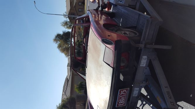

Here's Red when we got her home on the trailer and tucked away in the back yard for the moment.

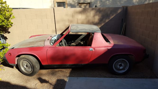

We got Red tucked away in the back yard so that we could run down to Tucson again the next day to get the green 71.
Once both cars were safely home, I started looking them over to see which one was going to work best, and what issues I might be facing.

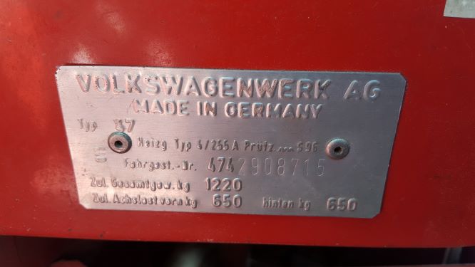

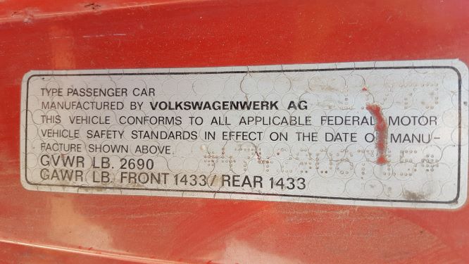

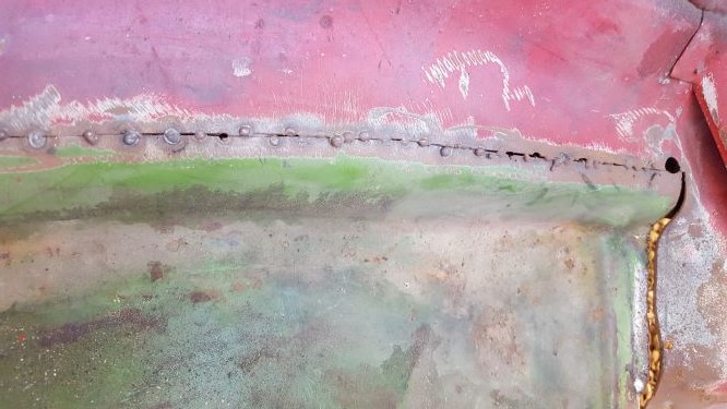

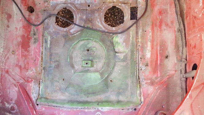

Red seems very solid, with almost no rust, and just a bad AC trunk floor repair to contend with. I documented the VIN, and entered it into my profile.

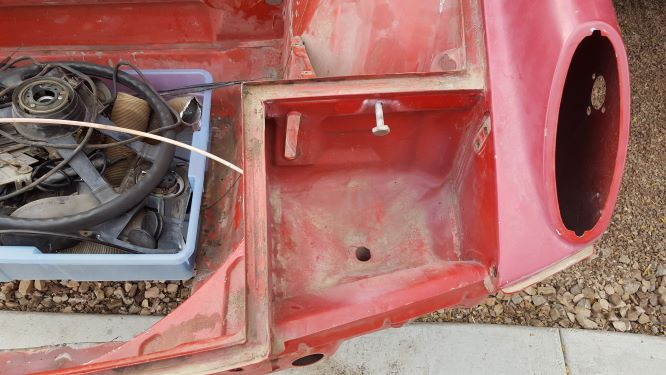

Here's the trunk floor "repair". They cut out the partially rusty front trunk floor from the green 71 and tacked it into Red!

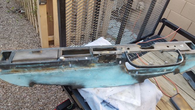

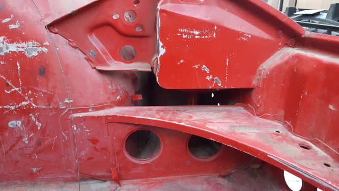

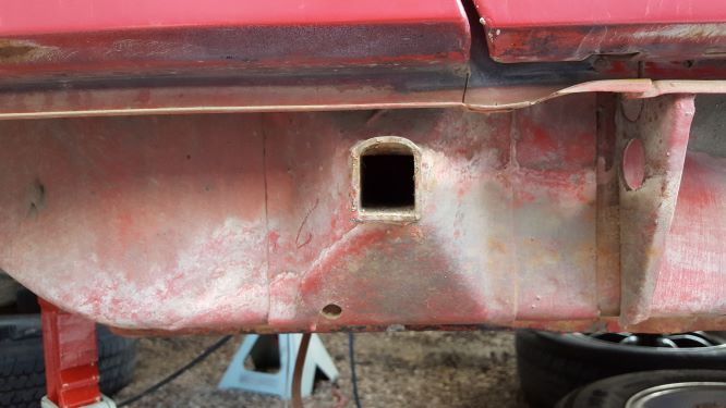

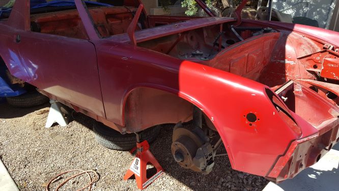

Once I got Red squared away in my working area, I started pulling the rest of the parts and pieces off her so that I can deal with any rust issues, repairs, etc. She looks really solid, thankfully!
Someone had repainted the inside of the front trunk lid white, and they got over spray all over the dash. A bit of extra work to correct it.

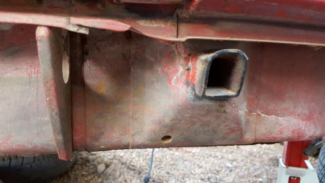

I pulled the outer rockers off, and despite five pounds of silt coming out, they still look amazingly rust free!

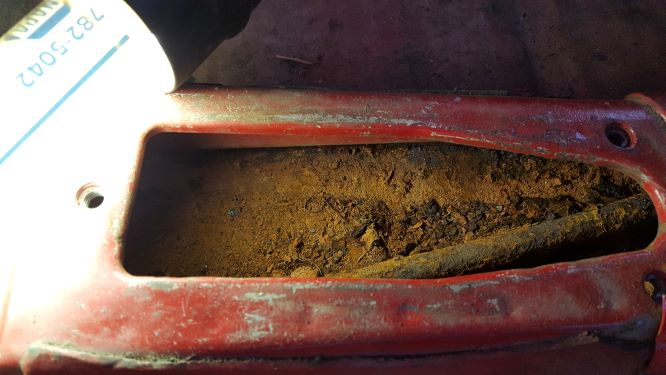

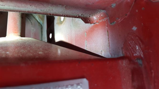

I managed to get the headlight assemblies all out, and focused on trying to clean up the tiny, hard to reach area under the headlight buckets. Not sure how you really get in there to clean, repair, etc. but it seems like even the Germans had a tough time getting paint back in there!

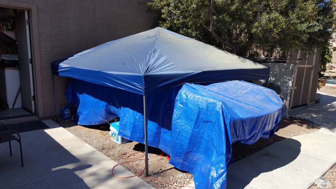

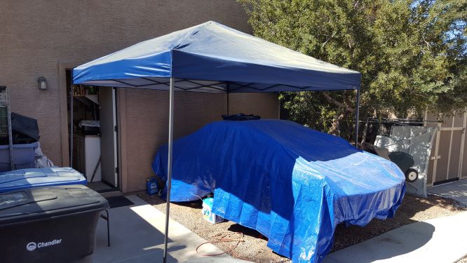

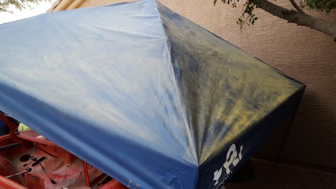

Since all my garage space is taken up already, I had to get creative and create my own temporary, outside garage. It seems to work, at least until I start doing some serious engine and trans work. I may have to kick my son's Miata out of its spot at some point.
Here's the overnight, storage setup.
And the I'm working now, so leave me alone unless I am bleeding, screaming, or lodged under the car in a life threatening manner.
The pollen coming of the tree is a bit much this time of year though.

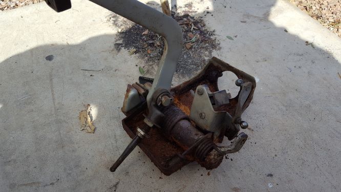

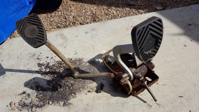

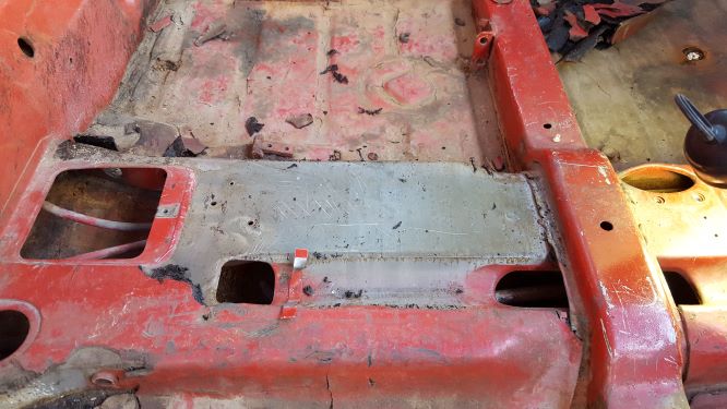

I did manage to get the pedal cluster out. Quite a bit of surface rust under there, but nothing seems to have gone very deep.
A bit of cleaning and sealing is due back here...

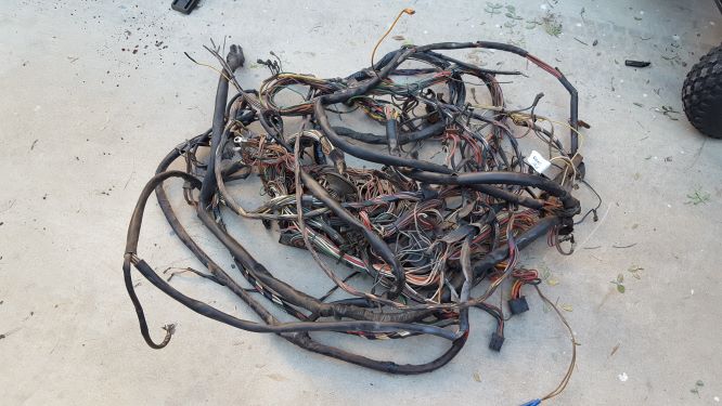

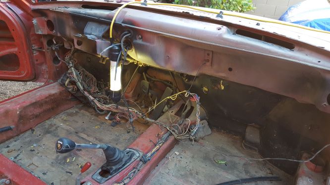

The wiring harness removal was way too much fun. Got 95% of it out intact in case its needed down the road, but it so old and crunchy I'm not sure it safe/worth using!

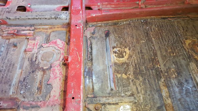

Does anybody have any amazing, creative ideas on how to clean out the tunnel area if you are not replacing any of the floor? Bit of a mess in there, and impossible to get to. Some kind of chimney sweep brush hooked to a drill???

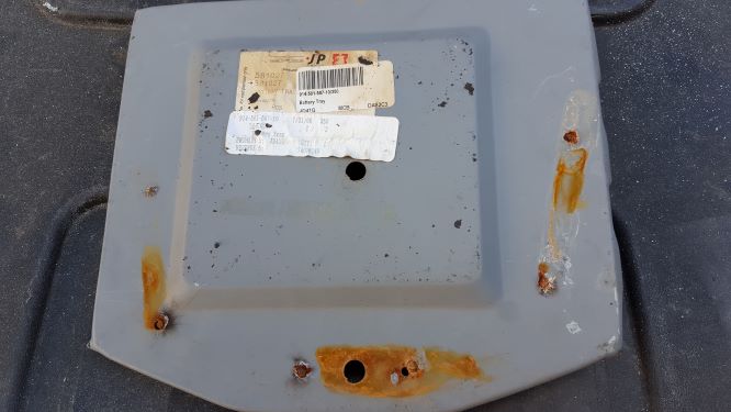

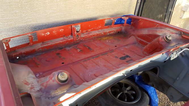

I also pulled the read trunk lid off so I could remove the wiring harness from the rear of the car.
I was checking out the battery tray, and it literally came off in my hand! Two very unsuccessful tack welds were not doing much to hold it in place. Looks like it may have been replaced around 2008 from the sticker still on the bottom.

QUOTE(mgarrison @ Feb 29 2020, 09:26 PM) *
I'd like to know the same. I did get mine pretty clean though by using a shop-vac with a small wand/nozzle (shift rod, etc. removed)... I'm thinking next I'll use a landscape leaf blower and blast it from the Shift rod hole (@ the engine compartment) forward, and from the rear access hole in the tunnel - blow towards the pedal cluster area. Then I was thinking I'd maybe attach a cloth/sponge (soaked in diluted phosphoric acid solution) to the end of a long flexible rod .. and work it up in there everywhere, to stop/kill surface rust. Let that dry then use 'internal frame rust paint' paint from Eastwoods to spray for future protection (it comes with a long flexible applicator hose/nozzle w/ a fan pattern). Heck I might even go with a spray-on wax product after that (I forget the name), which is made for such situations. That's my plan so far - anyone got a better solution, we're all ears !

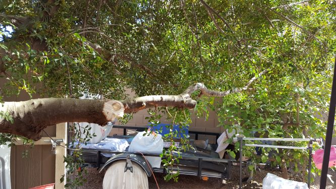

Didn't seem like I got much done today, but I'll take what progress I can get!
The first order of business was to eliminate the branch that I walked into three times yesterday!
Forehead was getting sore from that stupid, low hanging branch...

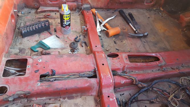

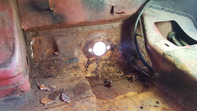

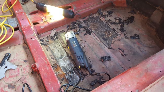

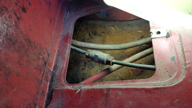

I managed to get the brake line and the fuel lines out of the tunnel with some help from above from my wife. That's not a 1 person job for sure! Once those were out, I thought I'd take a shot at the tar lining the floor. Need to say a big thanks to one of the posters here that showed using an oscillating tool on the tar - it jarred my addled brain enough to remember I had one of those from HF in my storage! It made fairly quick work of the tar, but does bog down a bit on the seam sealer. Floor looks like it is in pretty dang good shape except for a few dents from hitting things over the years - sure can't complain!
I had to bundle the car back up for the evening. Supposed to rain tomorrow...not supposed to happen this often in central AZ!
