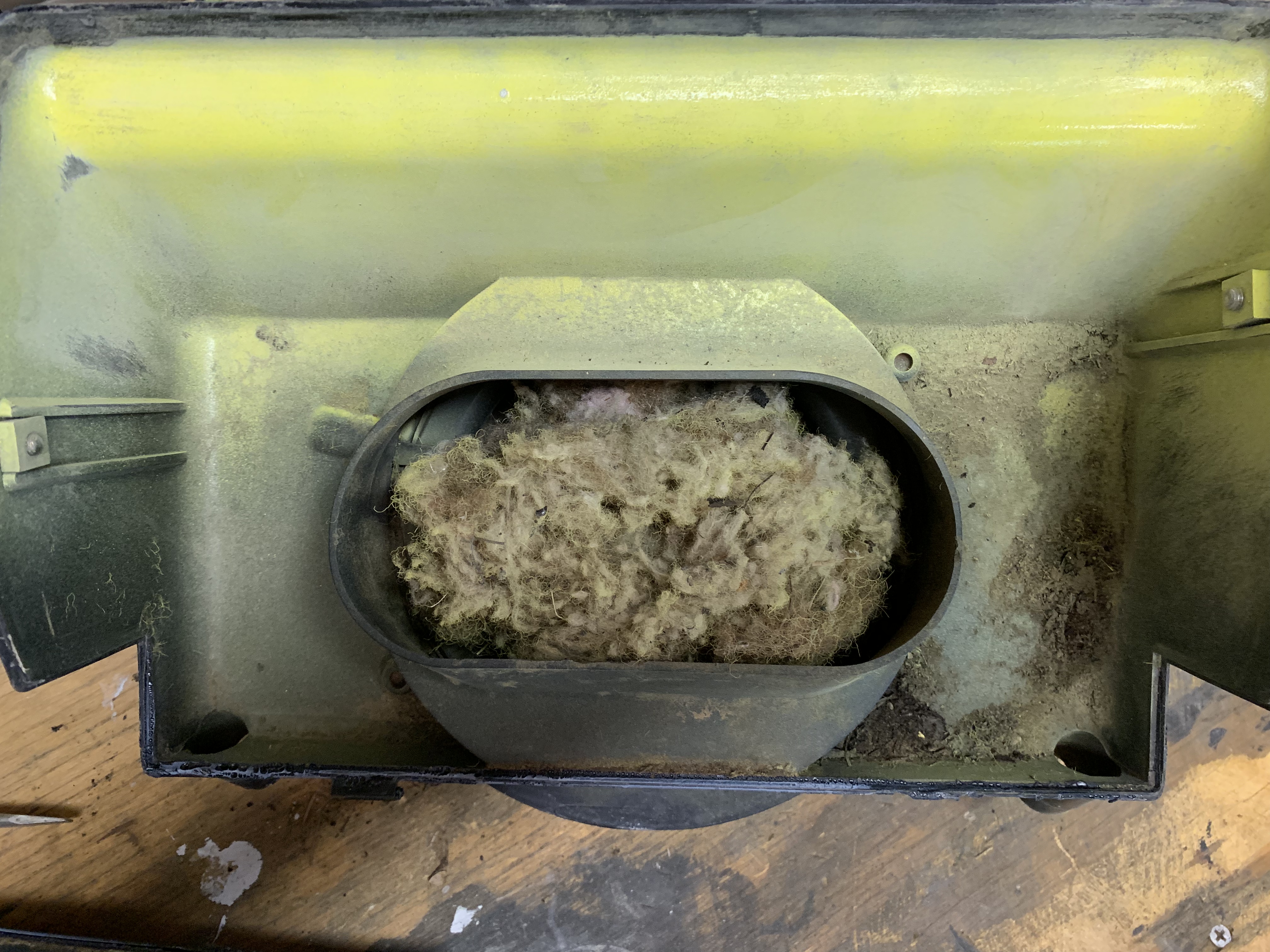

Mine was in the fresh air box. Not so fresh air!
