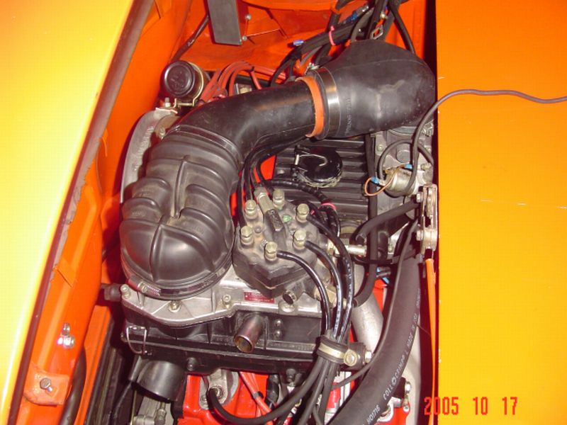

I have a conversion with a 2.7 running CIS. The you can rotate it no prob. Mine fit with minimal strife and modification. It is hours away from me at a body shop and the engine is out so cant take new pics, but if you search my conversion all the pics are there.

Ya, I tried searching as well. Did the conversion in 2005. Had good pics and notes. Cant find it. Tried to use google as well...found lots of my transmission propaganda, but not my car. If you can find my threads from about 2004-2007 you will see good pics and info on what I did and fought with. I took out the rain tray and cut the engine bat release cable and tube out and make it pin down type. This gave me plenty of room. You unscrew the pressure manifold and simply rotate it and screw it back in. IIRC, 3 screws so can actually rotate less than 180, or more. I moved mine sideways, if I am not mistaken. Pics on home computer.
Fuel pump plumbing is different. Need the fuel pump, very high pressure. I replaced all my hoses with clear, new hoses for like $12 from NAPA. I did find the thread mentioning that. Boil water and push on to nipples, hard (man, that reads wrong).

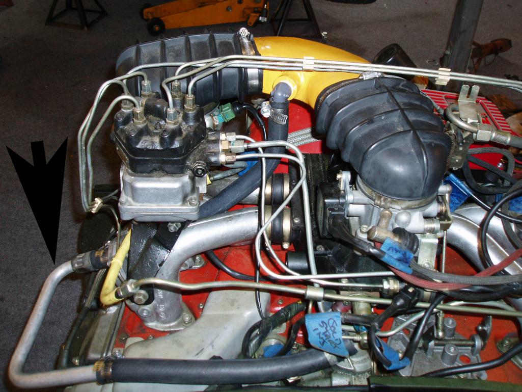

one way to do it...
http://www.914world.com/bbs2/index.php?act...ngine&st=20

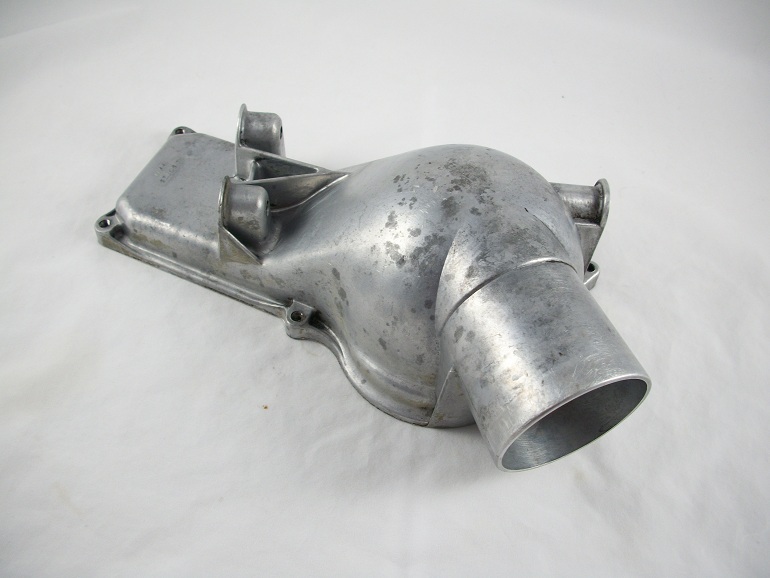

Jeff Tucker wrote;
QUOTE
No cutting required. I made a custom intake using an early Volvo 242 intake base and fabricated an intake elbow. Wiring was not complex you just need to focus. We removed the fuse panel. Added a fuel pump relay and a tach wire from the back. I put the computer under the passenger seat and added a sensor bung on 1 58" headers.

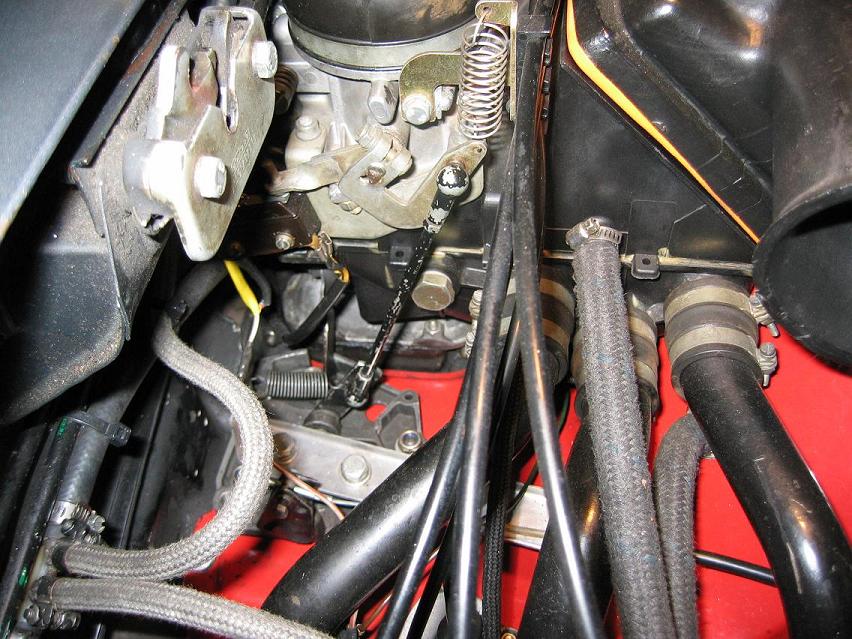

http://www.914world.com/bbs2/index.php?sho...32819&st=20
QUOTE
I had the engine going in and realized that my engine lid release mechanism was crushing my air boot and FI distributor. I had to lower the engine and then I 'savaged' the release off with some vice grips and a 4" angle grinder chop wheel. I need to put the front tin in and the tranny now.
