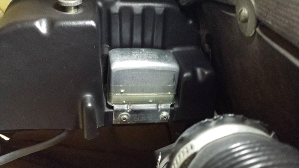

Here's a pic of the half height, transistorized Bosch regulator installed in my car. Fit was no issue.

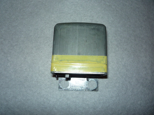

I used this one, and it fits perfect.
Just need the larger washers and you're all set....
