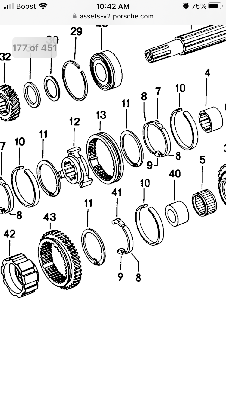

mgphoto
Has anyone on this board ever down shifted from 3000 rpm in second gear to first, and had their tranny survive. No need to try.
mgphoto
Please observe parts 41, 8 and 9. Syncro only on one side, up shift only.

Jack Standz
QUOTE(mgphoto @ Jan 22 2026, 01:46 AM) *
Click to view attachment
Just saying.
Actually, those are the brake bands and stops/anchor block/thrust block. The "syncros" (synchronizer rings) are actually #10.
And yes, only one brake band on first gear (although, IIRC you can use parts from gears 2-5 to run two brake bands on first gear if you want to for some reason).
ctc911ctc
43 is $$$$$
Dr. Evil sold me one that was really good - I bought a core to raid for parts and it was the cleanest transmission of all of the ones I have!!!! Sometimes you get lucky.

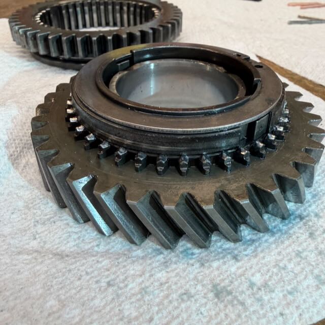

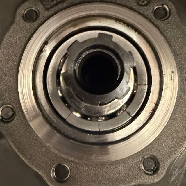

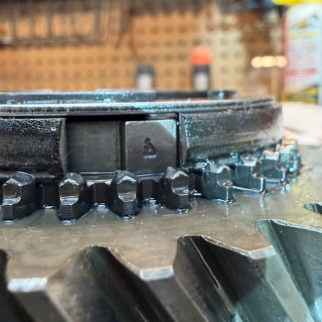

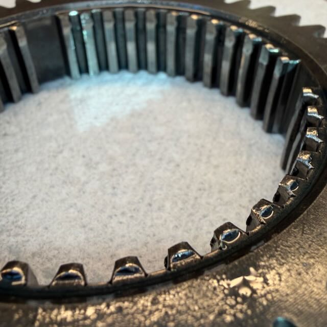

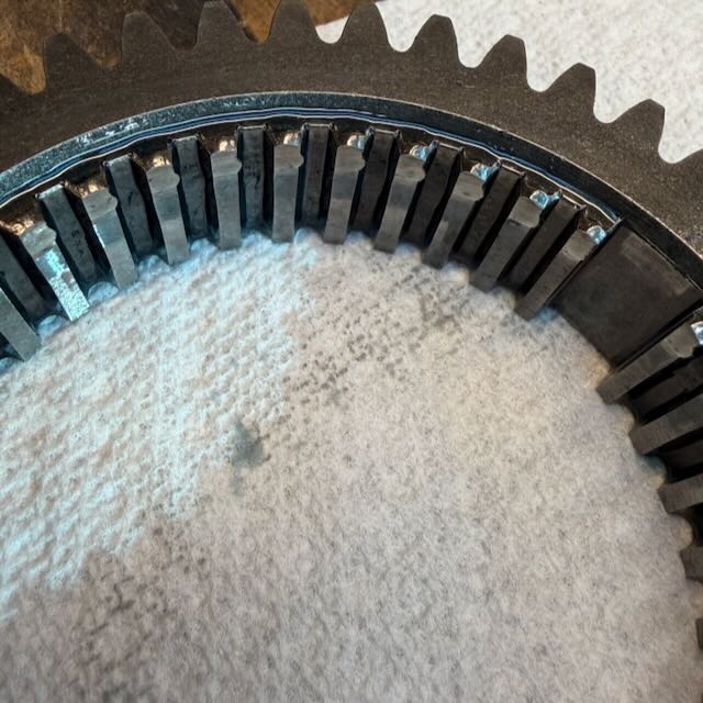

I finally found some time to tear into the transmission. The disassembly was pretty easy.
Dr. Evil's videos were worth every penny, even though I am not doing a full rebuild. It really helped me understand what goes on in that box when I shift gears and was a confidence booster for taking it apart.
There was not much metal on the plug magnets. Some, but I was expecting a golfball of metal fuzz. It was tricky to not have the middle section of the transmission come off with the end. That took some careful tapping.
The diagnosis and fix are clear - That dog don't bite, that's for sure (see pix). The slider teeth look like they have been smeared around. I'm certain I need new dog teeth, slider and synchro.
Now to get parts ...

If first gear is gone, second is usually close behind.

914werke
Sucker is toast

2nd gear takes a great deal of abuse - NOT the gear but the slider and DogTeeth
A good trick to save $$$ is to exchange the 2nd/3rd Slider with the 4th/5th slider.
The 4th/5th parts are not treated to as much abuse and are in good shape in near all cases,
Looking at your 1st Slider and DogTeeth pretty sure there are dogs barking from 1st to Second.

Today I separated the dog teeth and pressed in the new ones. It went really well.
Then I put some bright lights on the transmission to get the old gasket scraped off and saw something I wish I could unsee. The race of the bearing that sits under 1st gear is cracked in four places.
Maybe a full rebuild is going to happen sooner than I had hoped. Like maybe now.
Ugh ...
Ninja
Finding crap like that NOW, before it has trashed any shafts or the case means you could have a good core that just requires normal rebuild parts.
