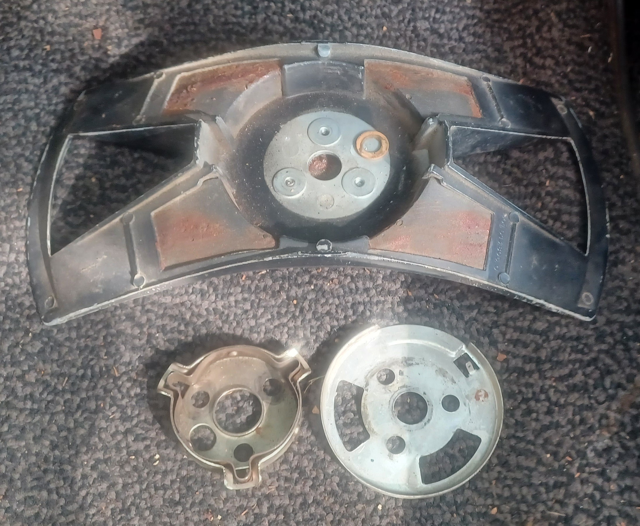

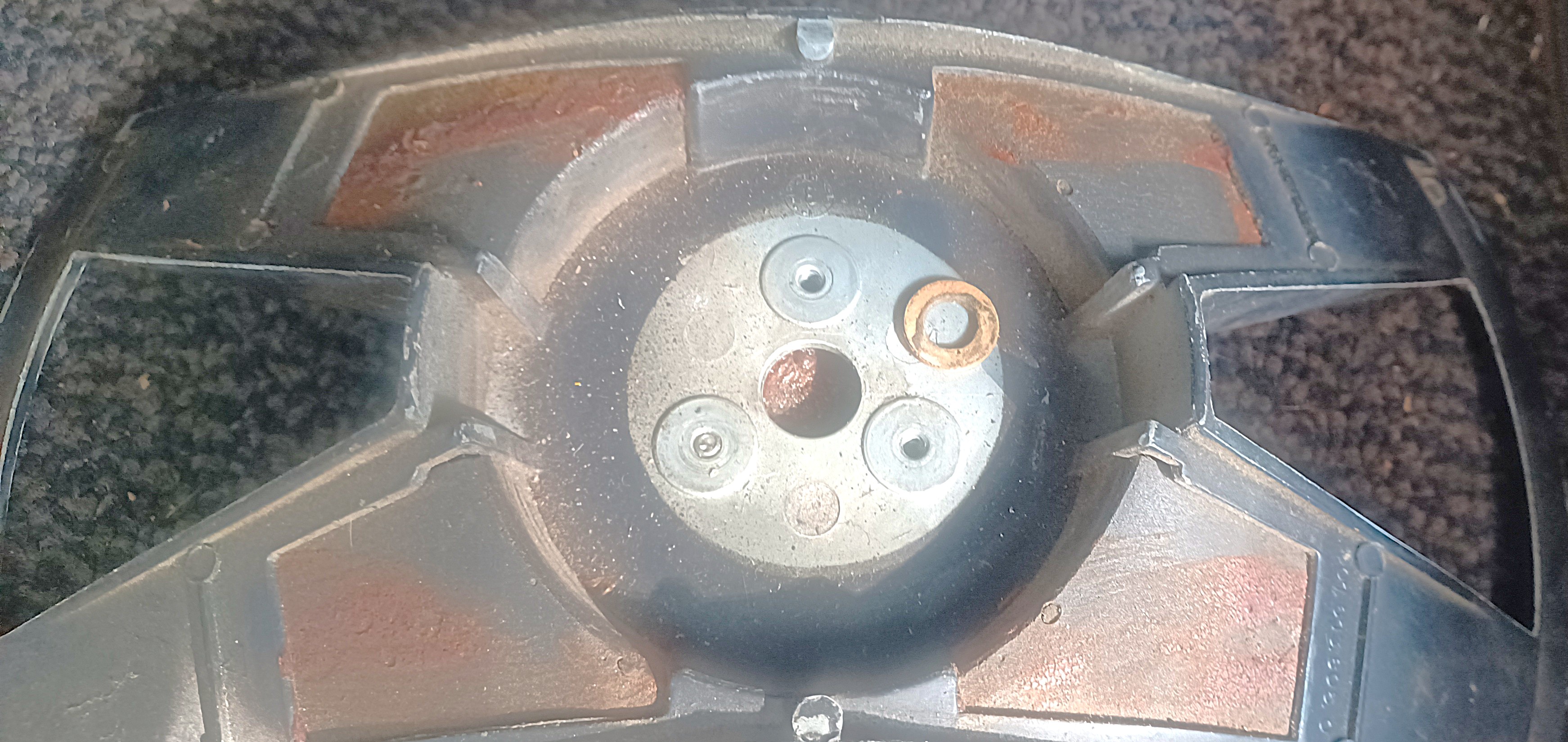

Pics of what I have as of now attached.
Q: Is the (fiber) washer in this pic one of the OEM screw insulators for the horn pad?
If anybody has close up pics of the horn pad screws and insulators both installed and apart, I'd really appreciate it.
Also need best practices for removing the broken screw in the horn pad.

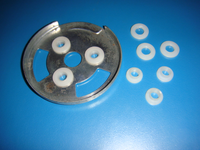

PCA7GGR
The pic show the proper placement of the flat and stepped washers and two metal hornpad pieces prior to screwing the assembly to the hornpad. The flat washers go between the two metal pieces. This prevents grounding the horn circuit - the circuit is grounded when the mounted hornpad is pushed on either side causing the horn to sound.
The plastic washers replaced the brown bakelite stock ones that disintegrate over time.
Hope this helps

QUOTE(914rrr @ Jul 9 2025, 11:13 AM) *
What is the size, thread pitch, length and head type for the horn pad screws?
Click to view attachment
Looking at those pics, I would start with a left-handed drill bit, just a bit smaller than the minor diameter of the screw.
